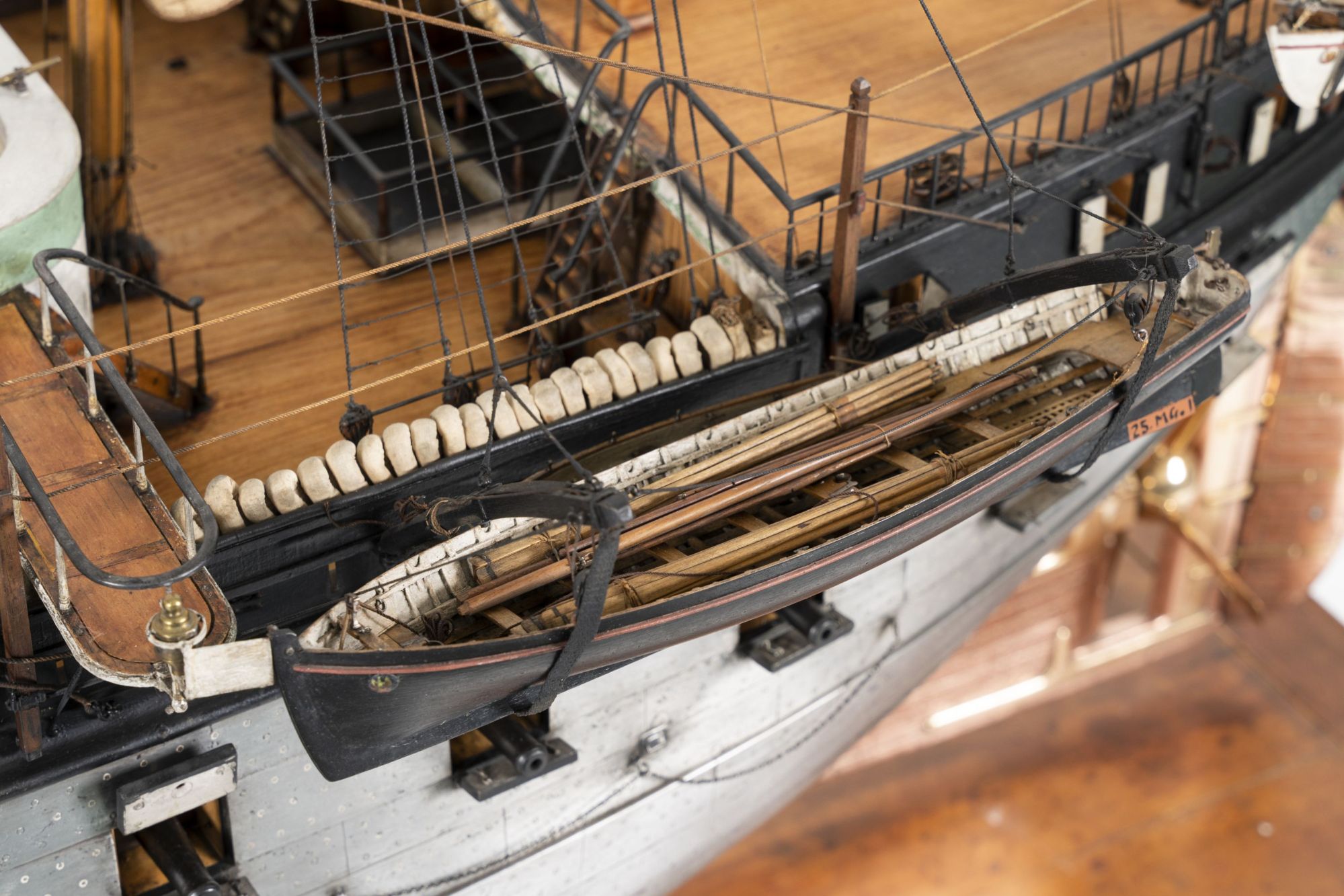

The French ships carried a lot of boats-- stowed on davits in a most innovative way !
Bretagne followed this pattern
noteworthy is that covers were fitted to some of the boats when slung in davits
this would also add a bit of variety to the model;
The boats duly had covers made ( as in previous post) and were installed to the davits
( with a dot of ( thinned ) white glue for initial high 'grab' , followed up with CA drops
and tuned to be level with the sheer-line and the inner boat
These boast were strapped up in real life, black boats had black straps--
these fine models( Soldeferino and Gloire ) ( Musee de Marine-
-which illustrates it well

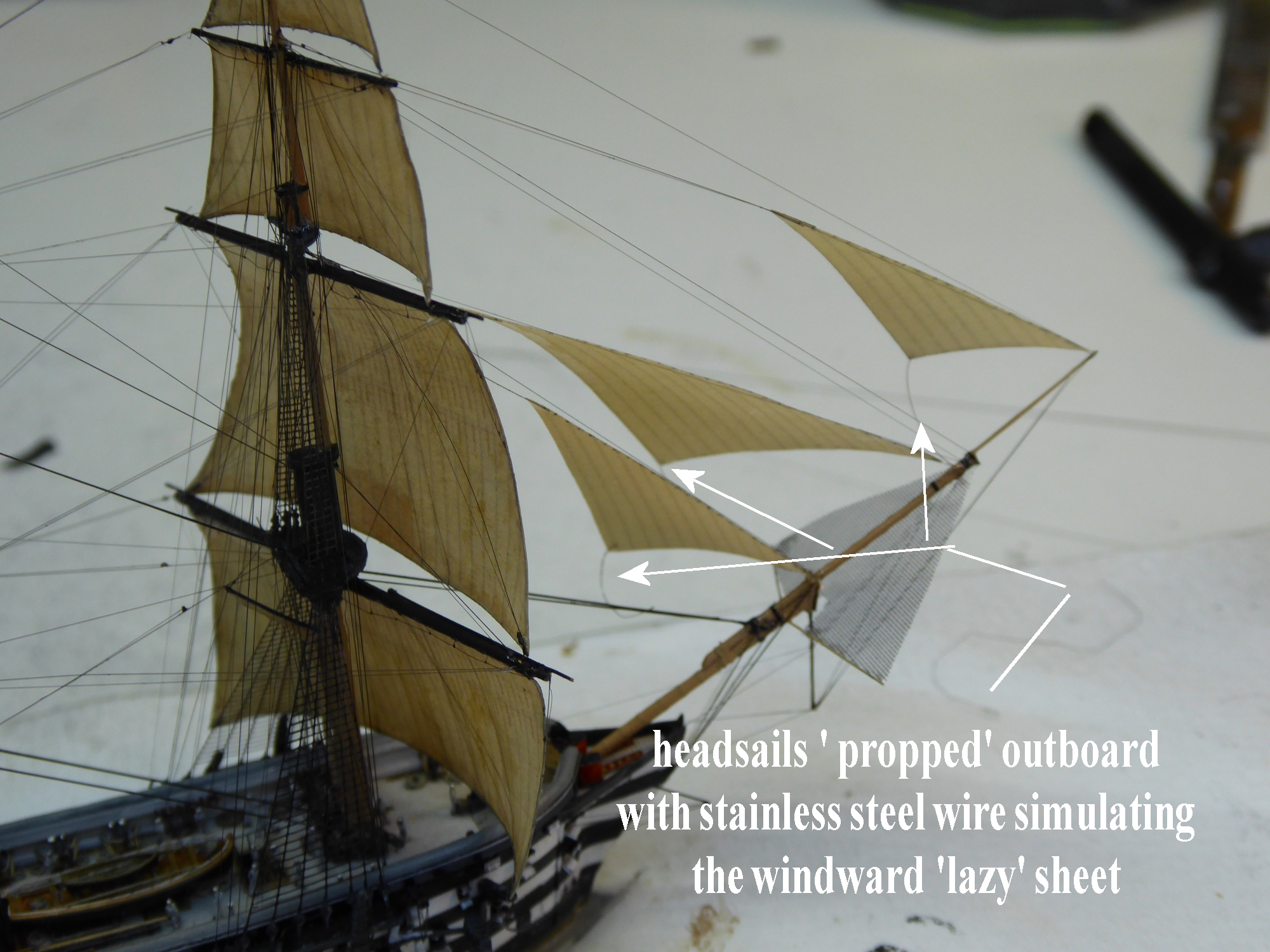

Headsails... I made fresh ones--that were lighter--
these were installed with the vessel perpendicular to its usual stance
( nerve wracking !-one slip and all masts would be gone!!)
This was done...
as they need to be not close-hauled ,
but rather as the ship is on a broad reach the headsails also need to be 'sheeted out '
To allow this to happen (and unload and preserve glue joints,)
the sails are ' propped out ' using thin stainless wire
to simulate the lazy not-in-use-windward sheet

Curious about those hammock rails being just plain gray color, is that a certainty? Not canvas dirty beige, but actually grey? Im sure your research is top notch, they just jump out quite a lot on the model, so I was curious and surprised of the way they appear on an otherwise coherent looking model.
PostPosted: Sun Dec 29, 2024 10:31 am
Posts: 5568
Ahoi Pascal ! :wave_1:
You are quite correct in that many of the sailing Navies used bleached white canvas on their hammock stow
as well as some preserved ships-- the Danish Jylland for example.
HOWEVER :wave_1:
I did do some research and agonised about it at length!
In the absence of colour photos...(!! ) we rely on paintings of that era.
and the conclusion I drew ( ha ha :smallsmile: ) was that the artists of the time....
would have rendered the hammock covers in white if they had been so;
- grey, indeed , being an incongruous colour
I am fortunate in owning a large colour large print of this painting,
a detail which is below--showing the covers to be grey.
I did seek corroboration on other French ships that overlapped the era of wooden walls....
herewith a selection;
the daguerreotype of Bretragne
oh... and a b/w imnage of Bretagne in her schoolship days; the canvas does not appear to be white;
( though could be beige--but never seen that)
and the preserved ship HMS Gannet ( though I have seen images with white canvas as well)
but this look greyish / grubby....
