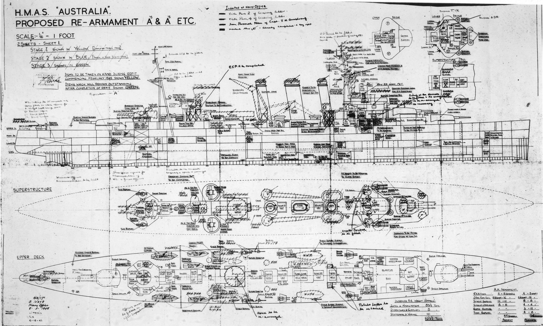

I also found the following drawings online for planned alterations as part of her late war refit, though I cannot recall which website I found them on, and will remove them if there are restrictions on their use elsewhere. There might be details here that you might find useful:

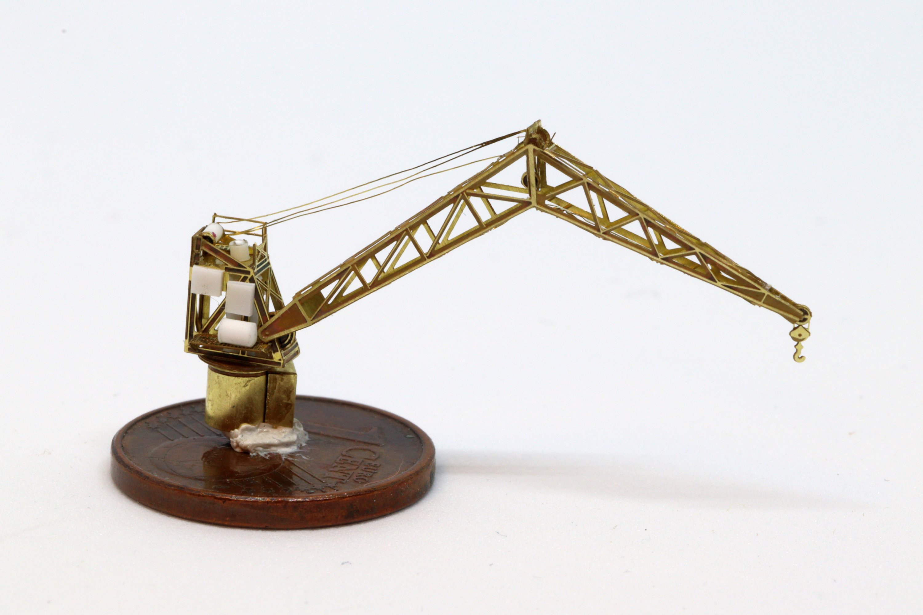

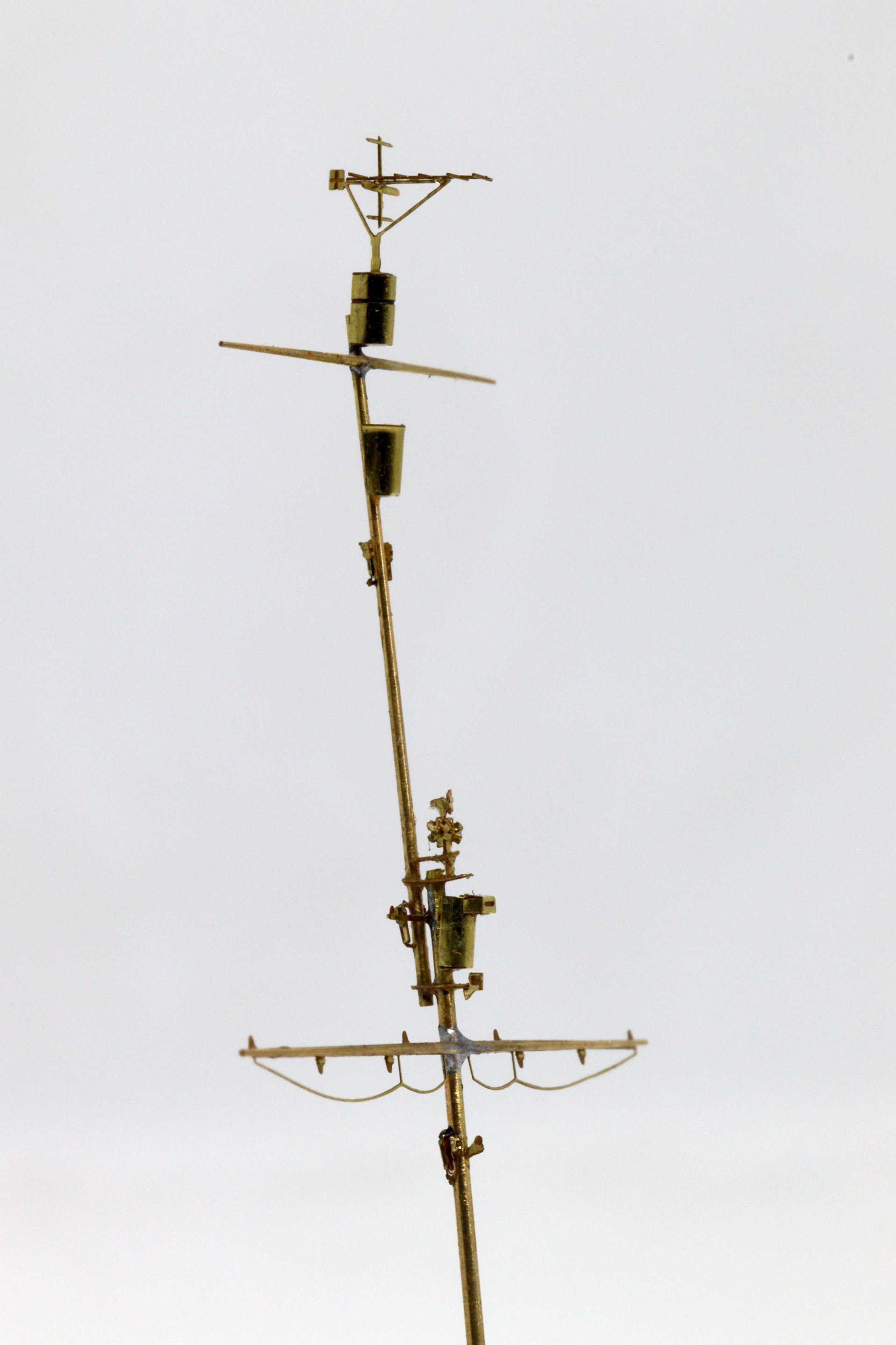

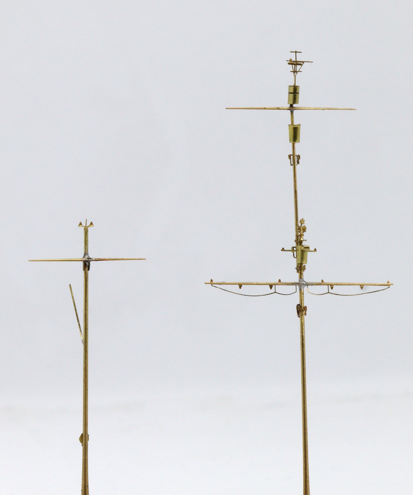

Aircraft cranes
The large cranes represented a very distinct feature of not only Kent class cruisers but of most major British pre-war warships. Originally, Kent class ships were equipped with a lighter version that was replaced later with a heavier crane along with introduction of heavier airplanes (Supermarine Seagull). Cranes deployed on different ships also differed in details. Out of the many depictions in 1/700 available on the market, none really appeared well-detailed and close enough to Australia�s cranes as can be seen on numerous photos.
Also the port and starboard cranes onboard Australia were not exactly the same. The main difference was the control platform that was placed outboard on each crane, plus there were other minor differences in the equipment (�boxes�) on each one. Catapult

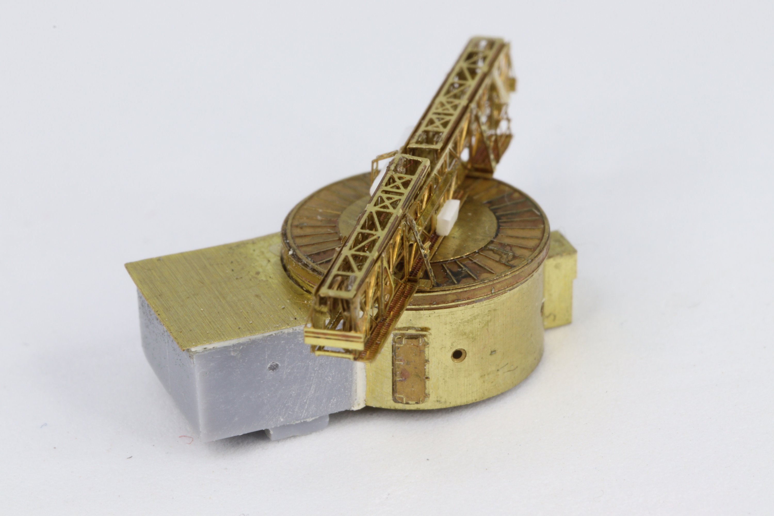

Similarly to aircraft cranes, the original lighter version of the catapult had to be adjusted to the much heavier Supermarine Walrus airplane. The catapult represents the most complicated tiny sub-assembly of the model except of the main bridge. The catapult itself (without the base) consists of over 20 PE parts plus several pieces of plastic rods and sheets.
Please note that the "sunrays" seen on the catapult turntable are incorrect and have been removed later. Foremast
Another tricky part thanks to the numerous tiny details incl. crow�s nests, lights, weatherwanes and A290 radar. A result of � as usual - lenghty discussions with Brett Morrow I think we nailed it right.
Aircraft cranes

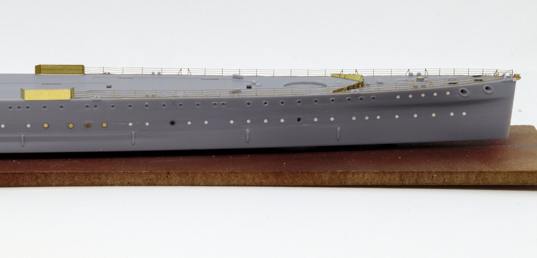

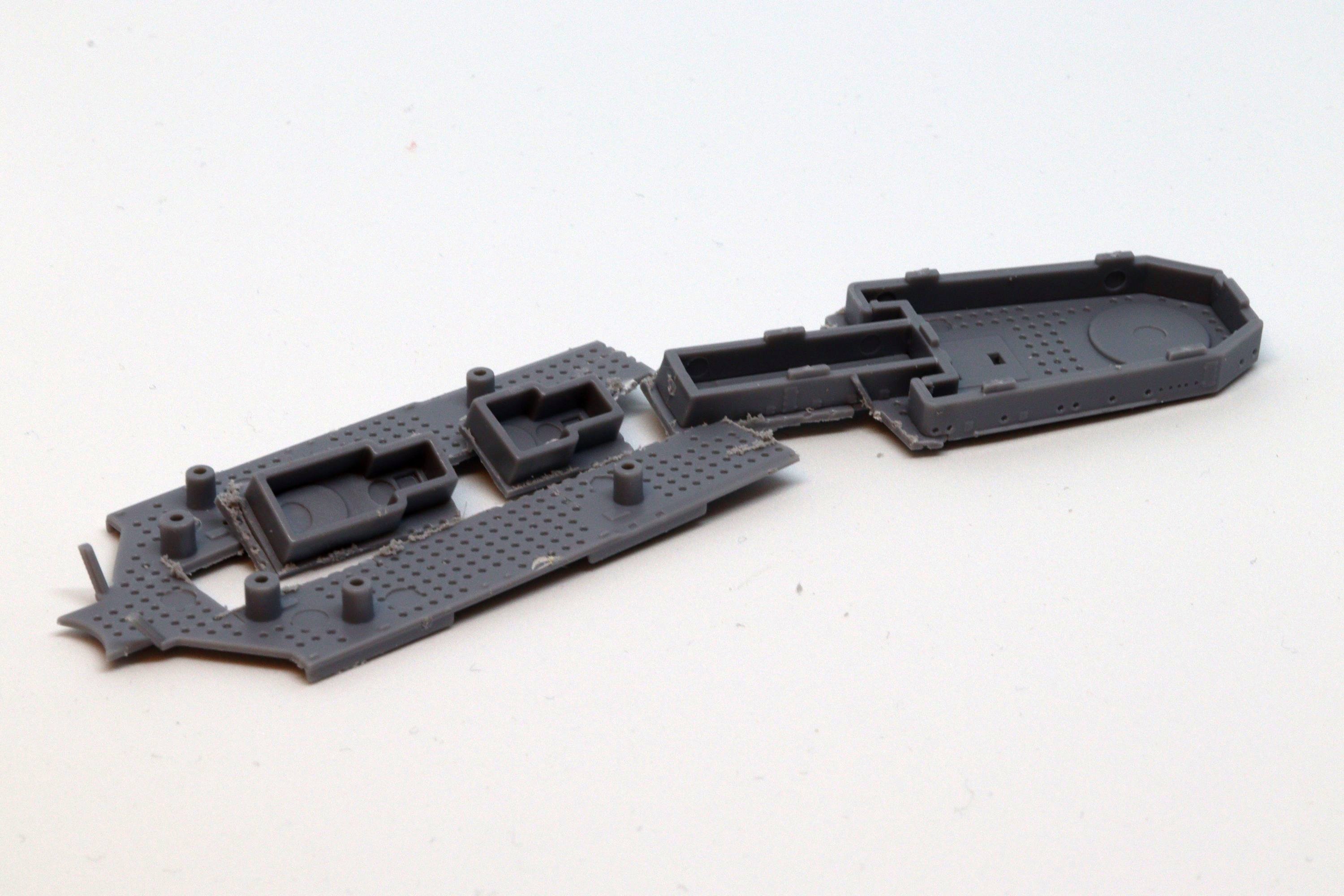

Adding some photos from works on the deck and the hull. One of the obvious differences between Kent and Australia was the AA deck, which was one level above the main deck in case of Kent, while Australia had her secondary armament placed on the main deck. So some surgery was needed to separate the funnel bases from the AA deck. Note the holes drilled into the forecastle deck as an aid for installing PE overlay so that CA glue could be added from the bottom in the process. Usually I�d wait with installing PE railings until most of the work on the deck and superstructure was done to keep it safe from accidental damage. In this case I had to test it at a sooner stage so that I could amend it for the final PE sheet. The bow detail shows the breasthook work in progress, still before the bottom part sculpted using acrylic putty was sanded to its correct shape. As mentioned earlier, the hull was originally prepared for portholes to be sealed with PE parts, but these did not turn out looking nicely to me. So I had to drill out all of the acrylic putty again in order to fit the plugs Simon printed for me. These were fixed with PVA glue to be able to realign them later if needed but they looked like very much in line at the first attempt. The carpet monster only got less then 10 of them thanks to using a masking tape to hold them - after the first two of them flew into oblivion while being removed from the sprue
Hull plating was done by spraying primer (Mr. Base White 1000). I did not dare to use masking tape over the very thin railings so I had to protect it using a piece of paper mostly held by hand while spraying so that not much was added to it�s thickness. The last photo shows the hull with hull plates in place as well as the PE overlay on the forecastle deck to add planking to the deck. Other details were added to the hull like chutes, booms, Byers anchors etc.
BTW the vertical exhaust covers just above the waterline turned out incorrect later for Australia, so they had to be removed. A bit tricky at that late stage, but if came out not too bad in the end.

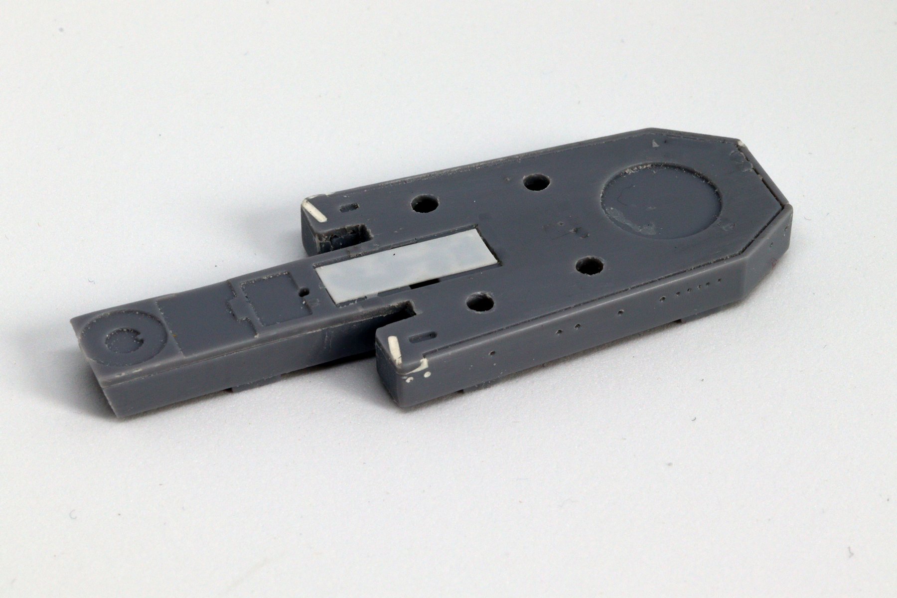

Here are some work-in-progress notes and photos before I get to show the completed build in less than 24 hours
. These do not cover every aspect and detail as there were too many, but I hope I�ve covered some interesting ones.
Main bridge
Photos show that Australia�s refitted bridge was different in multiple aspects from other class members after their pre-war refit and early-war modifications. That�s why I decided to design a completely new bridge from PE instead of modifying the Kent parts. This also allowed the bulwarks to be much thinner than Aoshima parts. The next time her bridge was more substantially modified was in early 1944. I decided not to cover parts for this late war fit as it was out of my scope of interest and it would take up additional space on the PE frets. Note that what you see on the WIP photos in this thread is not the final setup of the bridge on my model. It turned out at a later stage that there was a new gangway added to the port side of the compass bridge level which escaped my attention and had to be added. Also, there were tubs for Pom Pom directors at the ADO platform (the top level). Aft superstructure
This part turned out even trickier than the main bridge as it was not photographed as often, so we had to reconstruct the setup from fragments again. It was apparently quite different from Kent�s in the searchlight tower area, so a PE replacement came out as a useful method for me. And again, the detail of the 20mm platform aft of the searchlight tower proved inaccurate and had to be addressed later. Same about the catapult turntable which should have been flush.

Bridge equipment
I found out that there was almost nothing available on the market of the smaller pieces of equipment found on the compass bridge and the air defence officers platform (top level of main bridge), so I resorted to designing the following pieces myself using Fusion 3D software:
To be continued very soon
- Air Defence Officers Sight
- Searchlight Control Sight
- Pelorus
- Main compass
- Enemy Bearing Indicator
- Lookout Sight
