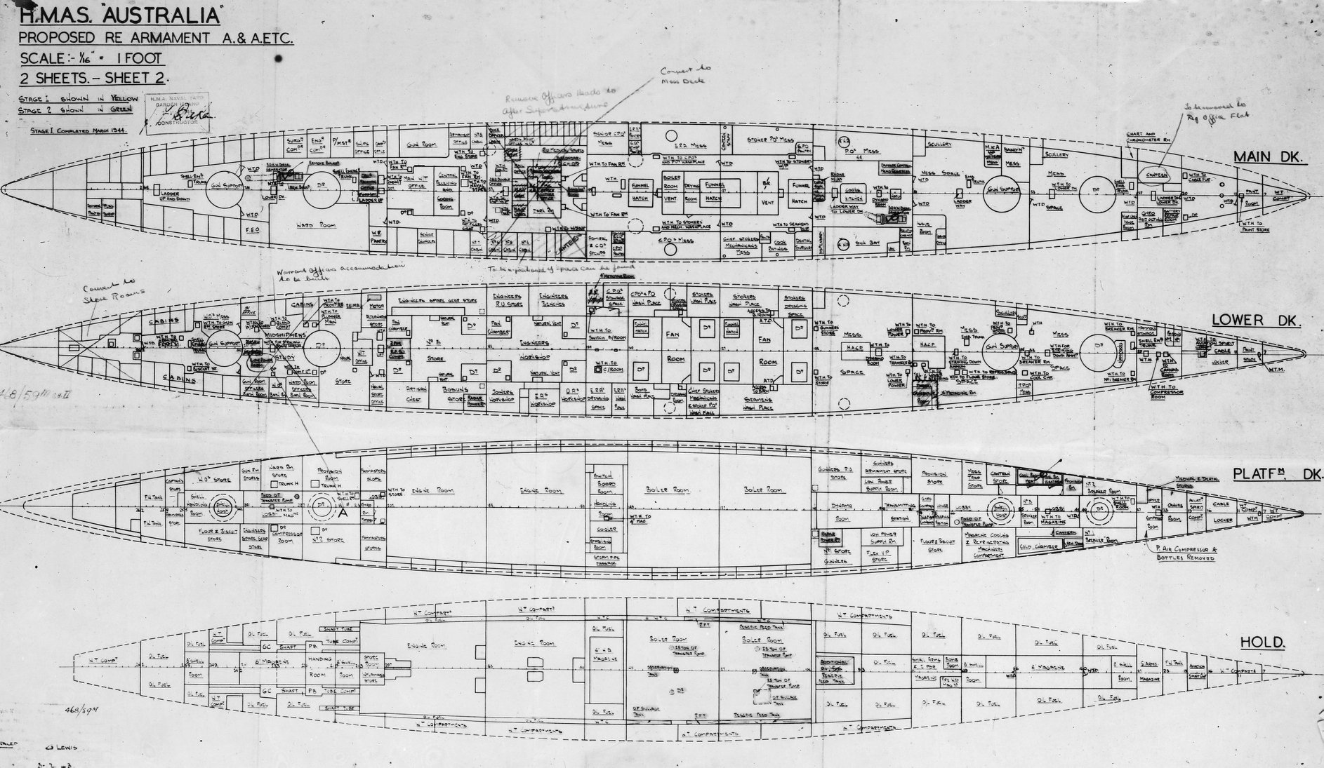

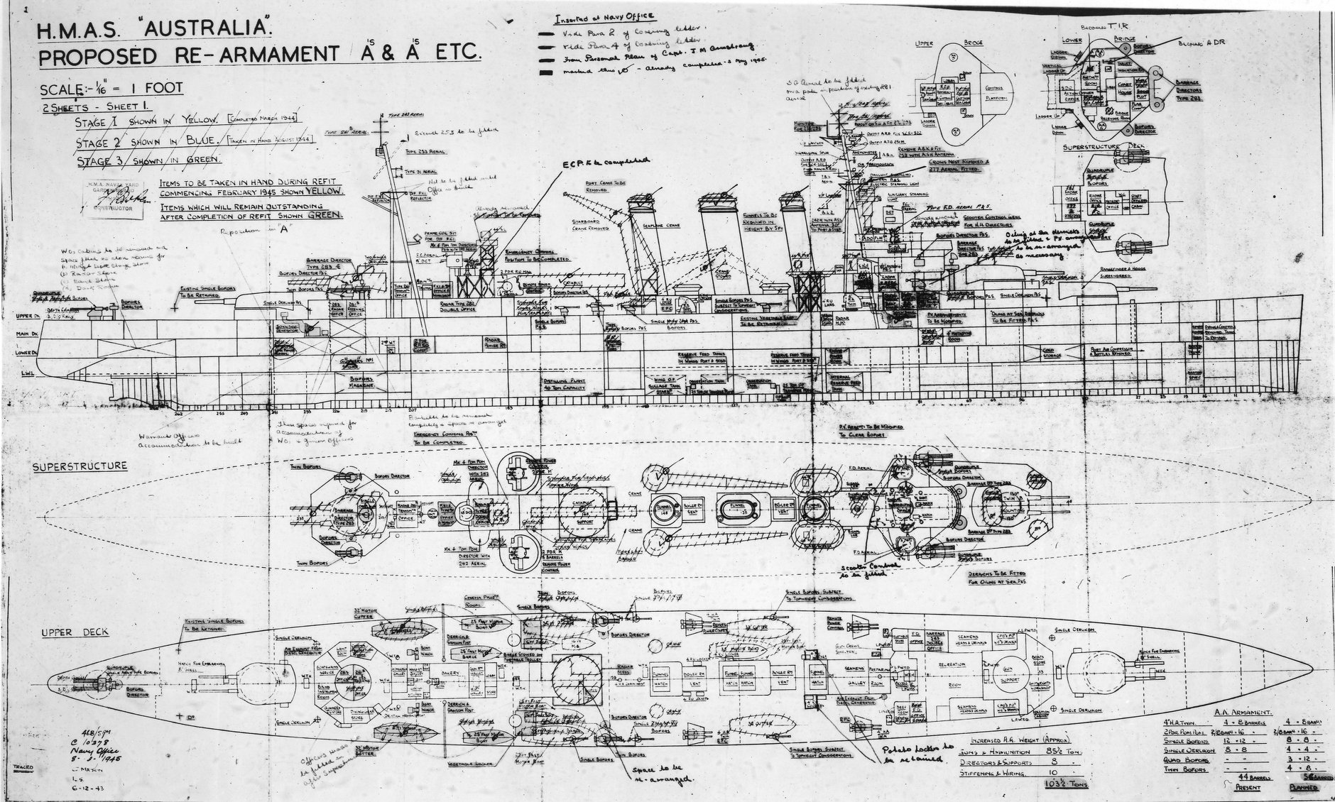

I also found the following drawings online for planned alterations as part of her late war refit, though I cannot recall which website I found them on, and will remove them if there are restrictions on their use elsewhere. There might be details here that you might find useful:
Anyhow, hope this helps!

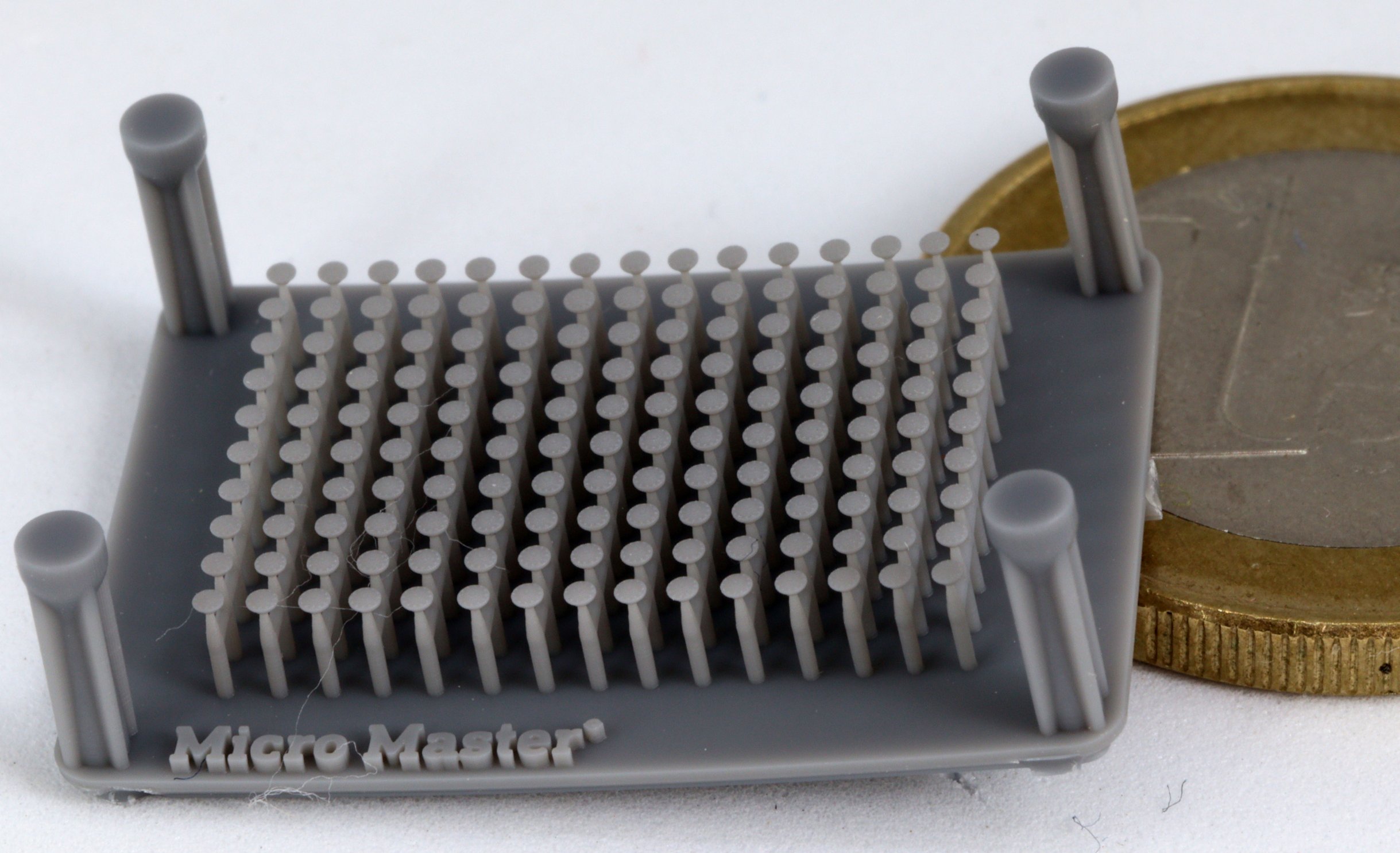

For those interested, I just posted a separate review of 1/700 3D printed figures and Walrus from MRY-SFW STORE that I bought in relation to this build.

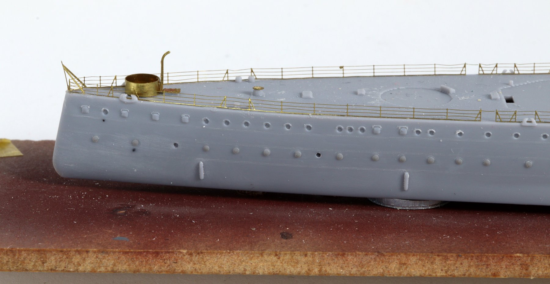

Adding some photos from works on the deck and the hull. One of the obvious differences between Kent and Australia was the AA deck, which was one level above the main deck in case of Kent, while Australia had her secondary armament placed on the main deck. So some surgery was needed to separate the funnel bases from the AA deck. Note the holes drilled into the forecastle deck as an aid for installing PE overlay so that CA glue could be added from the bottom in the process.
Usually I�d wait with installing PE railings until most of the work on the deck and superstructure was done to keep it safe from accidental damage. In this case I had to test it at a sooner stage so that I could amend it for the final PE sheet.
The bow detail shows the breasthook work in progress, still before the bottom part sculpted using acrylic putty was sanded to its correct shape.
As mentioned earlier, the hull was originally prepared for portholes to be sealed with PE parts, but these did not turn out looking nicely to me.
So I had to drill out all of the acrylic putty again in order to fit the plugs Simon printed for me. These were fixed with PVA glue to be able to realign them later if needed but they looked like very much in line at the first attempt. The carpet monster only got less then 10 of them thanks to using a masking tape to hold them - after the first two of them flew into oblivion while being removed from the sprue ;) .
Hull plating was done by spraying primer (Mr. Base White 1000). I did not dare to use masking tape over the very thin railings so I had to protect it using a piece of paper mostly held by hand while spraying so that not much was added to it�s thickness. The last photo shows the hull with hull plates in place as well as the PE overlay on the forecastle deck to add planking to the deck. Other details were added to the hull like chutes, booms, Byers anchors etc.
BTW the vertical exhaust covers just above the waterline turned out incorrect later for Australia, so they had to be removed. A bit tricky at that late stage, but if came out not too bad in the end.

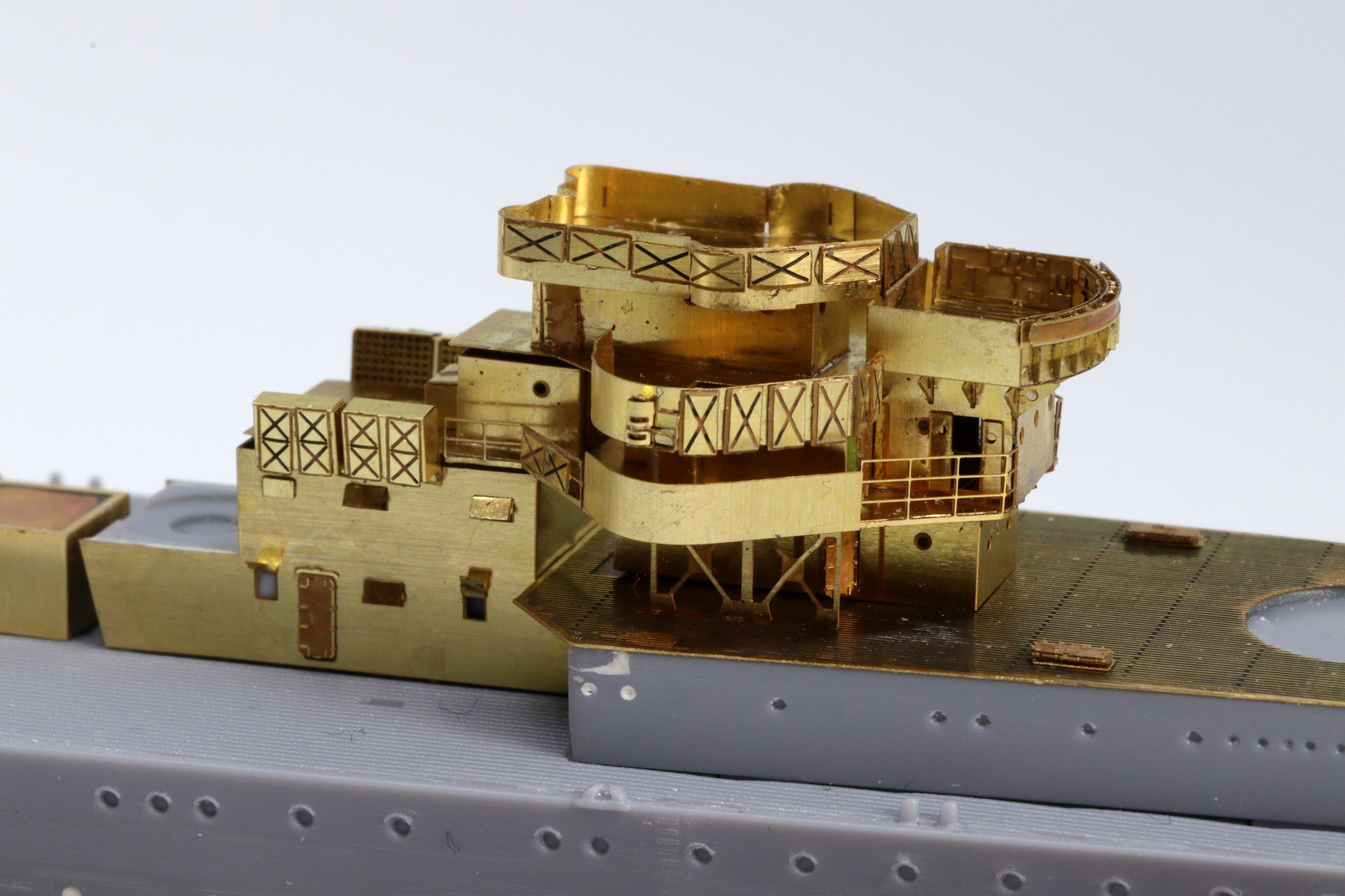

Here are some work-in-progress notes and photos before I get to show the completed build in less than 24 hours ;). These do not cover every aspect and detail as there were too many, but I hope I�ve covered some interesting ones.
Main bridge
Photos show that Australia�s refitted bridge was different in multiple aspects from other class members after their pre-war refit and early-war modifications. That�s why I decided to design a completely new bridge from PE instead of modifying the Kent parts. This also allowed the bulwarks to be much thinner than Aoshima parts.
The next time her bridge was more substantially modified was in early 1944. I decided not to cover parts for this late war fit as it was out of my scope of interest and it would take up additional space on the PE frets.
Note that what you see on the WIP photos in this thread is not the final setup of the bridge on my model. It turned out at a later stage that there was a new gangway added to the port side of the compass bridge level which escaped my attention and had to be added. Also, there were tubs for Pom Pom directors at the ADO platform (the top level).
Aft superstructure
This part turned out even trickier than the main bridge as it was not photographed as often, so we had to reconstruct the setup from fragments again. It was apparently quite different from Kent�s in the searchlight tower area, so a PE replacement came out as a useful method for me. And again, the detail of the 20mm platform aft of the searchlight tower proved inaccurate and had to be addressed later. Same about the catapult turntable which should have been flush.
