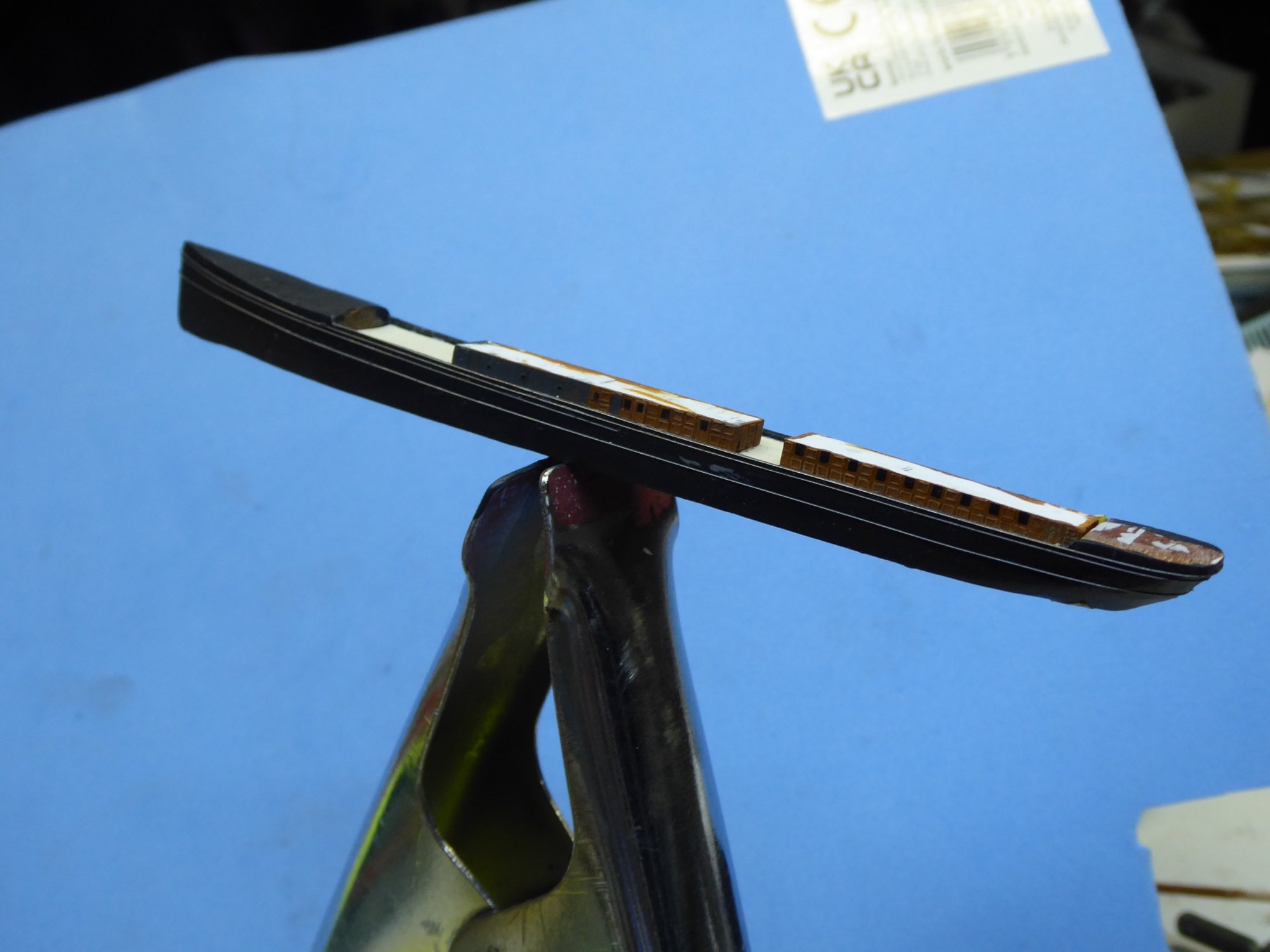

The superstructure blocks of this ship were almost entirely wood panelled-
-aside from the " dirty " engineering block
containing engineers doors for boiler room access
I tried to emulate this wood panelling.
One " could " of course have created relief etched PE --or indeed 3-D printed this entire structure
especially if producing a kit --- or more than one mode of this ship l....
I started by cutting suitable ladder-stock into short lengths to make squares--
- a tedious procedure to get good edges and square corners
These were attached onto the previously cut and shaped superstructure blocks and deck houses
to give the impression of panelling
here are some in progress
it was really quite difficult !!!
==> floating them onto thinned wet matt varnish,
and trying to keep keeping them all level and all evenly spaced
..........and there was rather a lot of it !

after a first coat of paint--
progress will continue
regards all Jim B :wave_1:
