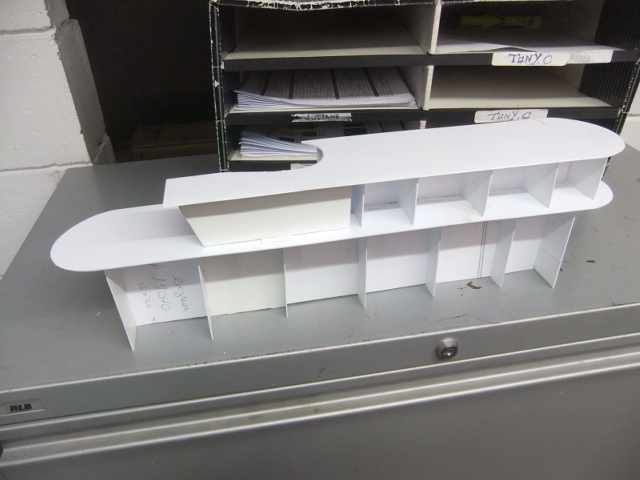

MAIN ISLAND STRUCTURE..
(SEPT 26th) Today I cover the structure with a thicker styrene sheet !

Re: HMCS MAGNIFICIENT in 1/48
Post by NavyShooter »
Nice progress! Are you planning on building the full ship, or are you doing a set of vignettes based on the images?

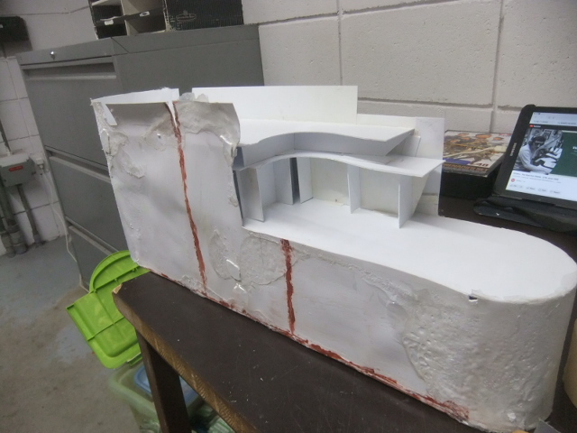

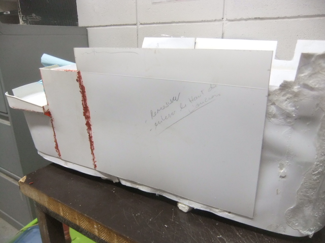

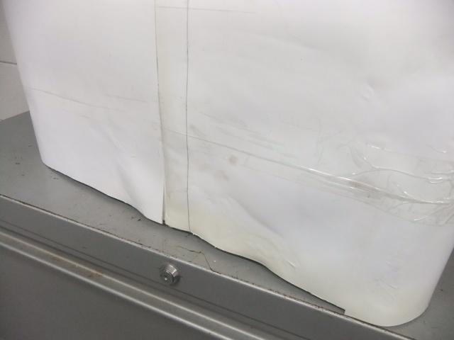

(MAY 27th) Today I realize the glued used last time as melt in the styrene , so I decided to remove it and stat applying a new styrene but this by section !

Admhawk
Posts: 950
Post by Admhawk »
I can't tell how thick the plastic is, but it looks like 0.020" or 20 thou. You need to use at least 40 thou, or even better, 60 thou.
I used 20 thou on a 1/96 ship model many years ago and it warped and fell apart because it was too thin.
Darren (Admiral Hawk)
FFG-7
Posts: 692
Post by FFG-7 »
I agree on the use of at least .040"(1mm) styrene as that is what I use on my 1/144 scale ships.

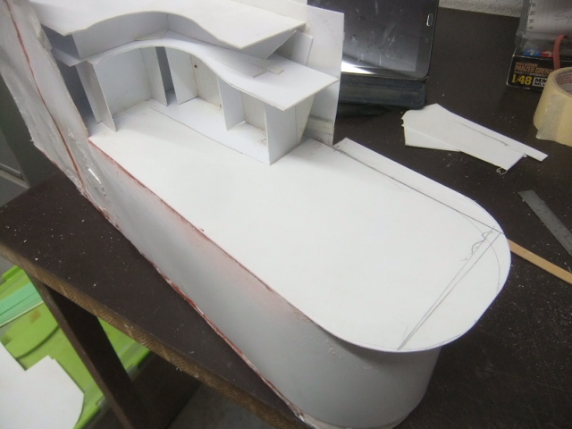

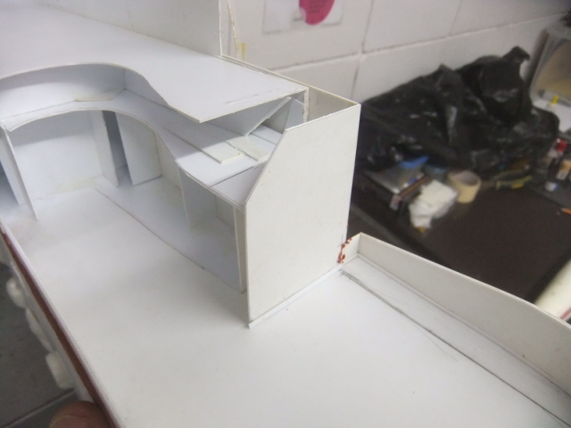

(MAY 30th) Today I cut out and glued the plateform !

(JUN 13th) Today I continue working on the plate form details !

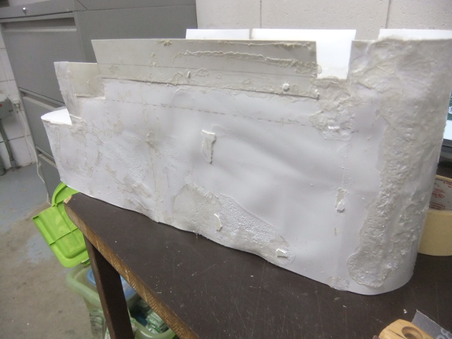

(JUL 01st ) Today I apply some expande foam in the island !

(JUL 11th ) Today I continue working on the main structure !

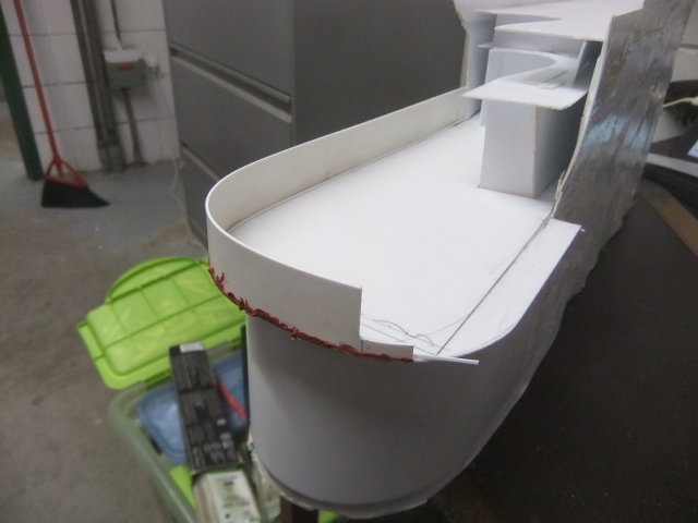

First I'd like to thank you for following this project , it's quite appreciated !

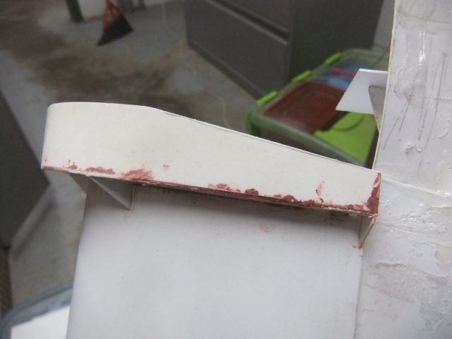

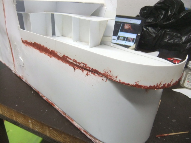

(JUL 25th ) Today I secure the last wall I glued ,cut out the top railing of the front section and apply some putty around the edge !

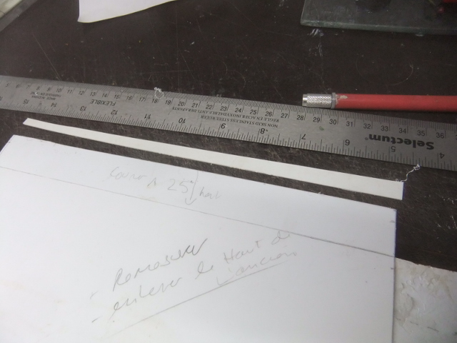

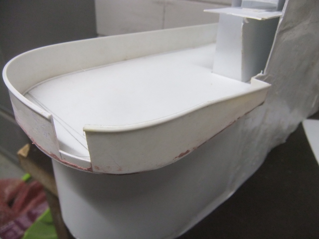

(AUG 1st ) Today I cut off the top of last week work ,and I add the front section sheet !

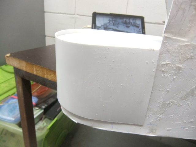

(AUG 15th ) Today I done the last section of the island !
