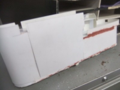

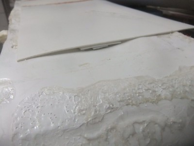

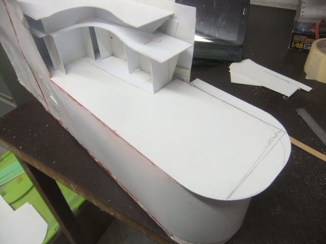

MAIN ISLAND STRUCTURE..
(SEPT 26th) Today I cover the structure with a thicker styrene sheet !

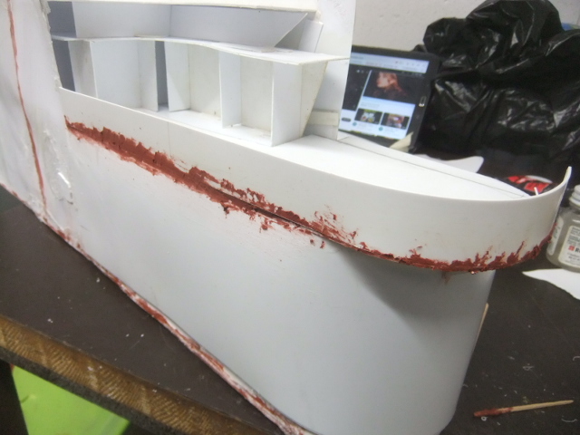

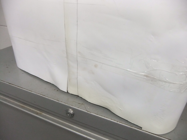

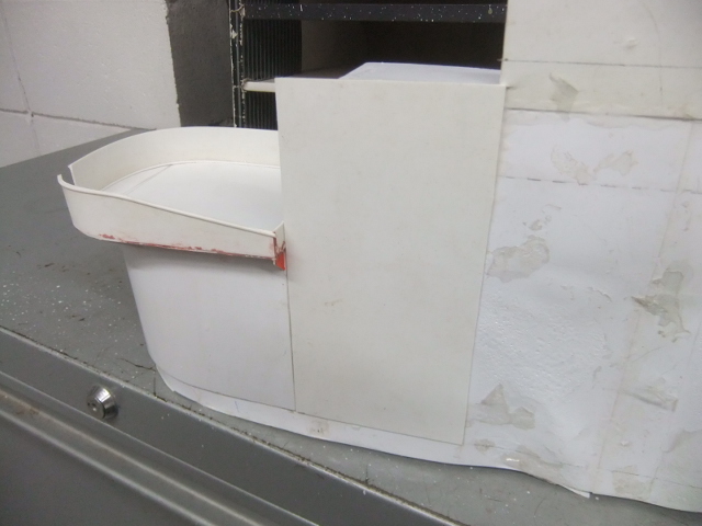

(MAY 27th) Today I realize the glued used last time as melt in the styrene , so I decided to remove it and stat applying a new styrene but this by section !

Re: HMCS MAGNIFICIENT in 1/48

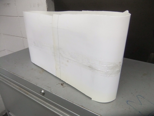

I can't tell how thick the plastic is, but it looks like 0.020" or 20 thou. You need to use at least 40 thou, or even better, 60 thou.
I used 20 thou on a 1/96 ship model many years ago and it warped and fell apart because it was too thin.

I agree on the use of at least .040"(1mm) styrene as that is what I use on my 1/144 scale ships.

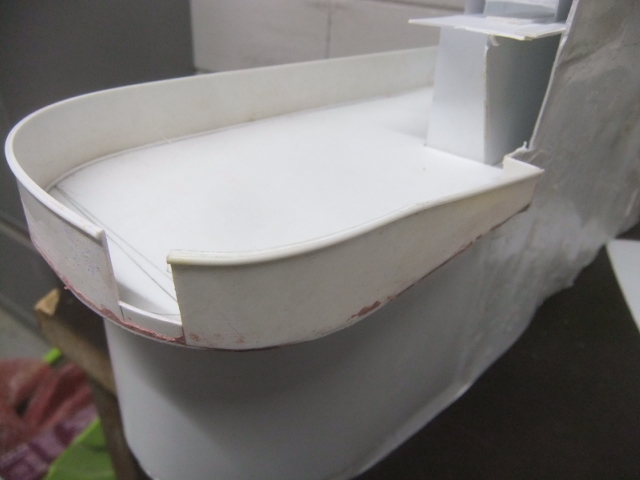

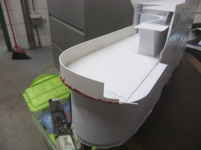

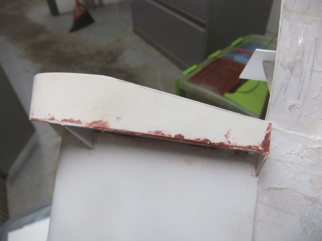

(MAY 30th) Today I cut out and glued the plateform !

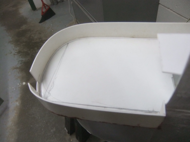

(JUN 13th) Today I continue working on the plate form details !

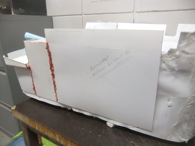

(JUN 20th) Today I completed the back railing !
(JUN 27th) Today I done the railing edge and glued another panel !

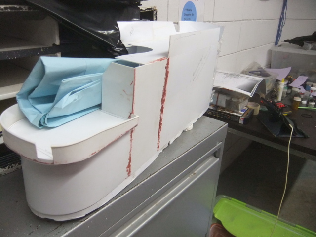

(JUL 01st ) Today I apply some expande foam in the island !
(JUL 11th ) Today I continue working on the main structure !

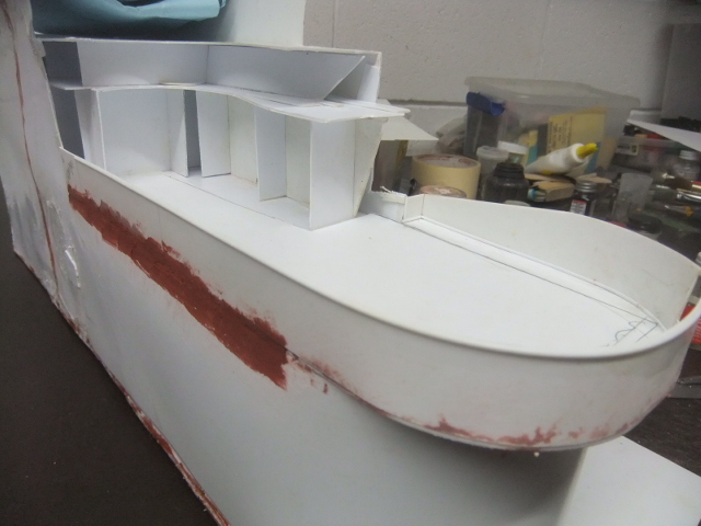

(JUL 19th ) Today I cut out the top railing and glued another sidewall piece !
(JUL 25th ) Today I secure the last wall I glued ,cut out the top railing of the front section and apply some putty around the edge !
(AUG 1st ) Today I cut off the top of last week work ,and I add the front section sheet !

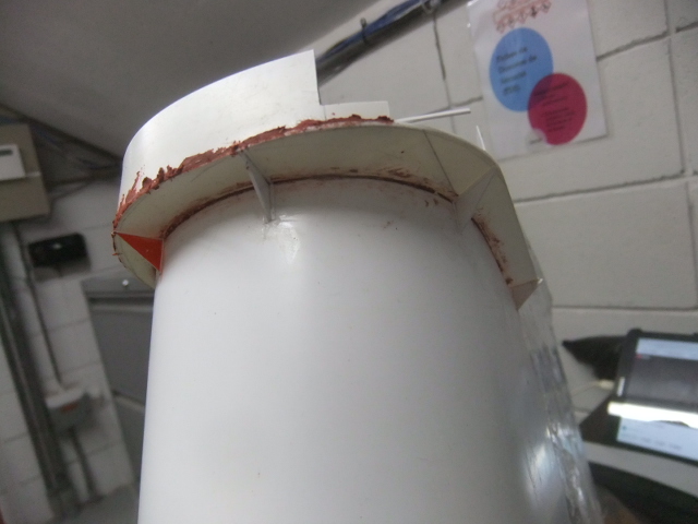

(AUG 15th ) Today I done the last section of the island !
