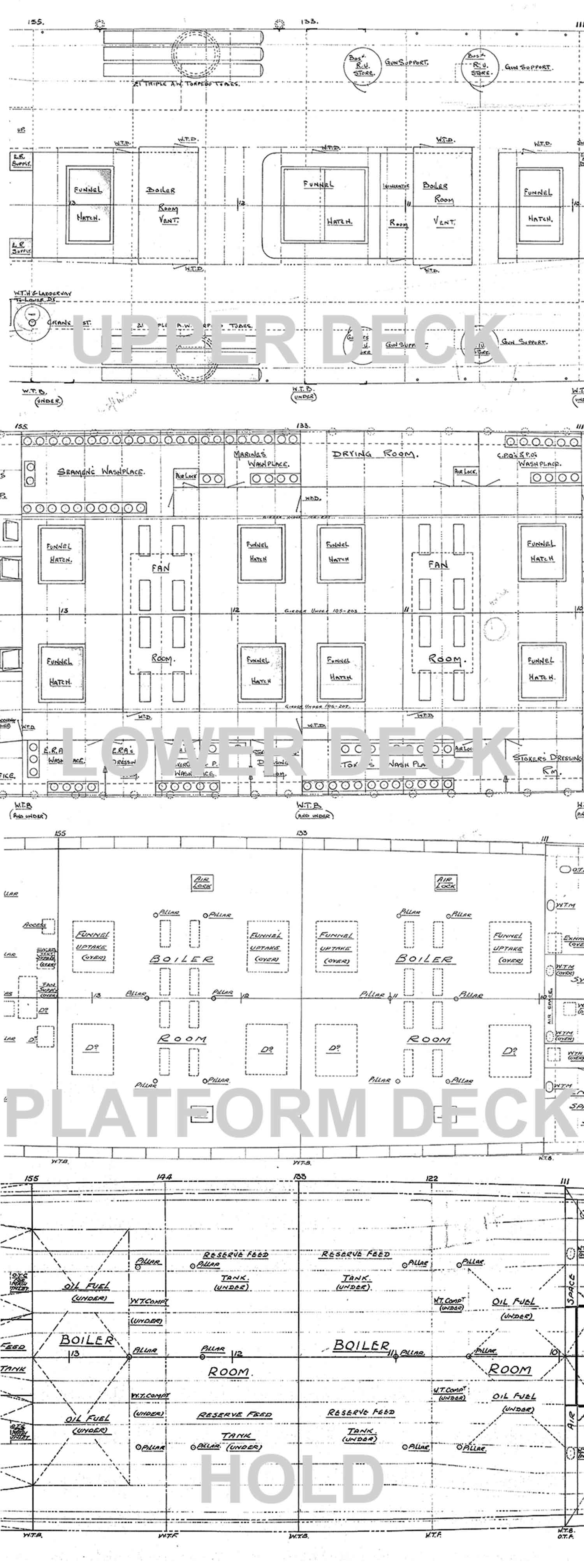

Brett Morrow wrote:The possibility exists that the actual boilers/boiler deck are not shown on the overhead plan. It is also possible that what Tracy has pointed out may be the fan assemblies in the fan room above. While it is likely the boiler room plan remained as originally designed for a 3 funnel cruiser your first mission would be to ascertain if that was the case. The profile plan `as designed` matches that of a Kent class, HMAS Australia which also shows the boilers in the same positions of the funnel uptakes, so your green dots may actually show the boiler foundations. An overlay of the overhead lower deck plan matches the position of the boilers shown on the profile. You could check Australia`s ships book No 4 at NAA Canberra which has the boiler reports and may possibly answer your question relating to A and B sets.
Thanks for your input Brett, much appreciated! But re your suggestion above, is that doable on-line(?), as given that I live on the other side of the world, literally about as far from Oz as you can get before you hit the North Pole, it will be very difficult for me in person. :big_grin:
Be that as it may, below a collage of the three deck levels above / below where BR is located from the 'as designed' plans. As can see still no indication of exactly where they are. And my understanding is there are no plans of her 'as actually built' (as opposed to 'as designed'), nor aware of any changes to BR's at any time. Of course, that doesn't mean there weren't any.
Brett Morrow
Posts: 346
Re: Calling all HMS York class (HMS Exeter-WWII) fans
Post by Brett Morrow »
Yes, you can make an enquiry to get a digital copy emailed, but it will cost you. Probably have to pay for a copy of the whole book, after which the full digital copy is uploaded onto the site and made available to anyone, that`s the way it works. If you have those projections, you no doubt have this profile which shows what I previously posted and also shows the fan apparatus on the fan deck, they are precisely in the position of the 16 strips. Sometimes the obvious can be missed, the overhead shows `Funnel uptake "over"

Brett Morrow wrote:Yes, you can make an enquiry to get a digital copy emailed, but it will cost you. Probably have to pay for a copy of the whole book, after which the full digital copy is uploaded onto the site and made available to anyone, that`s the way it works. If you have those projections, you no doubt have this profile which shows what I previously posted and also shows the fan apparatus on the fan deck, they are precisely in the position of the 16 strips. Sometimes the obvious can be missed, the overhead shows `Funnel uptake "over"
Thanks again Brett! So are you saying above that those 16 'strips' are the boilers (meaning eight boilers per BR then), or as someone else said above, are they 'the base for boilers', which could then still be / 'mean' just four boilers per BR, if what we are seeing (the 'strips') represent just the 'stands / base' for the boilers (i.e. two 'stands' per boiler, four boilers per BR)?

In relation to your question dated 29th, the 16 small long rectangular boxes I earlier referred to are the bases of the fans above the boiler rooms, but more likely the actual fan uptakes. 2 boxes per fan, 1 fan per boiler. As I had pointed out the funnel uptakes are situated above the boilers. The boilers are in the positions shown in the 2 cropped profiles I had previously uploaded, your platform deck overhead clearly states `funnel uptakes "over" which would indicate they are directly over the boilers.

Brett Morrow wrote:In relation to your question dated 29th, the 16 small long rectangular boxes I earlier referred to are the bases of the fans above the boiler rooms, but more likely the actual fan uptakes. 2 boxes per fan, 1 fan per boiler. As I had pointed out the funnel uptakes are situated above the boilers. The boilers are in the positions shown in the 2 cropped profiles I had previously uploaded, your platform deck overhead clearly states `funnel uptakes "over" which would indicate they are directly over the boilers.
Understood Brett, but................. it is the numbering that is (still) at an impasse / in question.

While it doesn't answer the question directly for Exeter, in the AOTS Warspite drawings the port side bolier rooms are even numbered, with the number increasing from bow to stern and the starboard side has odd numbers (e.g. first boiler room closest to the bow No.1).

Ed R wrote:While it doesn't answer the question directly for Exeter, in the AOTS Warspite drawings the port side bolier rooms are even numbered, with the number increasing from bow to stern and the starboard side has odd numbers (e.g. first boiler room closest to the bow No.1
Thanks for your input Ed!
That numbering system doesnt seem to jibe though with Exeter's CO's AAR and report by Exeter's engineers with regards the damage to Exeter's boilers.
