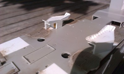

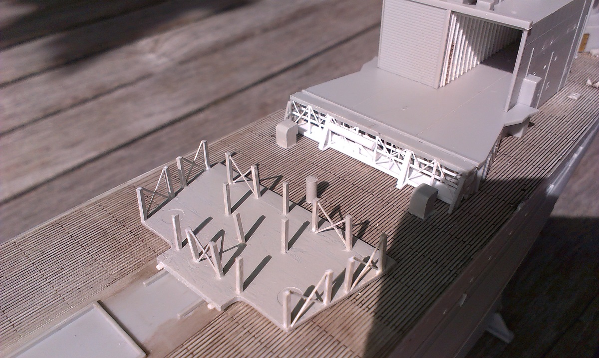

- Maarten Sch�nfeld
- Posts: 1846
Re: Trumpeter HMS Cornwall 1/350
After further looking at many photos I think I found another inaccuracy in the kit: the aircraft catapult deck does not sit on two closed superstructures, but only the rear one is closed from the sides. The forward one is supported by pillars with diagonal braces to prevent the deck from swaying. However, in case of the Cornwall, I think also the rear one is an open structure...
To make it look better I decided to cut the deck up just behind the aft funnel, and left and right from the catapult track. As you also get some inside view on the catapult itself (ok, it is obscured by the deck) I decided to detail the catapult itself too, with some guessing what it might look like. The ample planked deck area from the kit proved to be a blessing in disguise! I worked also further on the shelter deck (also called superstructure deck). I decided to re-use the planked areas around the 4" gun mounts from the kit, transferred to their new positions. I also have revised the gun crew shelters, taking all the notes into account.
Roger Whittaker +9/13/2023

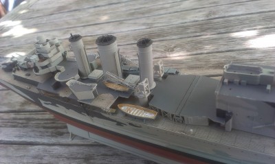

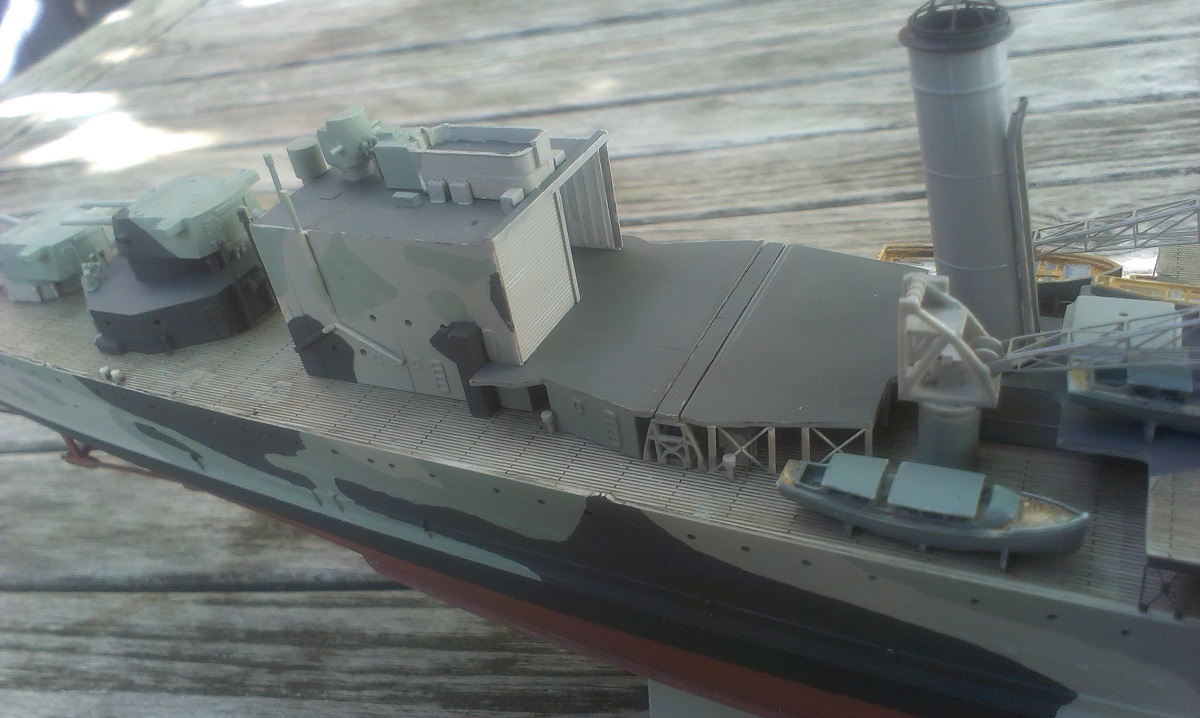

- Maarten Sch�nfeld
- Posts: 1846
Re: 1/350 HMS Suffolk (C55)
More update photos. Biggest remark is that the PE deck supports appeared too tall, needed to be reduced by 1mm from the top! All cable reels and ventilators were added next.
I added the ship's boats: the two 32 ft cutters below the superstructure deck were ok for me, there is not much to be seen from them anyway. The larger boat on port near the crane is another matter: it should be a 36 ft launch, but it measures out to be 40 ft. I took out one thwart amidships reducing the length by 3.5mm, now it looks fine.
Ahead of it lays a 16 ft dinghy, not visible on all photos. It is from Admiralty Model Works, and so are the 30 ft gig on the superstructure deck, and the two 35 ft fast motor boats on starboard. I painted these AP507B, as these seem different in tone than the colours on the hull. Paint needs still some touching up of course.
I also altered the 'Cornwall' nameplate into 'Suffolk', by scraping and sanding the letters away, and cutting new letters from .005 inch Evergreen sheet. I think I will add a ship's crest too from scratch.
Now on to detailing of the bridge and the aircraft hangar!
