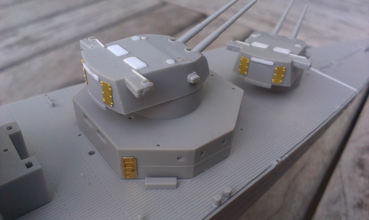

Another minor point on the Trumpeter kit: the 8" turrets are apparently correct in outline (even better then those in the Exeter kit), but are lacking most external details.
Please see what modest details I added to make it look better. Note also the two PE doors added on the octagonal superstructure for the X turret: these are shown in the kit instructions, but are missing in the kit! I added these from WEM standard PE, to remain in line with the rest of the kit.

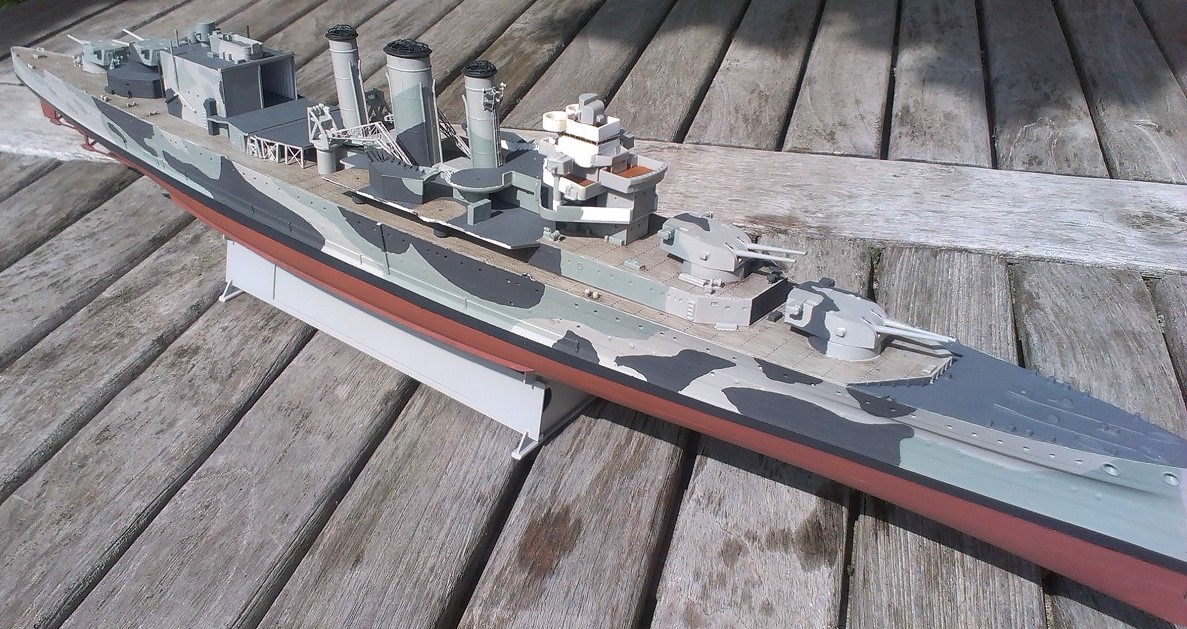

Conversion of the new Trumpeter Cornwall kit to HMS Suffolk May 1941. My build is really beginning to look like the real thing.
For earlier posts on this build look on the Trumpeter Cornwall posts on the Main Forum.

PostPosted: Fri Aug 23, 2019 7:24 am
Posts: 502
Location: Inverness
Looking nice and neat
Cheers. Jabb
HMS Hood, the big one!
PostPosted: Fri Aug 23, 2019 12:03 pm
Posts: 633
Location: Palm Beach, Fla
Great Effort! Thank you.
John
PostPosted: Fri Aug 23, 2019 12:36 pm
Posts: 1813
Thanks, Jabb and John!
Roger Whittaker +9/13/2023
PostPosted: Fri Aug 23, 2019 1:32 pm
Posts: 5569
Well done Maarten--looks like sharp work :thumbs_up_1:
JIM B :wave_1:
PostPosted: Fri Aug 23, 2019 2:45 pm
Posts: 1813
Thank you, Jim!
It is really an enjoyable build because... the Trumpeter kit is basically sound! This makes the conversion straightforward.
If the basic kit would be off in many places, you would run into these all the time, making the conversion a drag, while correcting the basic errors - if possible. In fact my correction of the hull scuttles was the largest correction I made, but that affected hardly any of the modifications.
So, hooray for Trumpeter, for getting us this time a better kit!

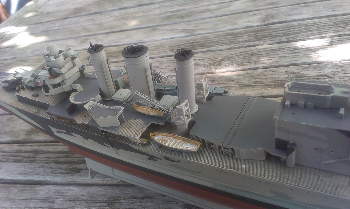

More update photos. Biggest remark is that the PE deck supports appeared too tall, needed to be reduced by 1mm from the top! All cable reels and ventilators were added next.
I added the ship's boats: the two 32 ft cutters below the superstructure deck were ok for me, there is not much to be seen from them anyway. The larger boat on port near the crane is another matter: it should be a 36 ft launch, but it measures out to be 40 ft. I took out one thwart amidships reducing the length by 3.5mm, now it looks fine.
Ahead of it lays a 16 ft dinghy, not visible on all photos. It is from Admiralty Model Works, and so are the 30 ft gig on the superstructure deck, and the two 35 ft fast motor boats on starboard. I painted these AP507B, as these seem different in tone than the colours on the hull. Paint needs still some touching up of course.

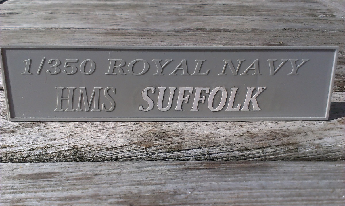

I also altered the 'Cornwall' nameplate into 'Suffolk', by scraping and sanding the letters away, and cutting new letters from .005 inch Evergreen sheet. I think I will add a ship's crest too from scratch.
Now on to detailing of the bridge and the aircraft hangar!
