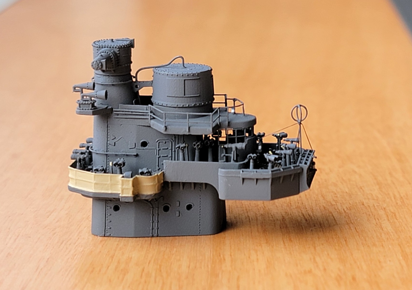

Continuing on – I installed guy wires to support the RDF loop, added more voices tubes, and used gold paint to depict the brass openings of those tubes. It’s not evident in all these photos but, I eventually did paint all the binocular lens with semi-gloss black . They looked too plain, otherwise.
I also began adding paint to the rails to mimic canvas covers, I used a new custom mix that’s a little off in color in these photos. Unfortunately, the paint did not flow properly around the radio equipment boxes on those small wings. So, I had to carefully remove both the equipment boxes plus one 110cm searchlight controller. The controller was glued on using CA, so I had to apply debonder from underneath after drilling a hole up through the bottom of the platform. It worked, T-G.
Eventually, I re-applied paint after cleaning these areas up and gluing those parts back on. It all worked out.

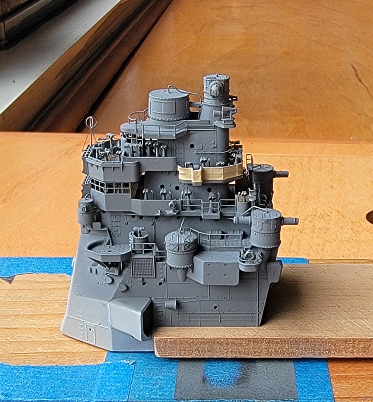

The bridge is posed with levels together. The bottom two levels have been glued together, but I’m leaving the upper, Sokuteki deck separate until after the foremast and rigging is installed. I also installed flag bag enclosures formed from excess railings on the next level down.
I can see that few touch-ups are still needed.

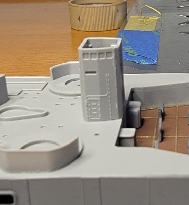

I’m still waiting on the new 01 deck PE parts, so I will hold off on finishing the lower front face of the bridge. I began working on the other structures that will be placed on the 01 deck. I started with the auxiliary command and steering tower, located aft.
This is the backup for the bridge, and it includes another Type 94 Main gun director atop the tower. This location is common among the IJN heavy cruisers and usually gets little attention in most models, particularly in 1/700 where many depictions don’t realize that the position is lined with windows, not intake or exhaust vents with grill covers.

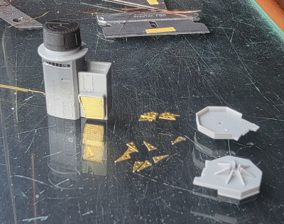

Both Aoshima and Veryfire show molded in window frames for this location, which is good. Veryfire has done a reasonably good job of it but, given how the tower is constructed, they deleted the frame on either side of the tower that actually faces aft. This is also true of the Aoshima version. I decided to open them up and install a proper bridge deck. I drilled and carved open the molded windows areas and installed window framing. I added an internal deck, compass binnacle and a pair of search binoculars.

The tower was topped with another Type 94 Main battery director Two pairs of bandstands for triple 25MM AA mounts on either side were erected as well. The graininess of some of the photos notwithstanding, I’m happy with the result.

However, I did not realize until afterward that there may be an intake grill missing from the base of the tower on the port side. Which is odd, since these type arrangements tend to be symmetrical. (Note: The Aoshima kit has a symmetrical arrangement.) Documentation is sparse on this point. I just scratch-built a version of this, pretty much freehand.
