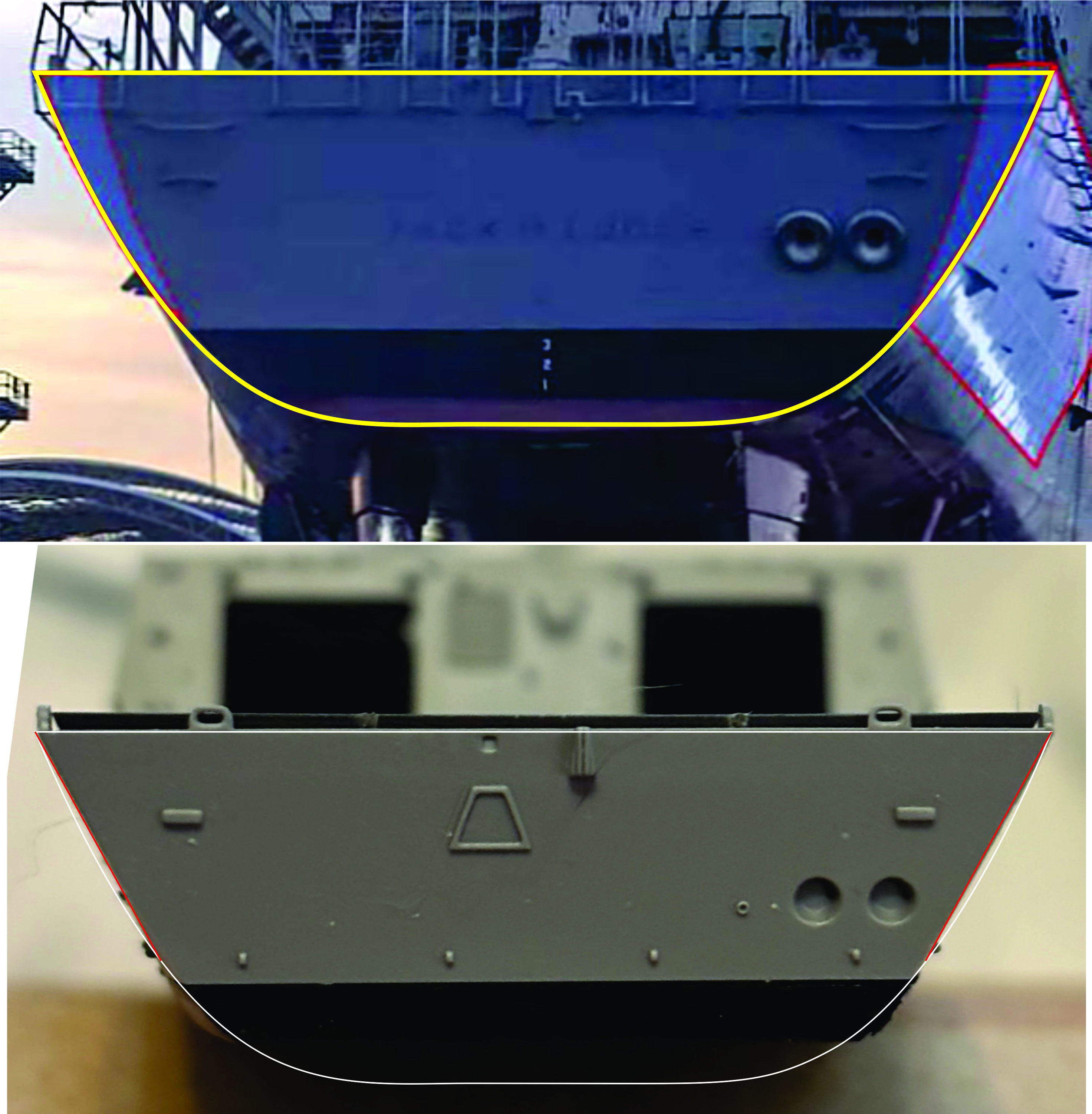

We'd be more interested if you could tell us whether the enlarged stern lines of Flight III are correctly represented in this kit.

Actually I have no idea if the kit is "accurate" for the real ship, much less for the stern. I don't have official drawings nor dimensions of the ship's stern to answer that question. I can't find any really good dead astern views of USS JACK H LUCAS (DDG-125) or any of the Flight III destroyers. Most images I find online are glamor views from the Forward Quarter. Here are some "stern views" I did find, with the only the dead astern view being a very small image.
I added a dead astern view of the kit ... you tell me if the shape and scale size is correct???? The only thing I see questionable, is it looks like the sides on the real destroyer has a slight curvature to it.
This is my first BURKE class model, even though I wanted one to compare the size to my WWII kits. I never bought a kit before because; 1. The reviews I read said that kit was inaccurate or had other issues. or 2. The kit couldn't be built waterline. and/or was made by Trumpeter (they seem to work overtime making inaccurate models). Until I get around to actually building the kit, I won't know what is wrong or right about it.

It's close. The sides are a little to flat.
