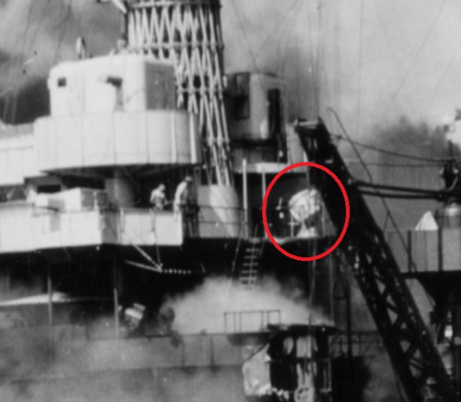

36" searchlight?

FFG-7

Post by FFG-7 »
is at least a 36" when doing a size comparison with the 2 men to the left of it.

Re: Calling all "Big 5" Tennessee-class & Colorado-class fans
Post by Dan K »
I have to disagree. It's a 24" signal light. Compare it to the other 24" on the deck below vs. the 36" lights aft.
FFG-7

Post by FFG-7 »
Dan, look at the size of the light compared to the 2 guys to the left of the light.
BB62vet
Post by BB62vet »
In comparison between the photo presented and official 24" searchlight photos - details point to it being a 24" searchlight, not a 36". And also as mentioned, the size!
FFG-7
Post by FFG-7 »
it appears I stand corrected because of this tho 1939 Wee Vee version.

Posts: 8624
Thanks all! Appreciate the assist!
