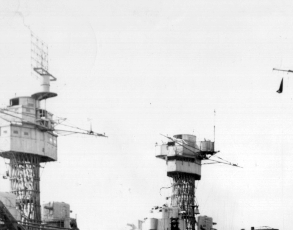

Thanks Jeff. I guess it was the incinerator then. From the port side it looked like the pipe went much farther forward.
- Posts: 8623
Re: Calling all Pre-war "Big 5" (TN/CO class) fans
Found some additional photos, cropped them to show the forward funnel piping arrangement on BB-48. First one is from 1937, the second from 1939. Photos are from NARA II, via Roger Torgeson.
- Posts: 8623
Comparing the picture that Jeff posted (left) to the 1937 shot I posted (right), it does seem like that pipe from the incinerator to the funnel was modified at some point.

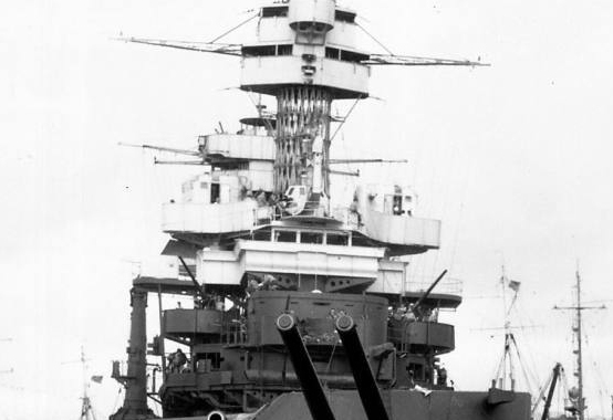

Re: Calling all "Big 5" Tennessee-class & Colorado-class fans
Found a reasonably priced 1/350 Tennessee from ISW on eBay last night and pulled the trigger. How different are the forward superstructures are California and Tennessee at the time of the Pearl Harbor attack?
- Dick J
- Posts: 1994
The two had very significant differences. California was a fleet flagship. As such, the flag bridge was enlarged similar to the one on Pennsylvania. This, in turn, impacted things like where the 3" gun tubs were added. The wings on the pilot house were also differently shaped. California had her CXAM radar mounted on the roof of the pilot house. You will need more than a little scratch building to convert one into the other.
- Posts: 9116
In looking at photos (and models), is it that California's signal bridge deck is 1/2 deck lower than the other Big Five sisters, thereby allowing for an extra deck to accommodate her flag facilities?

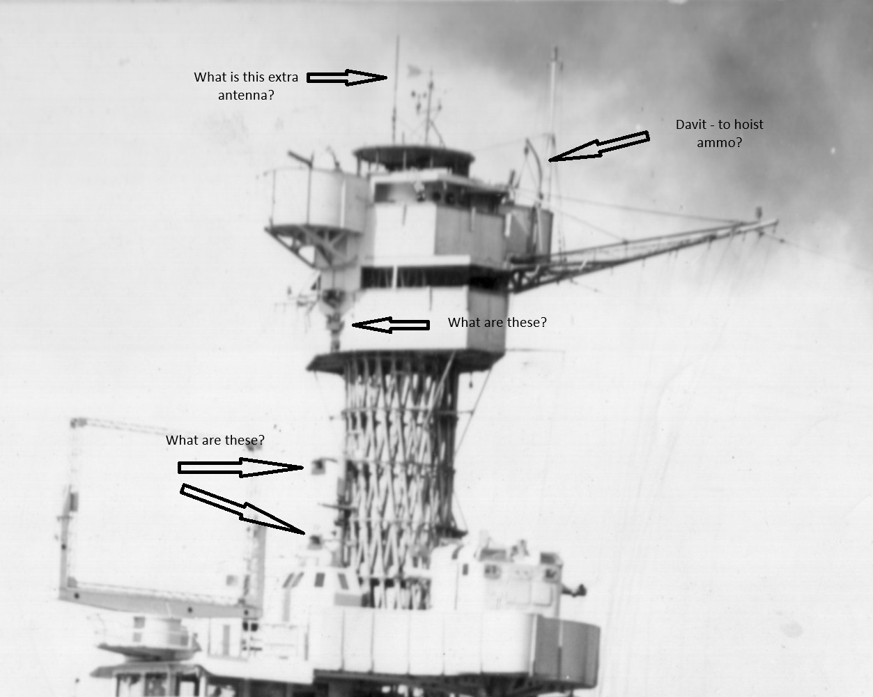

Few more California related questions, this time about the forward fighting top. Questions embedded in the photo:
I am also trying to discern if there is a davit on the forward .50cal gun tub. I'm thinking no, but would appreciate other's opinions.
- BB62vet
- Posts: 3173
- Location: Mocksville, NC
Martin,
To your second question - Yes! that's a davit, more than likely to hoist ammo (or mid rats!!! LOL!!) FYI - I've noticed that feature on quite a few of the post Civil War later Monitors as well as pre-dreadnaught type warships.
I can't answer the other questions - beyond my pay grade!
