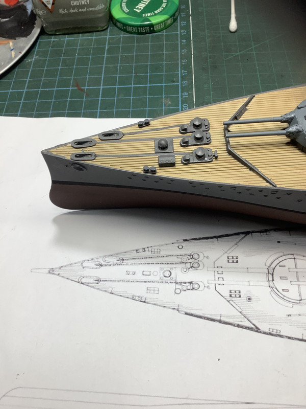

So , the hull sides are now ready for their portholes to arrive , time to look at the deck. Not much for options here other than paint it . Gave it four coats of different deck wood colours, with strips of masking as I went to give it some variation, filtered with a dilute to tone it down and washes it with Van Dyke brown oil . Probably a bit dark for Home Fleet, but for Jutland, 2 years into the war ? The oil will tone down a bit when it is dried out .
Will start with the superstructure next, question for those more knowledgeable than I ? Would the decks by dark grey steel or corticene , which I don't think would have been fitted in 1911 ? The plan view I have shows brass 'strips" maybe ?, or maybe just joints in the plate?, any advice appreciated

Thank you both, I've come to realise that this is not a 'shake and bake' model with 3D, a lot of lazy choices by the designer - which is a shame as for a bit better research it could truly be outstanding .

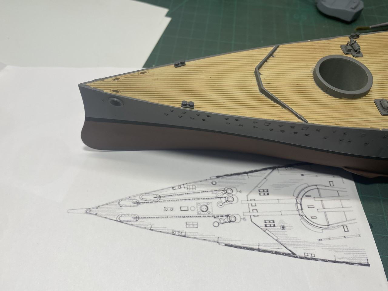

So....after scanning and sizing I now have an answer as to the shape .
If we go with the assumption that the length is the main dimension, she's about 10 mm wide in the hips , and 5mm taller from keel to main deck, although the turrets , & most of the superstructure fits the plan at whatever scale we are calling this (approx 1/325) .
At least now I have a way of placing the parts where they should go, and now knowing the descrepency hopefully that won't irritate me too much and spoil the build .

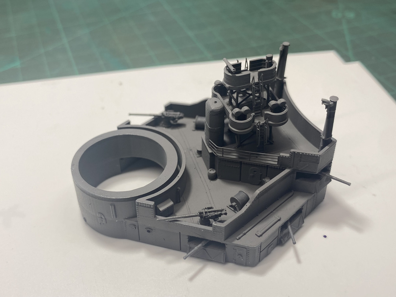

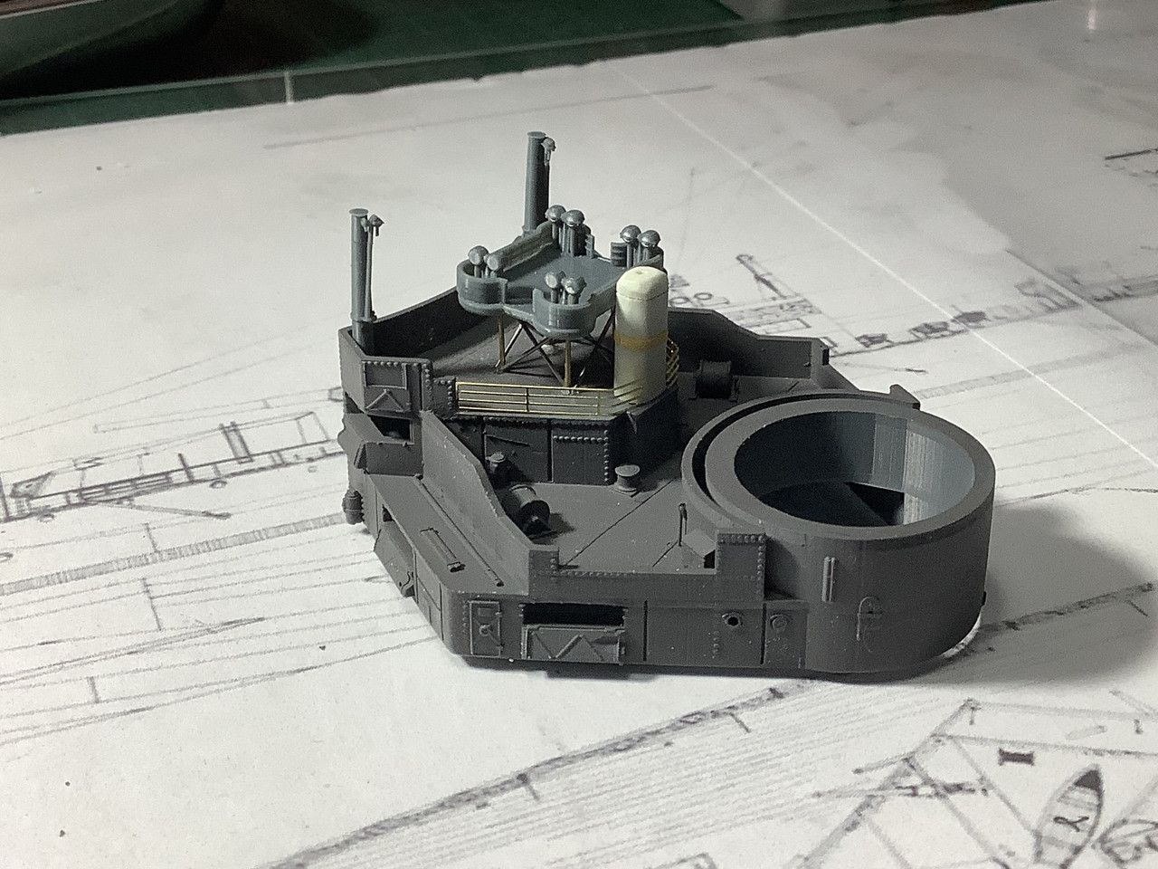

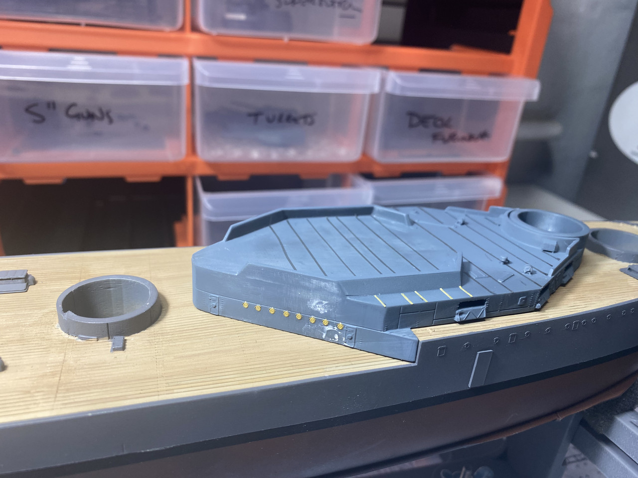

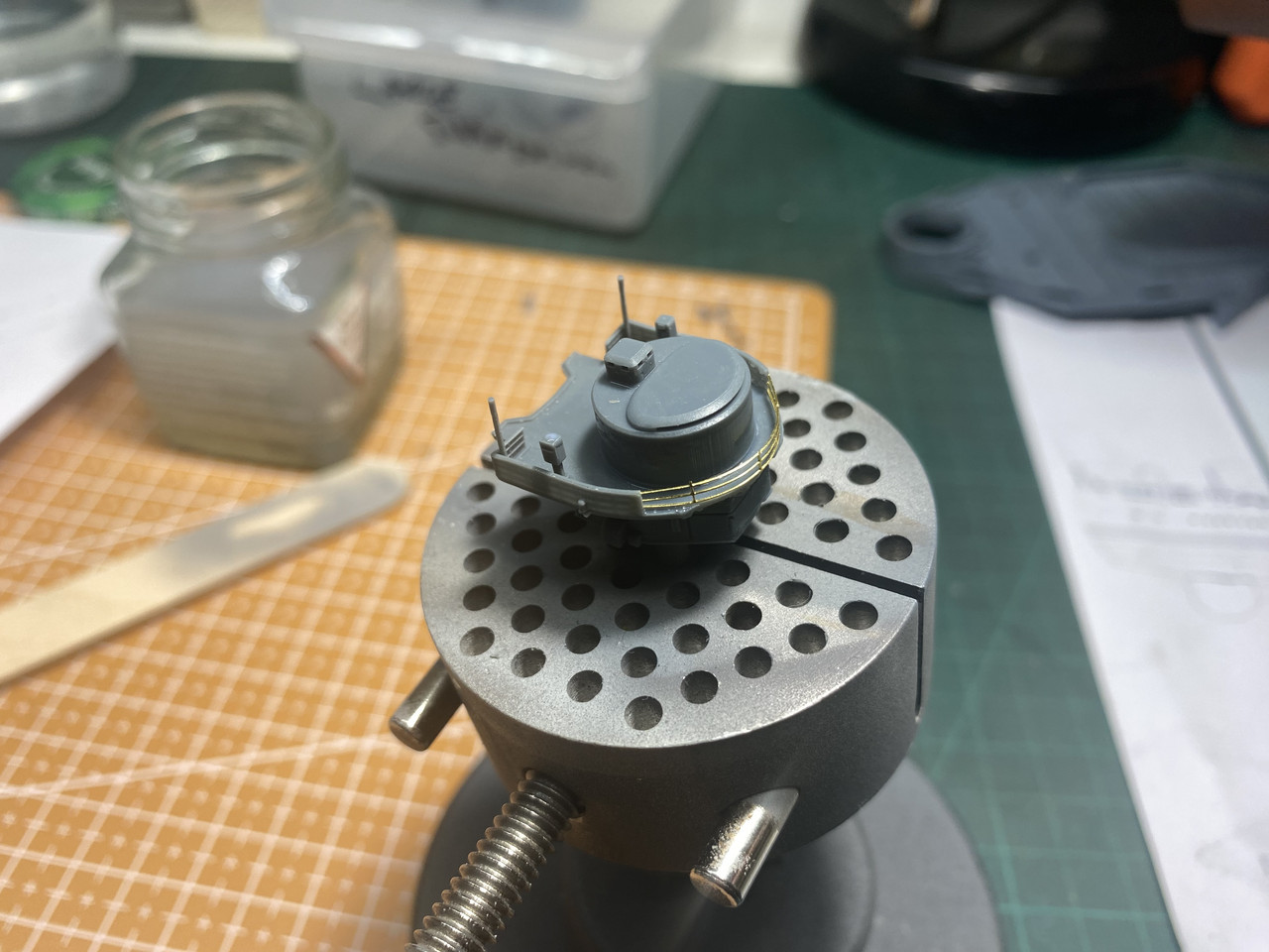

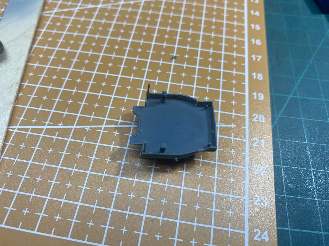

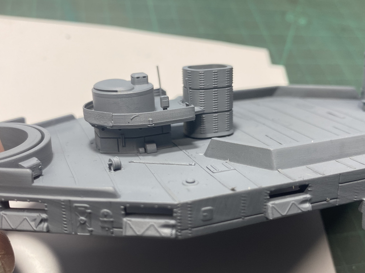

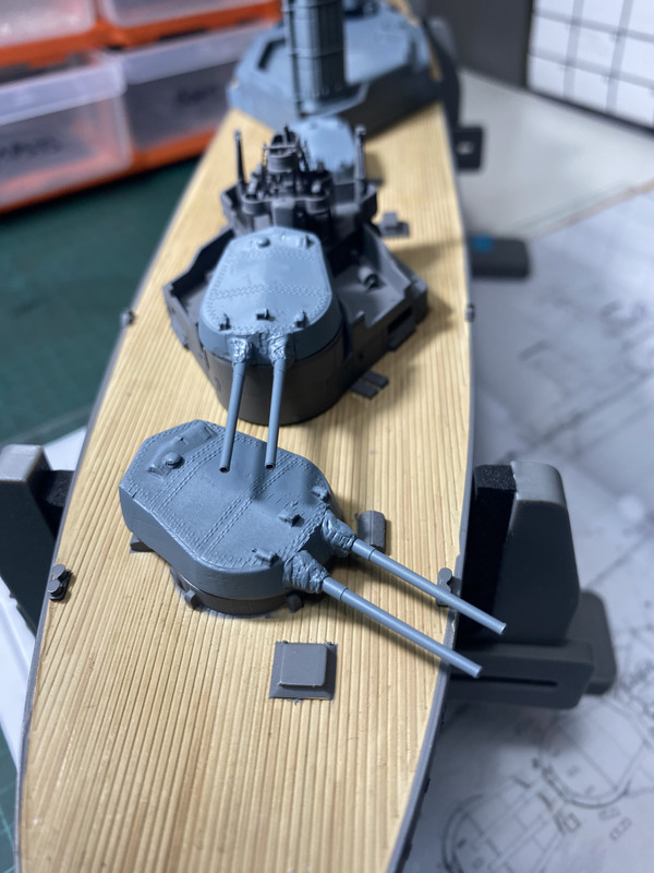

Another week on
Worked on the rear superstructure .
Reduced the mad riveter's rivets , added some plating lines on the deck , completed the searchlight and range finder deck . had to construct the supports from brass as the resin ones were poor . Added ladders and PE railings ( not included ) and scratched the rear director as it came without .
Cleaned up the nice 4" guns and mostly completed the assembly for now .
Moved onto the main superstructure, without instructions or location pins it's all measure 3 times and glue once. Using small amount of CA glue for initial fit , and then running diluted matte liquitex to give a better bond .
Added plating lines , and also add plates where the boat rests (presumably) were removed , as much to give some interest. Also cleaned the rear area of fake playing and overdone davits .
For some reason and without any reference to the reality, SSM decide to make the front of the lower bridge square not round ....so corrected that
Replaced the oversize resin barrels on the turrets with metal ones , need a bit more work to complete
The anchor chains etc are all a copy from Iron duke not Conqueror so had to correct that too , as the chain capstans needed to be in a line not stepped as SSM would have you do it . Also made chain guides from 0.2 styrene .
Feel I'm making steady progress so far , having worked out how the bridges fit together and decided to scratch the tripod , next week would in interesting :)
Also need to think about the sea it's going to fit in and resolve that before the model becomes too delicate to handle without doing damage.
