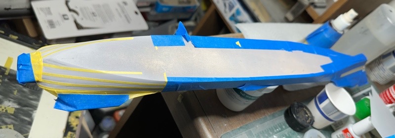

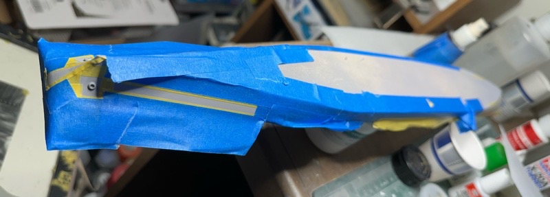

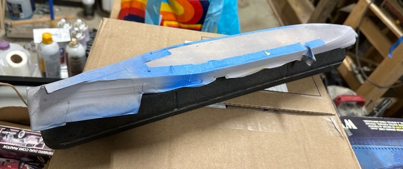

Onward like a giant steamroller goes progress. This morning, flush with holiday idleness, the voices in my head urged me to expend a lot of innocent masking tape.
Tabitha saw the expenditure of tape and started to worry that Mommy might be headed to the Home For The Bewildered.
But there was method to the madness. On went more high-build primer...

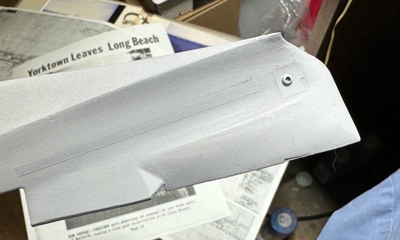

...and after the tape came off, there was the suggestion of texture on the hull, from doublers and lapped plating.

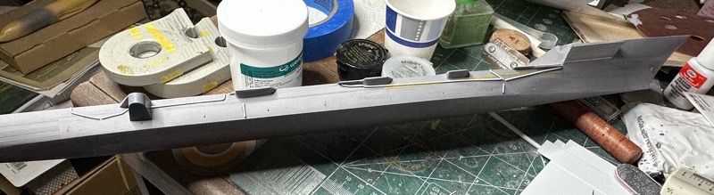

Once that had set for a while, here came the fun of adding external details: fuel lines, holes suggesting the recessed mooring bits, overboard discharges, and a million other things. We'll be doing this for a while. I also had to extend the little platform forward on the starboard side, and add some tape to represent another raised area, because you find these things out after you've cut the initial version. Under the paint, though, you shouldn't be able to tell a difference.
More to come soon, I hope.
