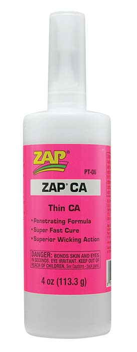

Your two threads on how you make water from art paper are really interesting. I was originally thinking of using the Oats Bran technique as so ably explained by Chris, but am thinking of trying yours first for my 1/1250 scale ships.
Before doing this, I wonder if you could just clarify how you soak the paper with the CA glue? Do you paint it on, squirt the stuff over the paper, or are you doing it in some other way?
And since I'm pestering you anyway, one more thing won't make much difference... would there be any chance you could add a link to where you get the glue? I seem to only find it in small tubes, and never thin viscosity for some reason in Northern Ireland. This is another reason why I've put the Oats Bran Method on the back burner at the moment.
Thanks!
Last edited by Cuchulainn1795 on Fri Sep 26, 2014 12:30 pm, edited 2 times in total.
PostPosted: Fri Sep 26, 2014 9:07 am
Posts: 5583
I buy pink ZAP ( by pacer ) its very runny-and very pongy--work in well ventilated area!!!
I spread it with a pice of styrene and or toothpick ( no absorbent--sont use a brush or paper!! )
buying it large bottles moderates the price well...
In Northern Ireland...?
dunno...
THESE GUYS SHIP to all UK
http://www.modelshop.co.uk/Content/Dyna ... _4Dcat.pdf
( PAGE 7 OF 167! )
as below

Excellent Jim, your most helpful reply is very much appreciated! :wave_1:
