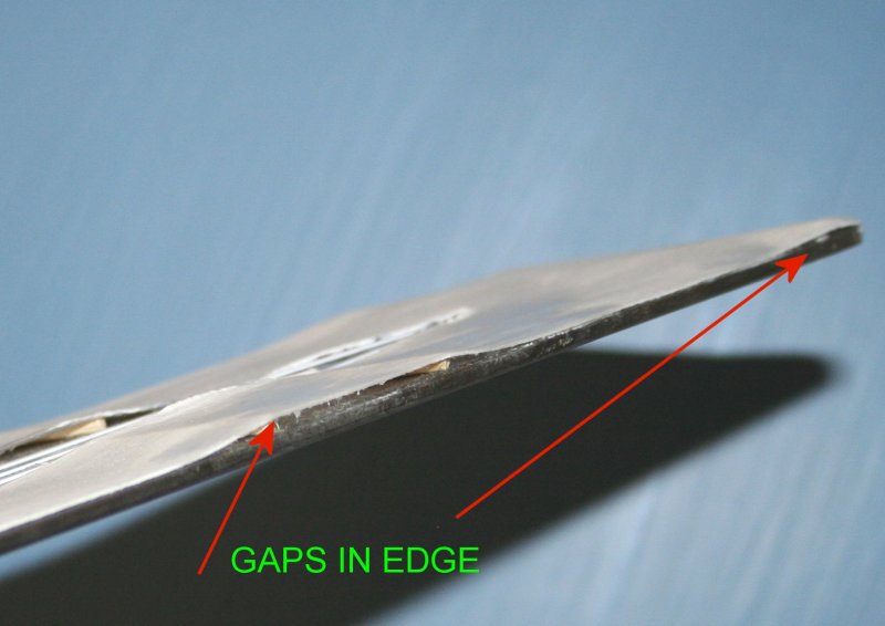

At the edges of the paper ( the sea!) there are unsightly gaps ....
These are then filled flush with autobodyfiller, a two part polyester filler consisting of paste and hardener.
This sets firm within about 5 minutes so that the coarse trimming of any surplus can take place with ease-again using the stainless mounting plate as the knife guide.
Within 10 minutes the reaction is complete and final trimming and a light sand can take place.
