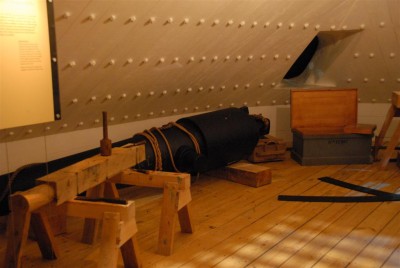

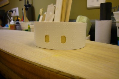

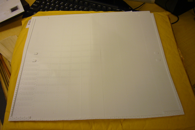

No, the skins have plate for both raft & turrets. Actually, Steve has 2 turret skins on each sheet one for the Ericsson turret & the other he calls his "reject" that didn't pass muster since its slightly different but will make an ideal skin for the front Eads turret on Milwaukee. Deck plates will be made from plain styrene sheet for the monitors as well as Tennessee which I'll score to mimic the 2" rail armor.
I've attached some photos I took this morning as well put one of the original Monitor for reference. Dumas' pattern was off which is why Steve made these after much research & assistance from The Mariners Museum. They even allowed him access to Monitors relic turret to measure the pattern & cannon ball damage! :thumbs_up_1:
Regarding deck camber, I'm debating that now since I've not yet found Lucite thin enough to use & have a door skin already cut for the template. For sure on Chickasaw / Milwaukee Class when I get to that project. Will be putting up photos this week on RCG & SP threads.
Chuck
Steve's 1/72 plate skins

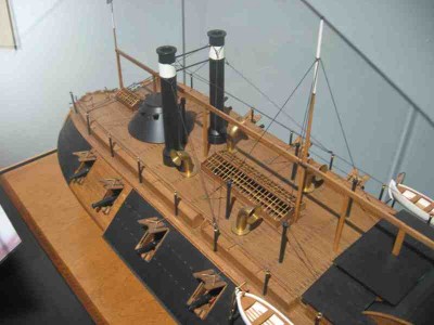

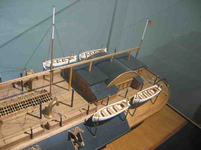

If anyone is interested in City Class gunboats, I just received 30+ photos of a USS Cincinnati model that I'd be happy to share. Unfortunately many are not as clear as the examples below, but they offer a lot of detail to anyone interested in modeling this rivertine ironclad & cover just about every angle of the subject. :thumbs_up_1:
Chuck

I, of course, would love copies of those. Where exactly is that model located?

The model is at Cincinnati's History Museum http://www.cincymuseum.org/explore_our_ ... efault.asp. Email containing the full size photos is on its way.
Chuck

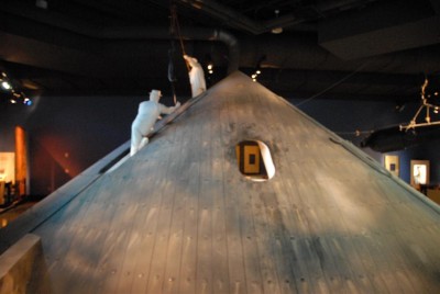

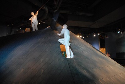

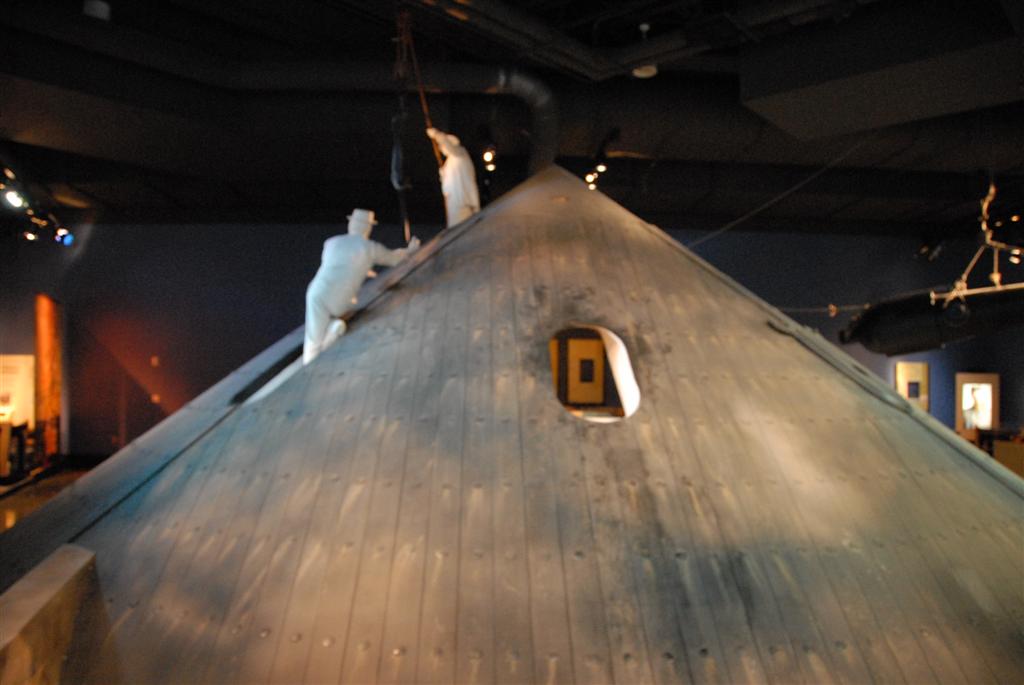

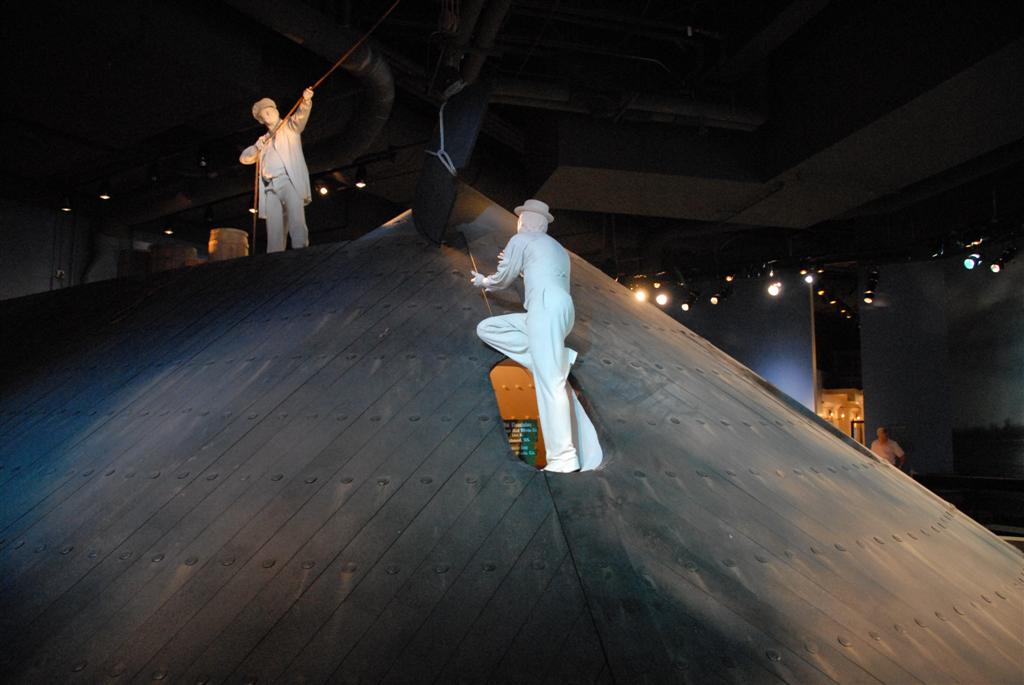

October 10th visit to the Mariners' Museum.
Bob Wescott
Part I
The Bow of CSS Virginia

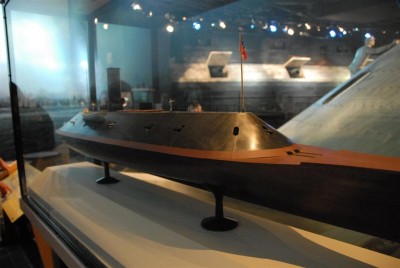

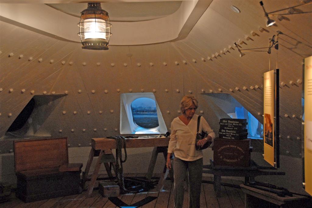

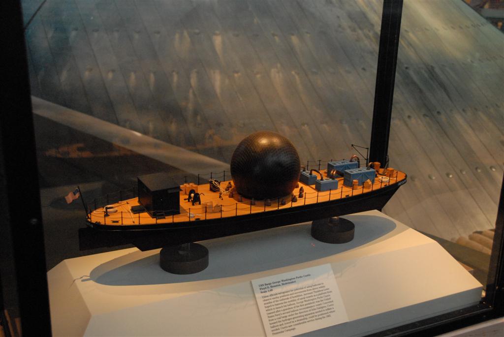

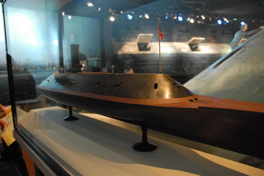

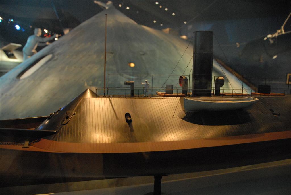

Part II
Balloon launching Ironclad
CSS Virginia
CSS Virginia

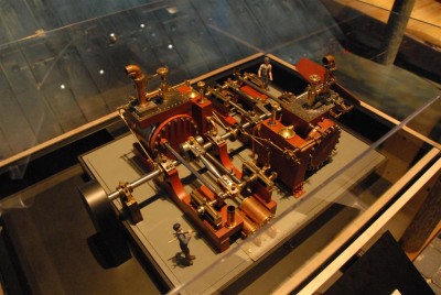

Part III

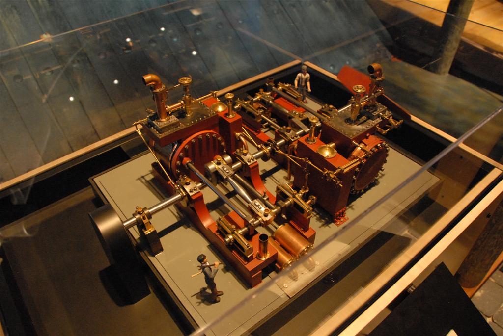

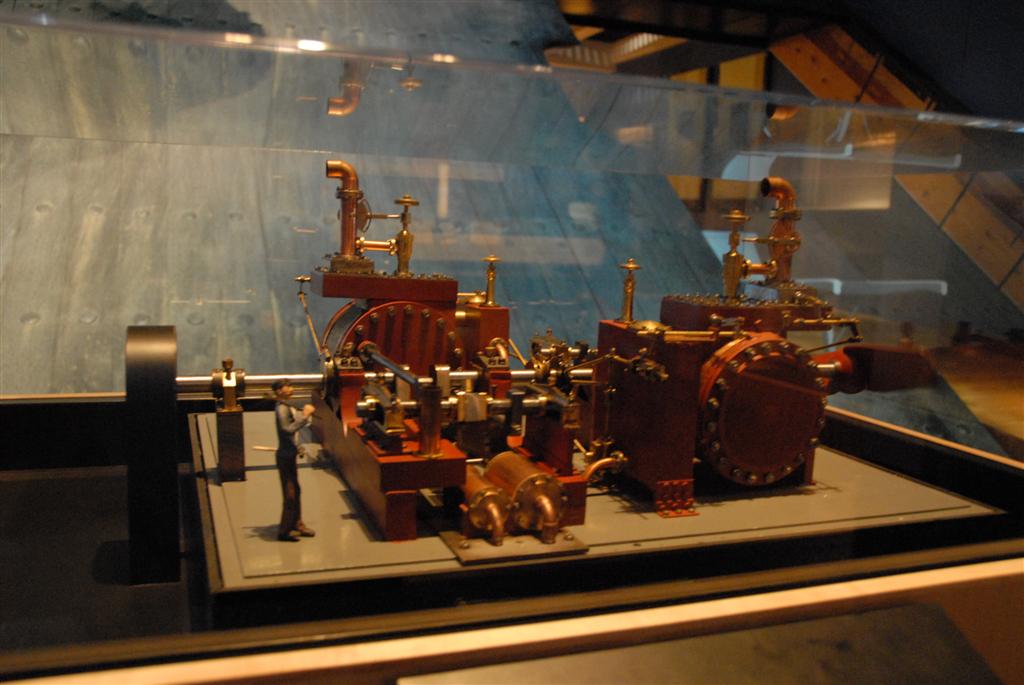

Engines of CSS Virginia

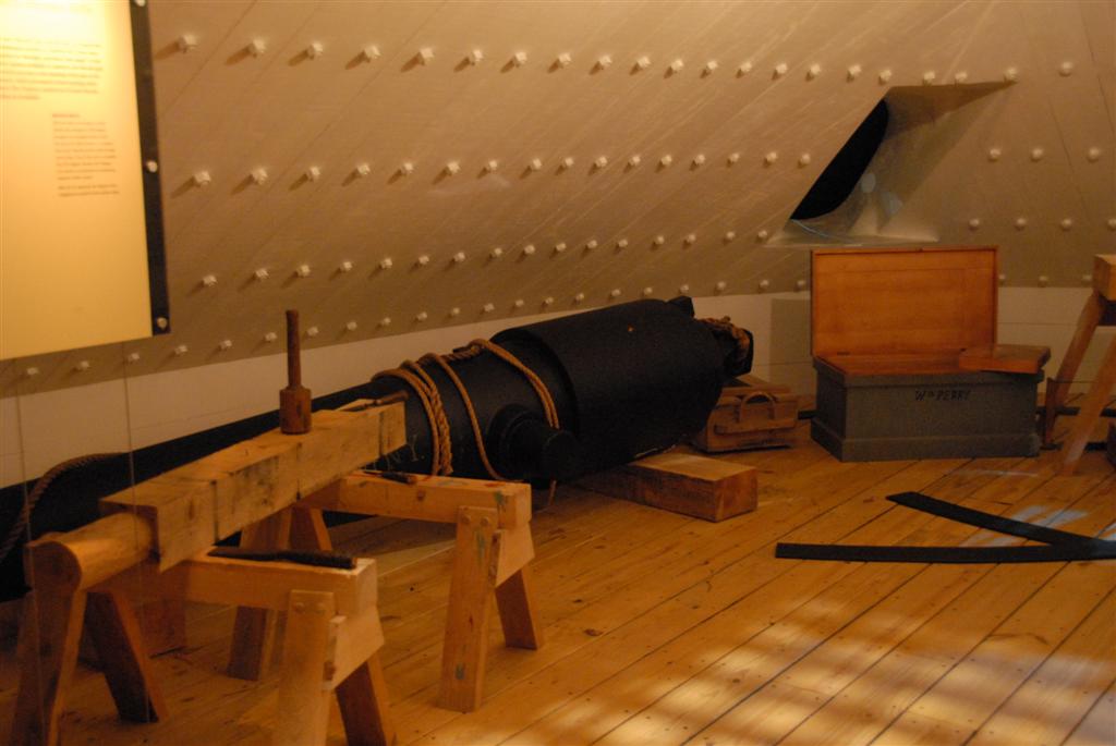

Part IV
Painting of both Ironclads.
Bow section inside.
Bow section inside.
