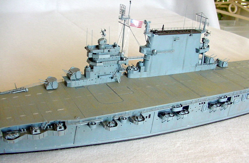

The safety nets came out great. I know you said the bases were Tom's white metal, are the 40mm's the kit parts or some other aftermarket accessory?

Bob, this afternoon, before I read your post, I was looking throgh Wiper's book - with 15 PAGES devoted to Sara in dazzle - and I thought that it would be a crowd pleaser to do her in the dazzle scheme - BUT - she only wore that scheme on her trip from Puget Sound to Pearl. She was in meas 21 at Iwo and that fact should be honored. The only AA I was able to use from the 42 Lex was 16 20mm. Bought 4 twin closed 5"-38 (L'Arsenal), 8 5"-38 open (L'Arsenal) and made 23 quad and 2 twin 40mm. The quads had Tom's white metal base, YKM barrels, PE railing, scratch tub base (.020" styrene), scratch .010" brass splinter shield, scratch brush bristle shield flanges/ribs, scratch .005" brass angle support, and some had additional scratch .022" dia straight pin support posts! Three different tub designs were used. LOTS of PARTS!

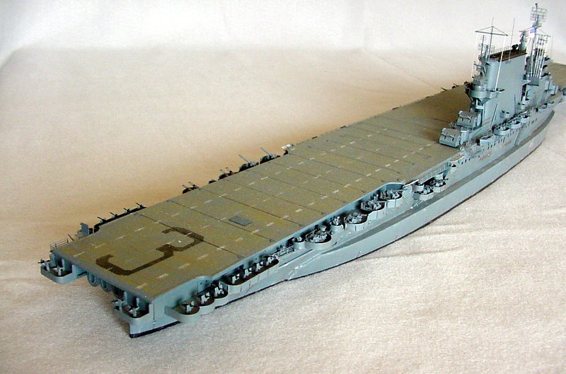

The pictures I have posted show a reduced stack. I left on the sprue parts D13 (gun platform) and D4 - D5 (stack upper level). This action gave me a flight deck to stack top height of 2.26", FDD plans convert to 2.21". Much easier than I expected and a error I can live with! The funnel cap fits well on the reduced funnel, I reduced the wings and removed the cowl in front of #1 pipe, there is some work needed on the corners.

Finally done with the ship. There is more to do - deck vehicles & planes - but I have to clear the dining room table - taxes (which I cannot do on anything but an EMPTY table) and company next week (it is March in AZ).
I enjoyed this build. Sometimes you like a ship more after a build, sometimes less, this one was MORE.
Jim

More photos.....

JimRussell wrote:Modifying the flight deck turned out to be easier than I had any right to expect, the Trumpeter plank spacing was appx .039" and I bought some Evergreen .040 scribed sheet that was a very good match. Did NOT have to skin the entire deck.
As the pics show the flight deck bow and stern had to be modified for CV-3. The stern of CV-3 had the big ramp eliminated and was longer, while the bow section was slightly wider forward and had straight sides. Most of the midships area was identical (thankfully) between CV-2 and CV-3. The close up shows the match between Trumpeter and Evergreen.
