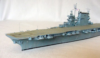

Finally done with the ship. There is more to do - deck vehicles & planes - but I have to clear the dining room table - taxes (which I cannot do on anything but an EMPTY table) and company next week (it is March in AZ).
I enjoyed this build. Sometimes you like a ship more after a build, sometimes less, this one was MORE.
Jim

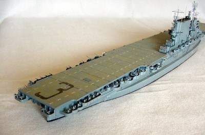

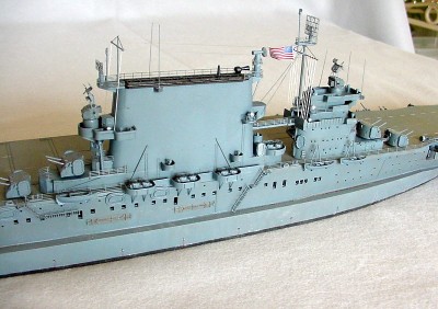

More photos.....

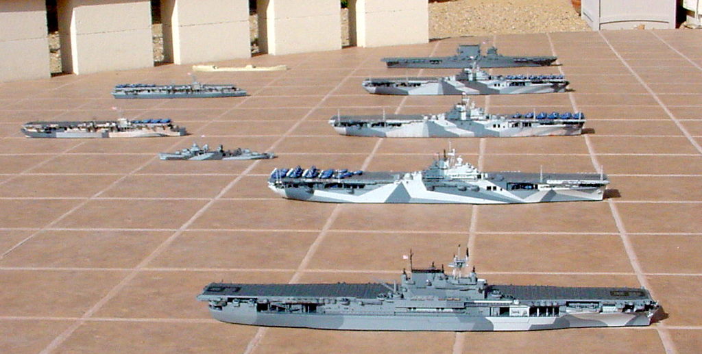

One last photo, this is as close as I am going to get.
I'll call it Murderer's Row version jr2009.1
The middle three ships are actually correct (from the front Yorktown, Hornet and Hancock). In front Enterprise replaced the Wasp and in back Saratoga replaced Ticoderoga.
