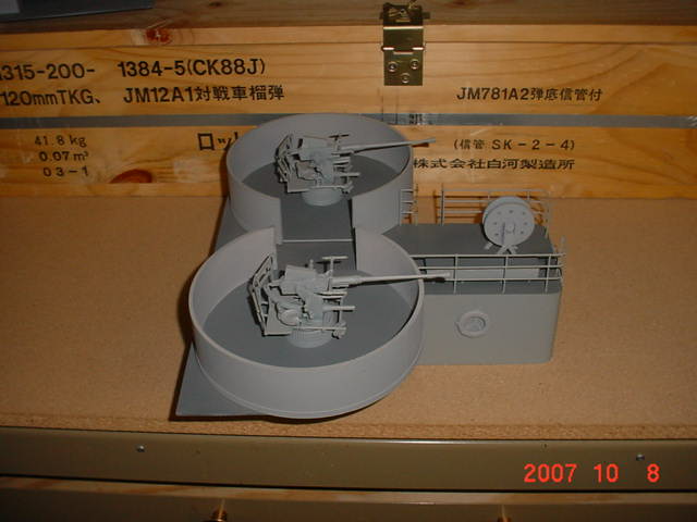

Dave, Thank you. The Motors are Pittman 3700's, wish I had a case of those now
Now from this point, decks had been installed and basic structures built. Minimal detailing and she went out for a run. I then did not wirk on her for quit sometime. After extensive research I decided to dig her back out and start in again. So far I have jumped pretty fast here but it is just to bring everyone up to speed with the project. I started my rebuild last winter with the 40 mm Guns. I had purchased the 40 mm Single Mounts from HR. Nice Mounts but not really what I wanted. 40 mm Twins is what she really needed. I had a Quartermaster 40 MM twin resin kit and a set of Drawings from Floating Drydock. I started with upscaling the Resin parts from the kit and making the pair of new Guns. This is where the refit and finishing has now started.

Hi Sweeper skipper Did you turn the barrels and what material have you used to make the 40mm gun mountings? Once again your build is excellent.
- SweeperSkipper
- Posts: 68
- Joined: Tue Sep 15, 2009 1:36 am
- Location: Washington State
Re: 1/24 Scale AM Minesweeper Scratch build
Dave, Thank you again for your Kind words.
I turned one Barrel from Brass stock and used it as a master for a Mold. I then cast up four barrels with Brass tubing inserts for strength (Help keep it from warping) For the rest of the Gun I used Plexiglass,Brass,Styrene and Wire for the springs as well as other plastics I could turn in the lathe. So far there is some 126 parts in each one and there not quit finished yet. I had made up some extra parts as well just incase I had a breakage and needed to do a repair or wanted a Template for another Build. I have to admit That when building these guns, I had just purchased a Lathe and have never used one before. It has been alot of frustrating fun!

Excellent looking build. I love the work on the 40mm guns. I am thinking about turning and casting my 1/72 3"50 cal barrels and your idea of the inserted wire rod is one I think I will borrow...
I would love to see more.

Thank you. I was using a new casting resin and was not sure how it might hold up. The thought of all that work only to have a Limp barrel really had me concerned. So a bit of Brass tubing solved that problem. An accidental second purpose then presented itself, I trimed the tubing a bit and used it as a pin to lock the Barrel to the breach. Always learning with this Hobby.

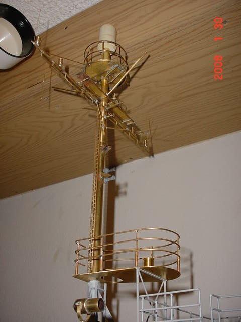

The next part that needed attention was the stern Winch. Not much detail out there on the piece of equipment. I had A few drawings that were genaric as well as a few photographs from angles. I had used the stern winch from the Dumas Kit MR Darby, Not evem close to the one required. The new stern winch is almost completed now. I am holding off on the rest until I can find more Documentation. Then I can fix any errors and Finish as needed.

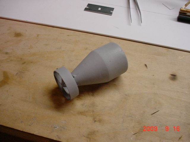

Moving along with some of the rework, Here are some before and after pictures of the searchlight Platform, Wow did I build a bummer here, Then once done I realized I had the floor plan Reversed
I corrected the problem with a removal and garbage toss, Searchlight to was junk so it followed.
I might Add that most of this work was done following very vauge Drawings. Most of the pictures I had were to small to see any detail. Then I found the internet and WOW, The information out there is, Well you know..........Out There. So between Bad craftsmanship and a lack of info, To a wealth of info and a few more years of experiance under my belt, Parts are starting to look a little better.

Thanks Dave and Reid.
The two things I was Happy about with the Ship before the rework were the Hull and The Mast. However The Mast as much as I liked it was not completely Correct. So since I was doing a refit I decided to Give the Ship A late War refit. A new Mast was needed. Here are some pics before and after. The new mast is still a work in progress. Not quit done with it yet.
