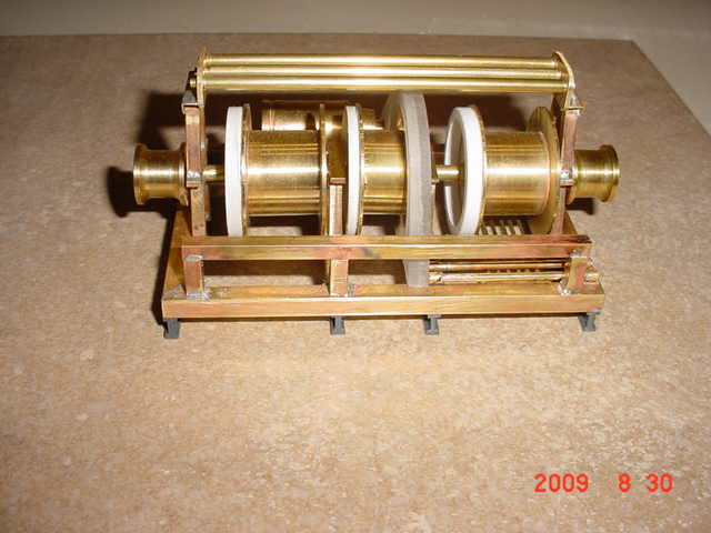

Thank you Jim, The kind words so far from everyone has been very much needed with this Project :big_grin:
The next part that needed attention was the stern Winch. Not much detail out there on the piece of equipment. I had A few drawings that were genaric as well as a few photographs from angles. I had used the stern winch from the Dumas Kit MR Darby, Not evem close to the one required. The new stern winch is almost completed now. I am holding off on the rest until I can find more Documentation. Then I can fix any errors and Finish as needed.

Now that's a fine looking winch... Really love these contraptions... As well as windlasses...
You mentioned in a preivous post that you purchased a lathe and that you have never worked with one before...
How difficult was it to achieve a satisfactory result? Though from what I see it was worth the effort...

It was intimidating at first, I kept wondering if I had just blew my Money. Once I had it all set up I just dove in. I approached it like Flying, Small corrections. I started with making Running Gear for a boat. Turned out not half bad, I just took off small amounts at a time until I had a feel for the Metal. Sounds kinda strange but it does come quick. I have to admit, Building in scales that were more popular enabled me to buy scores of fittings. Building in this scale is a bit different. For the most part if I want it I have to build it. Getting the Lathe has really enabled me to do a better job on this build. Honestly I don't know how I survived without one. Next on my list is a Milling Machine :big_grin: I find that I can cut a great many things in the lathe, Brass, Plexiglass, Etc. The other day I wanted to make an acoustic Sonar for the Sweep. I did not have any material large enough so I took a piece od 1.5" PVS pipe and filled it with Bondo, (An auto Body filler) As it dried it shrank just a bit and I pushed it out of the PVC pipe. Put it in my Lathe and Bingo, I machined my part. It Machined so free and easy I might just use the method again. Here is a Picture of the Sonar Bondo experiment. Not bad, This one I wont keep but I will do another now that I know the idea is workable.

Hi Sweeper Skipper . That winch of yours is a trully fine piece of workmanship. Yes the lathe is a very handy toool and you can do so much with them. I notice also you make use of Bondo , now that's part of my own tool cabnet , although its goes under a different name in the UK the material does the same job. Larger models lend themselves well to "working Features" do you intend to have any of these? Great craftmanship and thanks for taking the time to post up your photos. Always appriciated .

Hi Dave, Thank you again, and I am pleased with the winch so far. You had asked about operating features on this Boat. You are right with a Model this size it affords the ability to make operational just about anything that you want to. Of course Lights being one of them. Under the Bow I have a geared Motor with about 15' of anchor chain. I made a switch from a servo that reverses polarity to the motor allowing the anchor to go up and down. The anchors are solid brass and have a good weight to them. I have also left a space between one of the drums on the winch, I need to machine a pulley for that space and I will have a geared Motor under the deck with a belt to the pulley to operate at least part of the winch. Guns will be made to turn as well, However my favorite feature that is still in the works are my K Gun's. Up under the Bow I have made a 12 Volt Air compressor with a 12 Volt pump for airing up car tires. Borrowing some technology from the combat ship modelers, I will use there air firing Valves for there Guns to fire the Depth charges from the K Guns. Bench tests so far will shoot the depth charges about 3 ft to each side of the ship. One of my best finds was a Power distribution panel from Harbor Models here in the U.S. Picture of that below. It takes the power from the main battery and supplies your main drive motors as well as breaking it down for other features. It also eliminates the need for a small receiver pack. This boat is large enough that I use a Truck Battery for Power. Now for a Model this is like a Nuclear power plant. I can run this boat all summer long with out the need to recharge anything. :woo_hoo:
