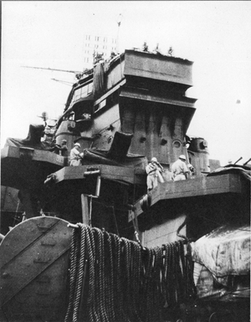

I am very certain that that all the indicated positions are of lookout binoculars, probably 12 cm. As Jose's fine model shows, the positions atop the bridge are part of the AA control platform that is typical of late war ships. Search binoculars are consitent in this position. I concur with Joese's assessment of the lack of late war Maya photos. Attached is the only one that even show the AA control positon to any detail and it is taken from below.
Kym, I believe we have the same source for that information. I have been curious if what was planned was in fact executed by the production dept.
