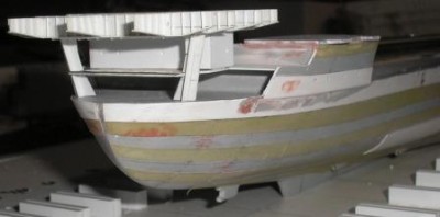

Okay, I did a mock-up. Stills needs a bit more detailing, like the horizontal bars, but so far it fits well. Hard to tell, but towards the top, the main bars change direction and go straight up.
Comments? Good enough?

Bump so all the Yorktown carriers are at the top :woo_hoo: :big_grin:
I circled in red the forward rear supports. I can't find any more clear pictures of them, perhaps someone can help me figure out what they look like? Its hard for me to tell, so I dont know how to produce them...

Thanks, Ive been using it a lot, but was wondering if there was a picture of it. The drawings show the farthest rear beams as straight lines, but in the above pictures you can see the differnt angles they have. Ive since gone back and somewhat correct these beams...

Posts: 708
Location: Seattle Area
DavidP wrote:
JTninja, which support are you doing, the vertical post or the double post that is angled outwards?
Im working on doing both, still need to make the vertical support, the double is posted above. I stopped working for a bit since theres been a lot of work around the house, the only thing Im working on is my Indy thats being built on a board game box in the living room :heh:
