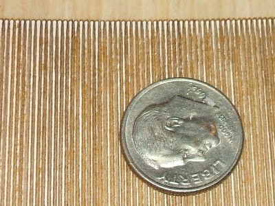

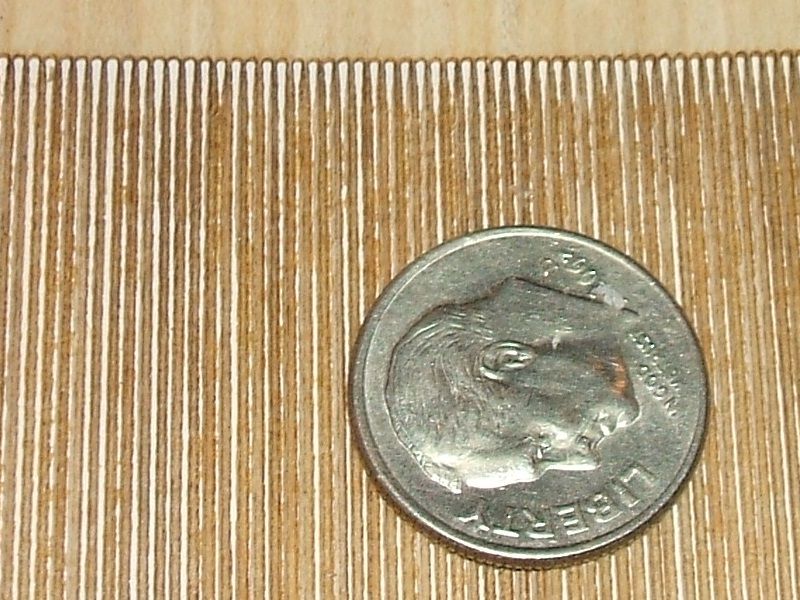

I wanted to give you all an update on a side project that I have going on, and that's a test of Laser-Cut Planking. I am hoping that I can get a system in place where I can provide sheets of planks that can be custom cut and laid down by the eaches. These would use the same incredibly thin, thermal fleece backed wood as my standard cut decks.
The first test was promising, but wrong. Just for a starting point, we placed the laser cuts as far apart as our printed plank lines, and you can see the result here. The laser cut is a LOT wider than our print line, leaving very little plank to work with! So we're going to have to space those out quite a bit. Also interesting is the wider cut at the ends of the planks - since the laser is not up to speed when it starts a line, it burns hotter and wider... So we'll have to accomodate for that, too.
We're working on it, and I'll send more updates as progres is made.

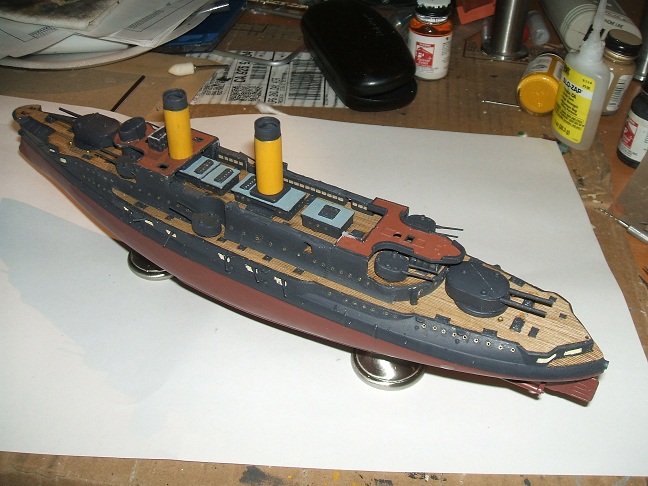

I wanted to provide some update shots of where I am at on my Borodino. I now have both decks glued down (All three if you count the walkabout!) and they fit really well. I tried Gator Grip for the lower two decks, and it worked pretty good; I had a little bit of peeloff here and there, but I was able to inject a spot of glue under the deck with a syringe (the Gator Grip folks sell those, and they are HIGHLY recommended! :thumbs_up_1:) and that fixed the problem straight away.
For the upper deck I tried to use Testors Liquid Cement, and that was drying faster than I could coat the deck. So I ended up using regular Testors Red Tube glue - spreading that around, and that worked really good, too. It provided a good amount of tackiness and some stiffness combined with slow drying times. Much better that the liquid cement for large pieces.
I have also learned that the Borodino kit is... Umm... interesting. It is a very tricky ship with lots of things connecting to other things, and I don't think it is very well suited for staged building. What I mean by that is on a lot of ships, they are just like layer cakes, and you can work on different sections of superstructure and then just stack them all up when they're all complete.
The Borodino has lots of things that connect through other pieces and onto the hull when you least expect it. I had a problem where the WEM brass had me cut some access hatches for ladders, but I put them too close to the edge and had them overlap a bulkhead that I had to install at a later stage. Ouch. (I was able to solve that by shifting the bulkhead over a bit - it's internal and not visible from the outside, so while I might have offended the Historical Accuracy Gods, I think I am okay with the Overall Aesthetically Pleasing Gods. (But judging from the CASF thread, the Historical Accuracy Gods are probably spitting mad over the Borodino kit anyway! :heh:) The trouble-making cutouts for the staircases can be seen to either side of the funnel. There is an outer bulkhead that you have to glue in place in front of the hammock stowage, so you need to be really careful to place that staircase hole between that bulkhead and the boiler room skylights. Interestingly, it leaves very little room for the crew to walk that passage with the staircase in there. Perhaps just another Borodino mystery...
And there were some issues of the angle of the tumblehome hull, and not using the superstructure pieces for alignment when I let them set, which was another mistake. But, apart from that, it's coming together pretty well.
I am very pleased, though, with the look of the deck. It doesn't get in the way of assembly and I am now seeing what I had hoped for - and that is that the various fittings and features break up the grain of the wood making it look much more like a scale deck. Once I add the brass railings, I think the illusion will be complete.
Here are some photos...
File comment: This is an overall progress shot from the bow. All of the turrets, stacks,and linoleum decks are just set in place.

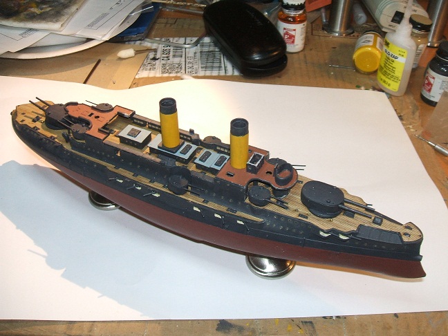

File comment: And an overall view from the stern...

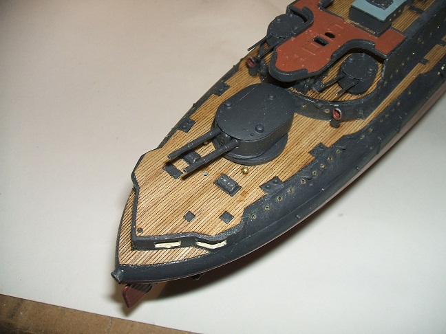

File comment: Here is a close-up of the bow. I think the edges of the deck look fine around the fittings. The outside edge leaves a space for me to attach the brass rails. AND, I love being able to fill and sand the deck/hull seam without having to worry about preserving the molded-in plank detail. That lets you really work the seams...

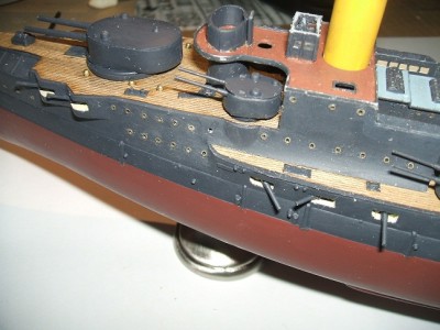

File comment: Lastly, I wanted to show a close-up of this area. The lower deck is actually placed under the upper hull, but it is so thin that it doesn't cause any alignment problems at all. The result is a super-clean edge between the deck and the tumblehome hull.
There are actually two separate hull pieces joined here, with the seam between the two under the drilled porthole without a brass ring on it.

Hi John- she's looking very good. I think the gray roofs are not correct- there seems to be a lot of that gray color in the instructions but not much support for it being correct. I painted mine black. But I painted my inner bulwarks white and that's controversial too.
I'm on the fence about wood decks. I haven't seen a set yet that I thought was worth the time and money to replace a plastic deck. If you make a go at this, I would suggest that you test market a little.
The biggest difficulty is overcoming the out of scale grain and fiber texture. I modeled for a long time in 1/160 railroading, where laser cut products really made a splash. After a fair amount of frustration I switched back to styrene for scratch building. And for finishing, there still needs to be a scale plank legth. The light/ dark running the length of the ship don't look right to me.
I look forward to seeing ideas of how to solve those problems.
