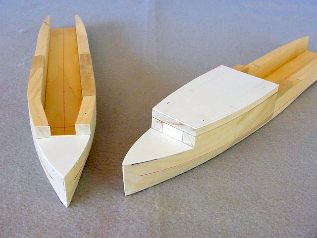

PostPosted: Wed Mar 09, 2011 2:58 pm
Posts: 379
Location: Peoria AZ
Pic 1 LSDs, plans came from HSNA see link http://hnsa.org/doc/plans/ . Using "magnification %" on the top menu and "current view" in the Adobe print menu you can print any scale you want. If anyone needs a more detailed set of instructions, let me know and I will post them.
This is a "fun" hull to build. The well forces you to operate in 3 dimensions (the assembly has acoustic properties) and the knuckle (seen best in pic 6) is an absolute challenge (it twists from 20deg at stern to 80deg midships).
jim

PostPosted: Fri Mar 11, 2011 10:14 pm
Posts: 379
Location: Peoria AZ
Rich, I will run an exercise on the LSD. The first step is to determine a known dimension. I picked LOA (length over all) because the longer the reference length the greater the accuracy. LOA = 457’ 9” = 5493”. 5493”/350 = 15.69”, this is the length wanted for a 1/350 plan.
Go to page 3, the side view, the magnification % when opened was 25% and the entire ship was in view. Since I will be printing in landscape, which has a max of 11” of paper available, and the plan I want will be 15.69” long I will need to “tile” two pieces of paper to get the correct size plan. I increased the mag% to 40% and the ship got larger and no longer fit on a single sheet, this will do far a start. Will now print the first trial, hit the Adobe print icon. Move the bottom slide bar so that you see the aft 2/3 of the ship.
Print range
**Current view** - the picture in the print menu should now match the screen
Properties
*Setup
**Quality – best
*Features
**Landscape
*Advanced
**Grayscale – black only
OK for set up
OK for print
Move the slide bar so that you see the foreword 2/3 of the ship and repeat the print process.
Tile the two pieces together, one has to be cut so that there is an edge to match. Measure LOA – I got 13.22” so the mag% is low – we wanted 15.69”. Set up a ratio…
Test mag% / test length = wanted mag% / wanted length
…40………/…13.22… = ……x…………/…..15.69
…………….(13.22)(x)..=..(15.69)(40)
………………13.22x…= 627.6
………………………x=47.47, reset mag% to 47.47% and repeat print and tile process.
I got a LOA of 15.62”. Repeat the ratio calculation
47.47 / 15.62 = x / 15.69
x now equals 47.68%, print and tile once again.
NOTE you have to do this exercise for each page, some use the same mag but others do not. Be sure to mark the mag% on the pages as they are printed and discard the “wrong” ones.
jim
