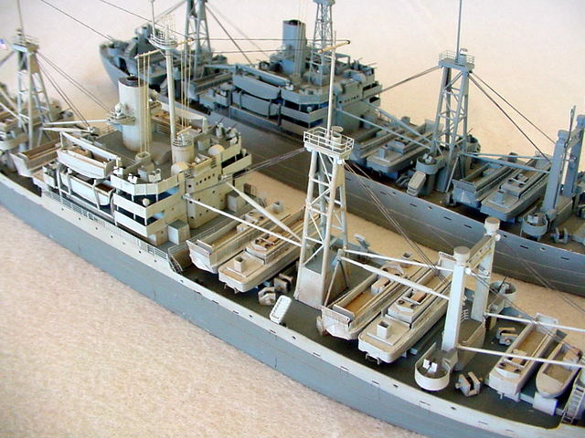

AKA 88...USS Uvalde is done. Of all the the merchant hull conversions completed on this "campaign", I like the "looks" of this ship the best. Pic 4 has a comparison with the AGC, same hull, different job, a totally different look.

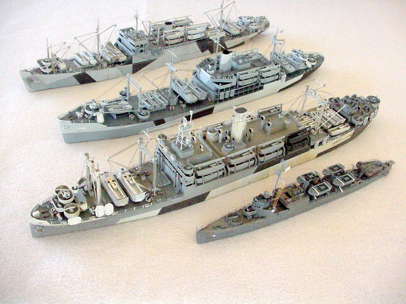

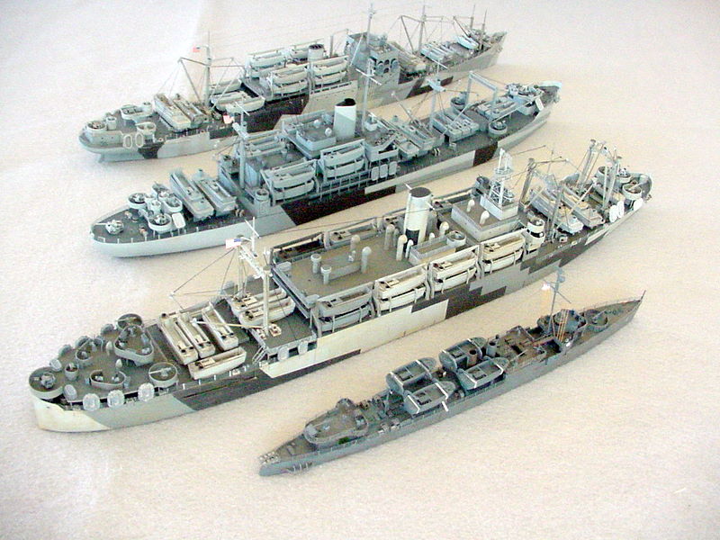

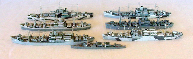

Pic 1 AKA-53, USS Achernar is done
Pic 2 Batch 2 Achernar with near sister batch 3 Uvalde. Differences include pole vs lattice tower for the midships radar, LOTS more portholes and fewer 20mm.
Pic 3 What is completed so far for invasion day 1 fast assault ships, AKAs, APAs, an AGC and an APD.

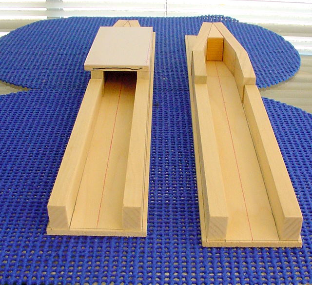

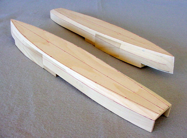

Pic 1 LSDs, plans came from HSNA see link http://hnsa.org/doc/plans/ . Using "magnification %" on the top menu and "current view" in the Adobe print menu you can print any scale you want. If anyone needs a more detailed set of instructions, let me know and I will post them.
This is a "fun" hull to build. The well forces you to operate in 3 dimensions (the assembly has acoustic properties) and the knuckle (seen best in pic 6) is an absolute challenge (it twists from 20deg at stern to 80deg midships).
