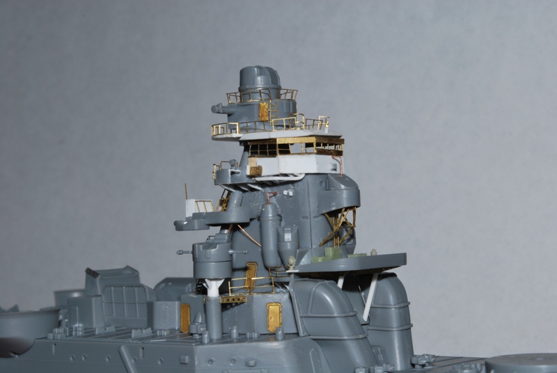

Hi fellows, i've been a little busy with a few things but i'm hoping to get back to this model next week and do the most i can on it since i start school once again in 2 weeks here is some of the process on the Tone's bridge:
i took all these shots before i primed the structure, if you'd like to see it you can always go to the Tone section on "Calling all ship fans" i'll take fresh new shots next time
