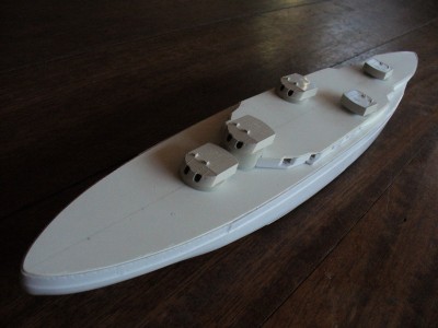

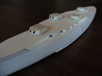

I can report some progress with my 1:350 ICM kitbash project: SMS Friedrich der Grosse is taking shape nicely.
After I made oval inserts for the submerged torpedo tubes in the right locations, I was ready to fix the deck. The Kaiser had a slightly less freeboard than the Königs, so after I took 1.5 mm off the rim of the hull, I fixed new strips to support the deck at the right level.After adding a layer of Evergreen 2020 v-grooved material to the deck I was ready to cement it in place.
Then on to the forecastle deck: I carefully copied the shape from the drawings (thanks, Dreadnought Prject!) onto another sheet of Evergreen 2020, an cemeted it to a layer of plain 0.5mm sheet. Then a nice puzzle started: taking the battery walls from the kit I juggled with each individual 15 cm gun emplacement, modified or not, to have it fixed nicely below the forecastle deck. In the end you end up with a large gap at eiher side, to be filled in with plain Evergreen strip. I leave the detailing of the walls for later.
Then a quicky: measuring out the right locations for each of the main gun barbettes, and drilling a hole to receive each of those. I put the five trrets in place just for the pictures: of course these need to be detailed also slightly different from the kit versions.
Enjoy the pictures!
Maarten

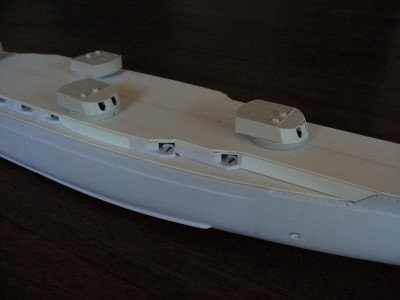

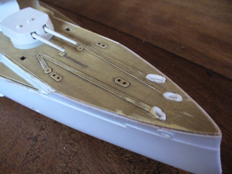

Hi Kaiser fans,
Time to give you an update on my 1:350 Friedrich der Große project.
I added the walkway (cat-walk?) between the superstructures, the anchor cable runs, both from Evergreen strip of 0.25mm thickness and various width. Further I cut out the openings for the many hatches/staircases, and marked all the places for bits and skylights.
Then I was ready to paint the deck, using my preferred method of a base colour of (in this case) Humbrol 103, followed by a wash of artists dark brow oil paint, which was wiped off immediately again, leaving thes seams between the planks dark and tinting the planks themselves nicely. (note: I need to touch-up the planks near the bow).
I also added the basic structures of both superstructures, which need to be detailed further: first step will be adding all the louvres for the boiler room ventilation.
Until the next stage :wave_1:

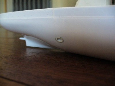

PostPosted: Fri May 24, 2019 12:51 am
Posts: 1813
Hi Chuck,
The photo you showed is from the Bayern, under tow in April 1935 by the Dutch tugs 'Zwarte Zee', 'Witte Zee' and 'Ganges', just before passing the Firth of Forth railway bridge on their way to the shipbreakers yard in Rosyth.
The Bayern had spade type rudders, slightly angled outwards, as is in the ICM kit. These rudders were pioneered on the König class.
The Kaiser class though had twin conventional rudders, sitting vertically and being lead by a small skeg.

PostPosted: Fri May 24, 2019 10:12 am
Posts: 1813
And here the side view of the stern of SMS FdG, from the plan in 'The Dreadnought Project'. Clearly not the spade rudders of the König or Bayern classes. Unfortunately the stern section views are missing, but I'm pretty sure these rudders were vertical, and not canted outwards.
And a picture of the rudders and screws of 'König Albert'.
