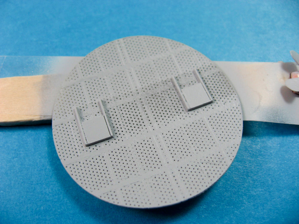

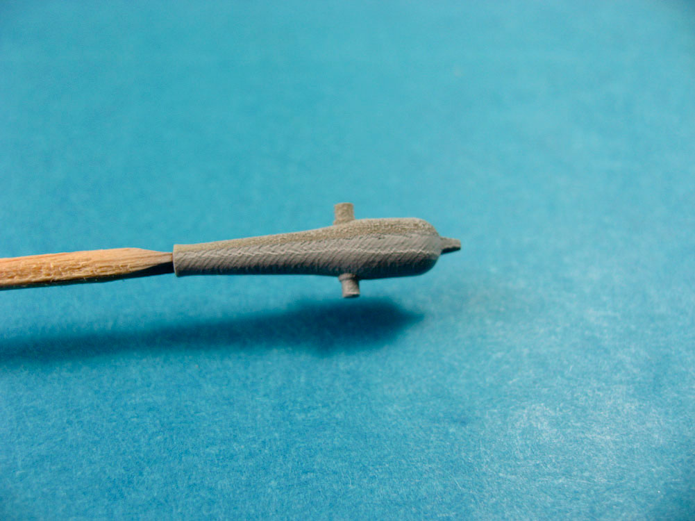

Okay, here's what we're working with. Initially I thought the printings to be flawless, but as they come in that translucent/clear medium that Dean showed with his test turret image, it's hard to see exactly what's going on until you get some primer on them.
- Devin

Now on to the turrets. They're a mixed bag. The limits of the printing process for smooth cylinders show here as they did on the Dahlgren. One note: when these parts arrived they had a slightly oily texture. I soaked everything in Simple Green for an hour, then tooth-brushed them and rinsed. Then most of the parts had a stickiness to them, kind of like uncured resin, or paint that hasn't fully dried. I brushed them down with lacquer thinner and they were then fine to prime.

So that's it. I'm really happy with how this stuff turned out. Of course it would have been great not to have to deal with replacing bolt/rivet detail on the turret, but that's a small price to pay for the work the props, turret roof, and guns will save me. Great work, Dean!

That turret does look rougher than the one I have. Is that material or primer between the rivets?
Because the one I have doesn't look like that, even the interior on mine looks smoother. I'm wondering if the simple green or lacquer thinner didn't soften or melt the plastic some, because it looks like some of the rivets were mushed too.
If you want, I can send you the turret I have, I'm not going to do anything with it anyway. You can use it to replace that one or as a spare.
With the cannon, except for the steps, the shape does look pretty good, it just sucks that it didn't come out smoother. It definitely shows the limits of printing small stuff.

I looked at the other turret I have, and wouldn't you know, that with a 50/50 shot, I picked the one with the problems. The other one looks really good. I'm sure it isn't primer, I use Mr. Surfacer and that stuff doesn't build up or flake like other stuff, plus if it had then the roof and props would have shown the same results.
I'm surprised the gun turned out as well as it did, considering neither of us knew if it would even work at all!
