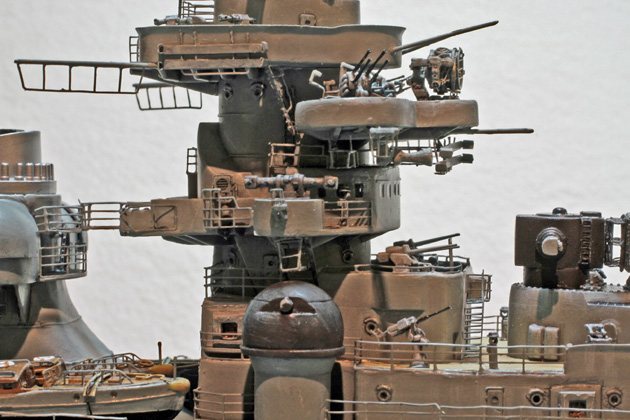

Bridge levels

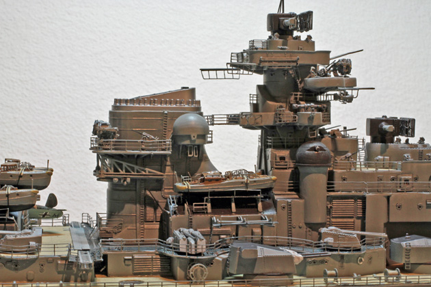

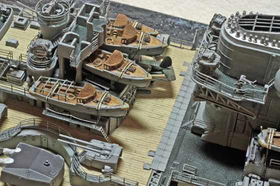

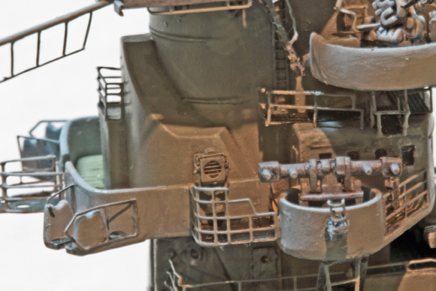

funnel area

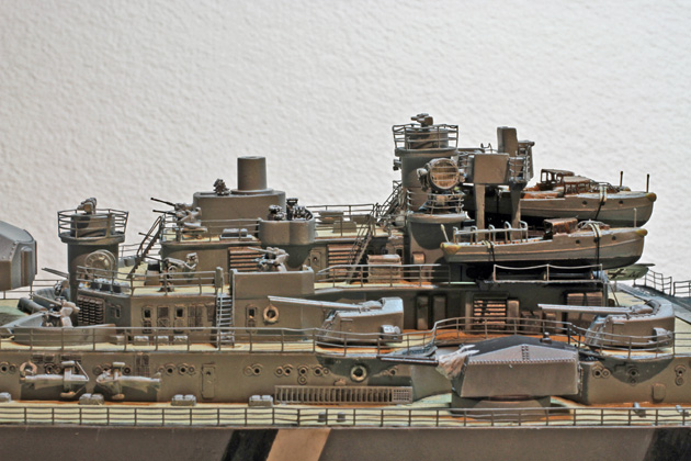

rear superstructure

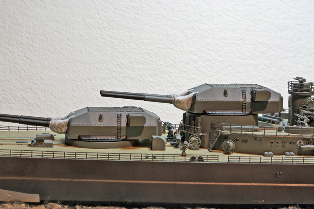

C & D turrets

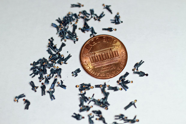

A goodly number of L'Arsenal and Goffy figures had to be painted. I felt as if I had to paint ants!!!
From the left, 2 L'Arsenal figures, 2 Goffy figures, a Fujimi plastic figure and a pre-painted Pit Road figure for comparison purposes. The resin ones are undoubtedly finer, but definitely more expensive, as you have wastage with arms and legs breaking off.

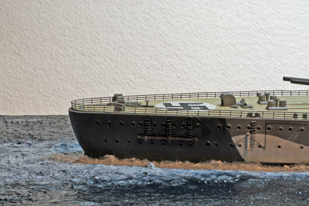

The Bismarck, at the time i am depicting her, did not have a bow flagstaff. This made me wonder how the railings should end at the bow, if not tensioned/supported by either the flagstaff or a stanchion at the curve of the bow. I concluded it would be more realistic to finish them by having a diagonal chain/cable from the last stanchion to the deck.
90 Bismarck MW.JPG (42.51 KiB) Viewed 3511 times
94 Bismarck MW.JPG (44.77 KiB) Viewed 3508 times
The flags were sourced from the new Hawk Graphics Kriegsmarine flag set. The decals were placed on lead(?) foil from a wine bottle to they could be bent to simulate fluttering in the wind.
95 Bismarck MW.JPG (36.55 KiB) Viewed 3508 times
A custom namepate was added to the base
96 Bismarck MW.JPG (58.02 KiB) Viewed 3508 times
And in rough terms that was it. A very enjoyable but also stressfull build. Aren't they all?
