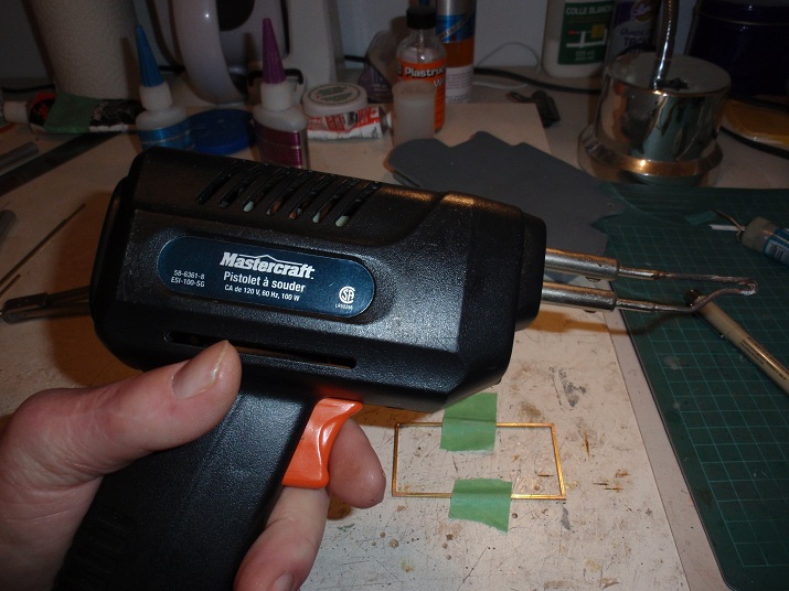

Hi Russ Very sharp solder work indeed . Question what type of soldering iron and flux do you use ?.I ask this question as I find that the type of flux can have a bearing on how the paint reacts with the finished fitting . In the past I have used Bakers fluid which is superb but it contains acids which are hard to remove completely and can have an effect on the painted surface long after the model is completed. I've long since changed to a paste. Have you tried solder paste which is a solder in paste form which can be painted on the joint then soldered together. I have found that this is great for fine work but not really suitable for substantial parts.
:thumbs_up_1: :thumbs_up_1: :thumbs_up_1: :thumbs_up_1:
PostPosted: Mon Jan 09, 2012 11:05 am
Posts: 1173
thanks for the intrest guys.Dave i use regular solder and paste flux,i have smaller solder guns but i find myself useing a big trigger type gun more and more.i got tired of waiting for small irons to heat things up .the only thing is it seems to foul up the tip quite often.but i keep a wire wheel on my dremael to shine it up. i would like to try paste solder but so far i have not ran across it over here.to clean up the parts i wash then in lacquer thinner then soapy hot water.

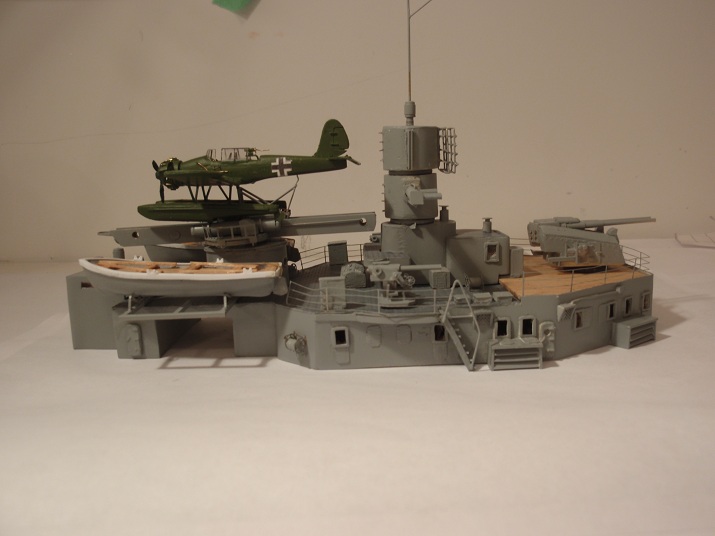

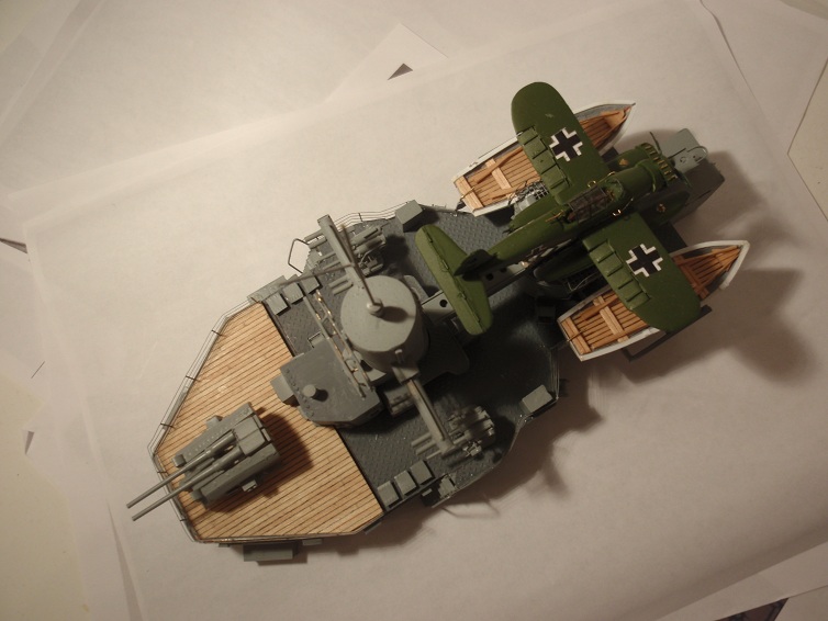

funnel is done i think,one never knows as the more you look at things somthing always shows up :big_grin: .i see in the pics i need a little paint touch up.

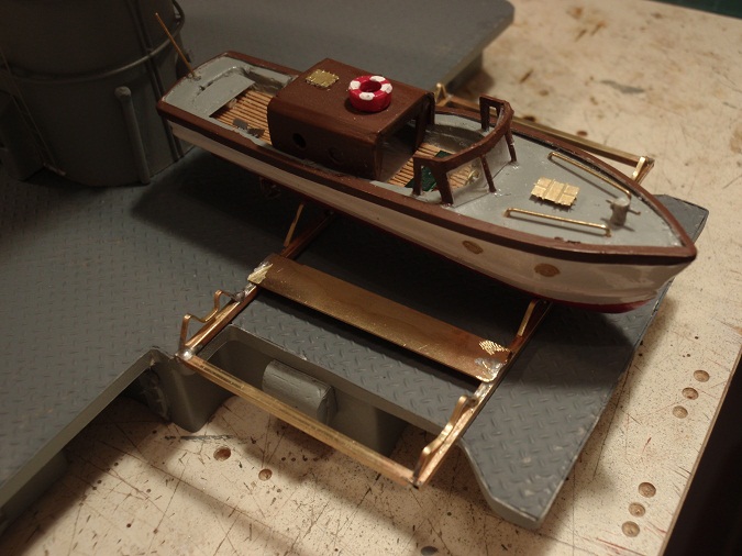

as i was in the soldering mode i built the baot cradles also.
File comment: this is the beast i use for most of my soldering,lots of instant heat.
File comment: cradles by the catapult, and between funnel and front superstructure

Hi Russ Working in brass strip for the boat supports certainly produces excellent results .
