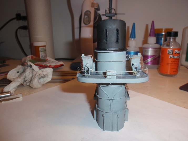

Hi Russ Very sharp solder work indeed . Question what type of soldering iron and flux do you use ?.I ask this question as I find that the type of flux can have a bearing on how the paint reacts with the finished fitting . In the past I have used Bakers fluid which is superb but it contains acids which are hard to remove completely and can have an effect on the painted surface long after the model is completed. I've long since changed to a paste. Have you tried solder paste which is a solder in paste form which can be painted on the joint then soldered together. I have found that this is great for fine work but not really suitable for substantial parts.

thanks for the intrest guys.Dave i use regular solder and paste flux,i have smaller solder guns but i find myself useing a big trigger type gun more and more.i got tired of waiting for small irons to heat things up .the only thing is it seems to foul up the tip quite often.but i keep a wire wheel on my dremael to shine it up. i would like to try paste solder but so far i have not ran across it over here.to clean up the parts i wash then in lacquer thinner then soapy hot water.
PostPosted: Tue Jan 10, 2012 4:05 pm
Posts: 1173

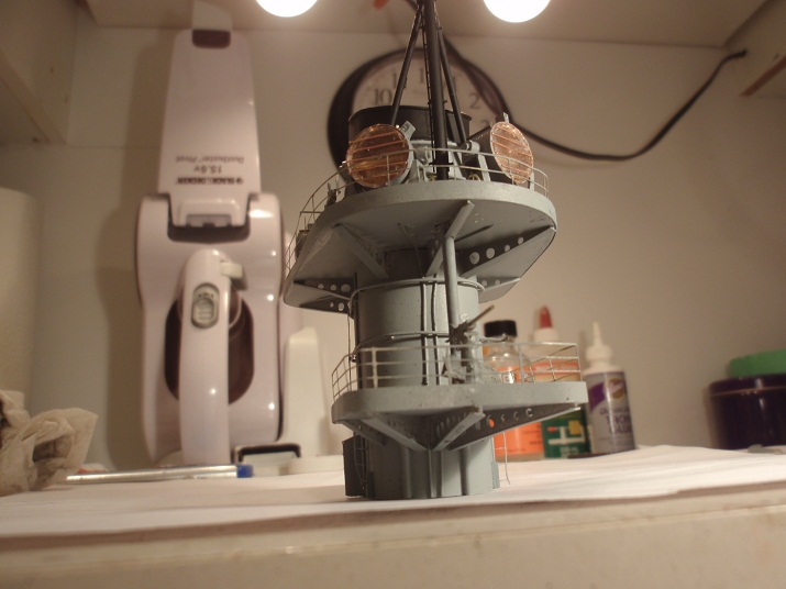

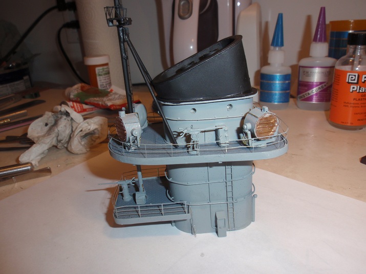

funnel is done i think,one never knows as the more you look at things somthing always shows up :big_grin: .i see in the pics i need a little paint touch up.

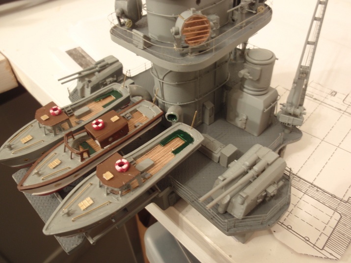

PostPosted: Thu Jan 12, 2012 9:05 am
Posts: 1173
as i was in the soldering mode i built the baot cradles also.

Hi Russ Working in brass strip for the boat supports certainly produces excellent results .

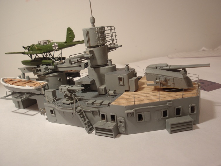

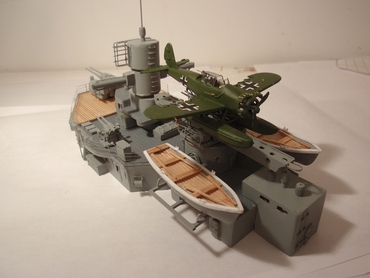

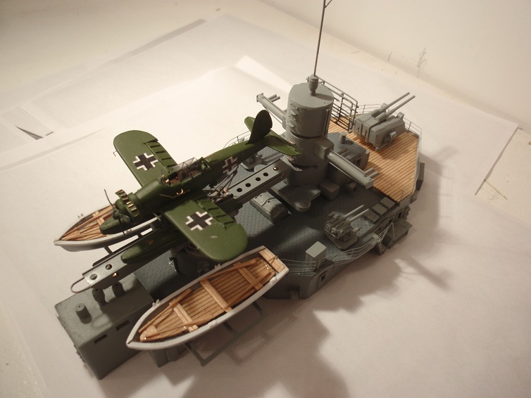

thanks dave,the boat deck,funnel area is finished except for rigging.the crane may look a bit wonky as it will sit down into the hull when the module is mounted on the ship.

Nice unit .Looks like a model in itself ! Clean solder work . :thumbs_up_1: :thumbs_up_1: :thumbs_up_1:

Hi Russ All the fine detail when brought together really refines the model superbly well .

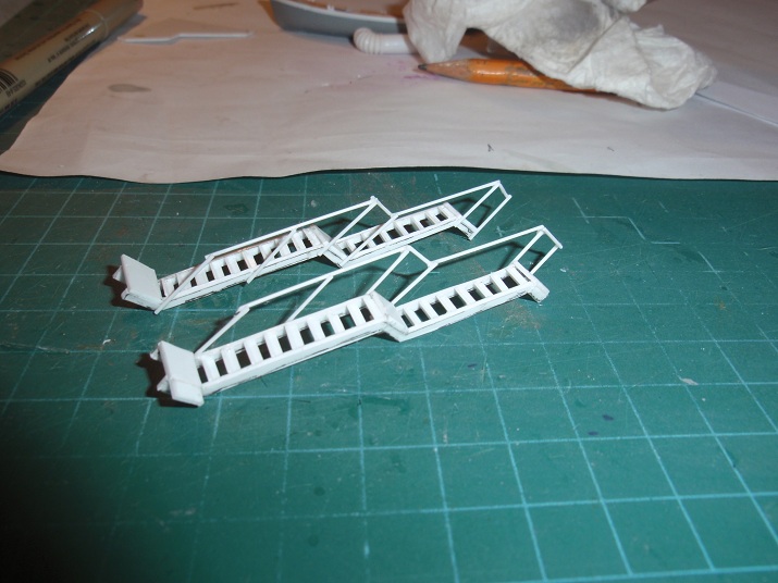

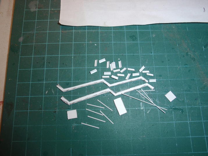

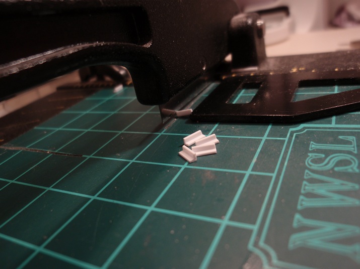

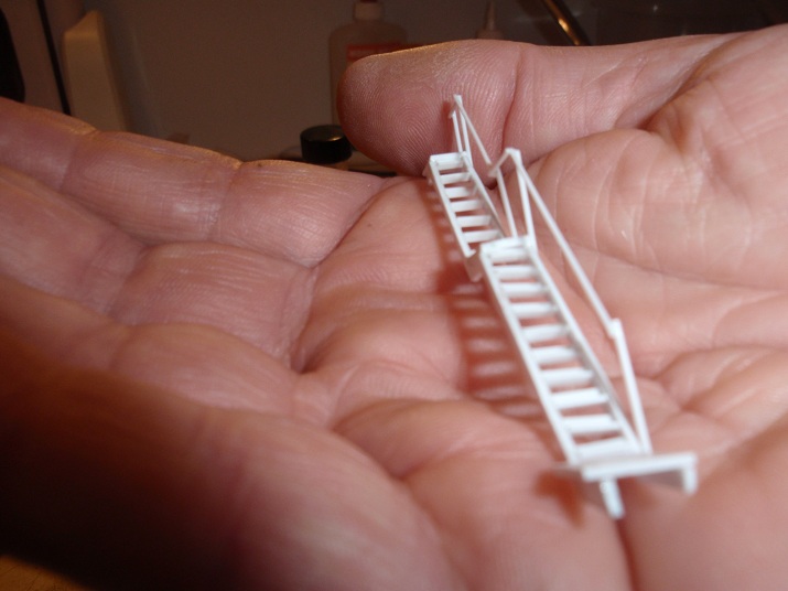

thanks dave,richard.time to build the boarding ladders.they are built from styrene,again my chopper came in handy for cutting many small treads to the same length.there are lots of them as there are 4 boarding ladders,2 long and 2 shorter ones at rear.
File comment: i made a paper jig to make sure i had the right angles
File comment: one side of the ladder frame
File comment: all the pieces for one ladder
File comment: cutting all the treads on the chopper
File comment: two finished forward ladders
PostPosted: Mon Jan 16, 2012 6:42 pm
Posts: 2557
Very nice Russ. :thumbs_up_1: :thumbs_up_1: :wave_1:
Simple but effective.

It's very good tip ,paper jig for ladder!

Neat stairway to heaven ! :headphones_2: :thumbs_up_1: :thumbs_up_1: :thumbs_up_1:

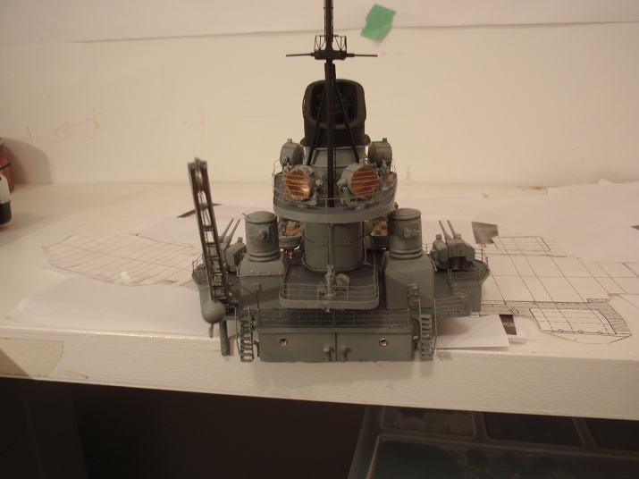

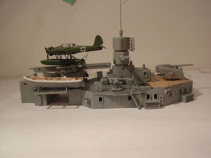

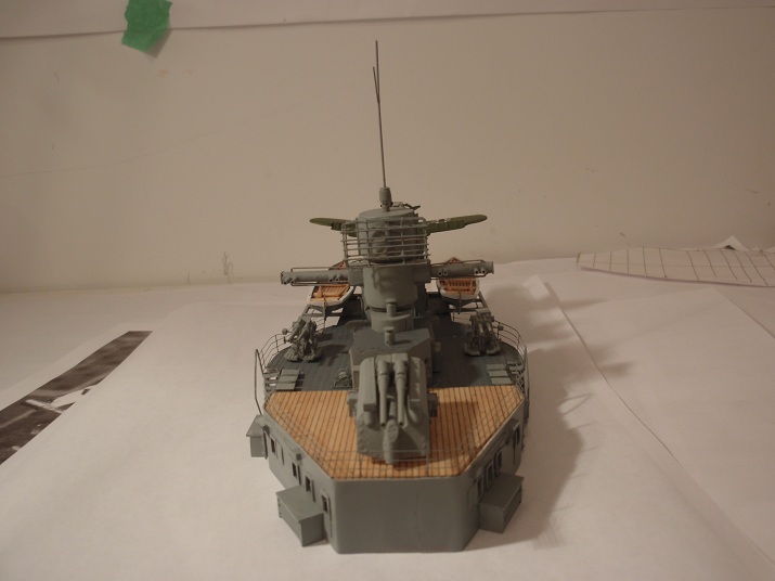

thanks song,jose,richard ,admiral.the back stucture is now finished,finely got my camera fiqured out,the color of these pics is right.some of my pics where coming out to blue.here's some pics.sheer is getting close to being done.

Hi Russ I very much like the method you have for making the stairway , I shall take note !!! By the way my good friend Jonathan Evans from Bradford Ontario produces a number of superb hulls of modern RCN warships and fittings , all 1:72nd scale .
