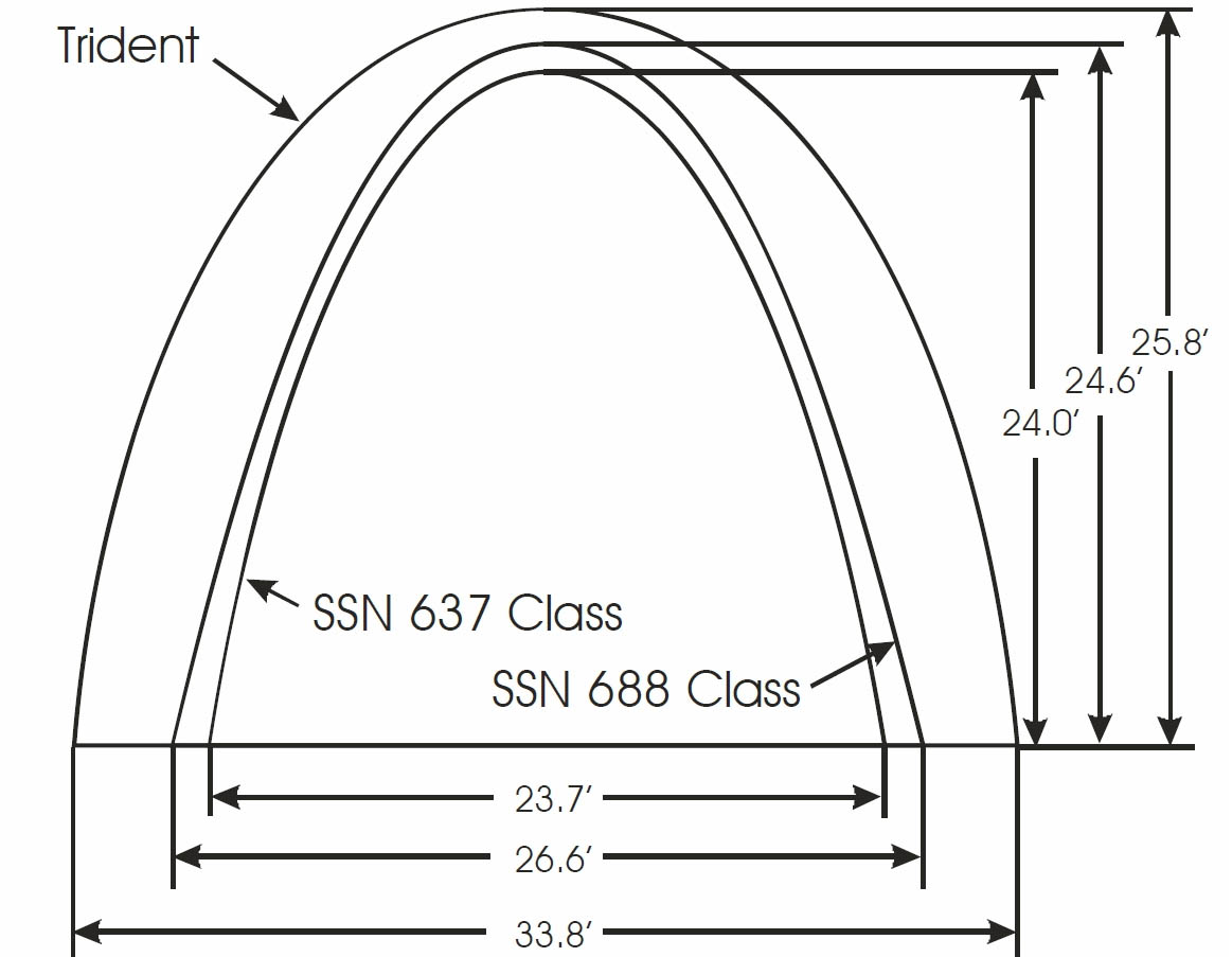

Here's a handy Bow Cap Template for several classes, including the 688s. That should allow you to compare the two models.
Bow shapes
Bow shapes

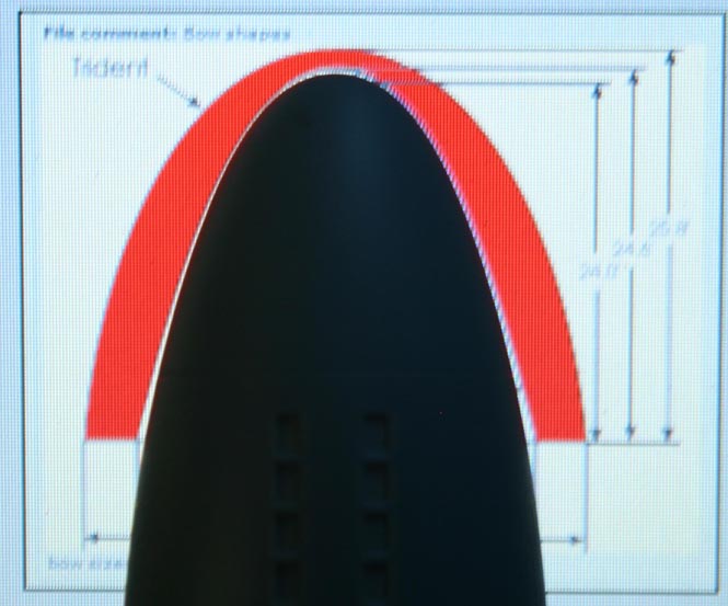

OK, let's post some figures and see what everyone comes up with. Tom; a question; the "Bow cap template" means that this is the dimensions of the non-metallic nose cone, yes? I wanted to clarify that in case the following assumptions are wrong.
I took a screen shot of the graphic and resized it a bit until it was close (slightly larger) to the same size as the Riich kit, which I have (don't have the Hobby Boss yet). Eyeballing it shows it's pretty close... perhaps a touch narrow forward, but perhaps only by a scale foot or two on each side for about 10-15 scale feet. End of the cone on the drawing matches the kit. However, that's all visual inspection, with perspective error and no guarantee that I actually scaled it correctly.
Converting the imperial measurements to metric, I get 7498.08mm for the length and 8107.68mm for the width, which scales down to 21.42308571 and 23.1648 mm respectively. Annoyingly, my calipers have disappeared. At the aft edge, the engraved line for the cone APPEARS to be about 23.5mm wide versus the 23.16 it should be... I think I can forgive this. However, the engraved line appears to be about 1.5mm further aft than it should measure. Can't quite rectify how the extreme aft beam appears correct but the length doesn't... probably just improper visual line-up on my part.
I'd call it close at this point. I'll keep an eye out for my calipers or buy another set this weekend.

hrmmm. using the image I compared the hull shape would seem to be off, however in the drawing the sides of the cone seem rather flat towards the point where they join the hull wouldn't you say? And when looking at the bow in photos, it doesn't look that way. It's more of a gentle curve like the 637 class in the image. And that's what the Hobbyboss kit seems to be matching.
And before we get too crazy, "non-metallic nose cone" should be clarified, as I'm a noob and don't understand everything yet.

Here's the picture I shot last night... the red is a flood fill between the Ohio and the 688 class profiles to make it easier to see the 688 profile:
Note that this is slightly over-scale just to compare.

hrmm looks like I should invest in the Riich Model kits......if it lines up that well, I should get one and compare the two. Thanks for the comparison.

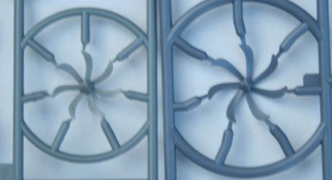

It looks like the ring also allowed them to completely re-profile the blades as well; more paddle and less scimitar.
Hobby Boss blades on the Left, Riich on the right.
HobbyBoss to the left and Riich to the right. I don't think either looks right; in fact, the old Dragon prop looks better to me.

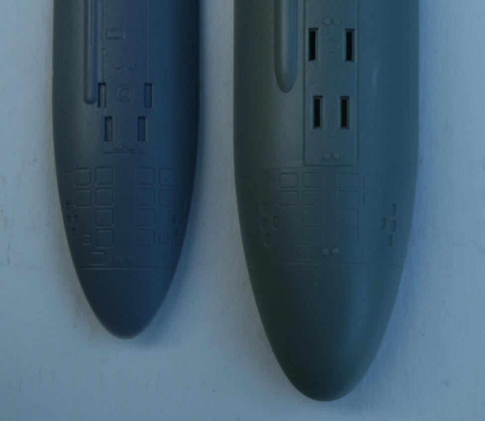

I had a harder time making this one "fit." It looks like it's a little too flat at the nose and doesn't flare out enough aft. Really, both look good to me. It's a tube with a rounded bow... not that difficult, and the lines look right to my eye, which admittedly has not spent years looking at the things in drydock... so I'm uncalibrated. :big_grin:
However, using Tom's drawing and my conversions, we can take a wee bit of a look at shapes and other details. The sonar dome aft diameter is 26'6" and "Cold War Submarines: The Design and Construction of U.S. and Soviet Submarines" By Norman Polmar lists the hull diameter as 33'.
That translates to just over 23mm (23.1648mm to be precise) wide at the aft end of the sonar dome and 28.73mm in 1/350th scale.
I get 28.58mm beam and 23.64mm at the end of the sonar dome on the Hobby Boss kit. Seems close enough, but the sonar dome should be about 21.5mm long, and I measured mine at 19.86, which is ~22.6 inches, or just under two feet two short.
Anyone feel like re-scribing a ring on a compound curve for less than two scale feet? :crazy:
On to the Riich model. 28.74mm on the beam and 23.45 at the end of the sonar dome, which was 22.30mm long, or just under a scale foot too short.
Either way, we can't use the kit sonar domes to really accurately measure shape, and we're only off by a scale foot or two here and there anyway. So now let's compare the bow details a bit:
Riich above waterline to the left, HobbyBoss bow to the right.
I lined up the nose cone break as a convenient reference point. Note the HobbyBoss kit has the retractable bits spaced further apart. I don't have the time to go through the Navy Image gallery to decide who is more correct in this.

BTW, the skew on the kit blades both look less extreme than they should for an early 688. Look at the small photo above. I'm also not sure if the skew angle changed; that may be a kit thing and not reality. Those blades were made based on actual acoustic data, very sophisticated computer models, and very large CAM equipment. I notice there is something missing on the propellers as well, but that's another story...
