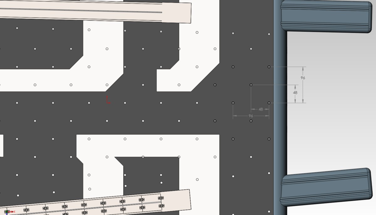

1. Anybody knows what's the diameter of the tie downs on the deck? I'm doing some Corel drawing and will do the Photo Etched tie downs, I've done the tie down in 1mm (would be 35cm in real life), is that correct?
2. I heard that Tamiya put the tie downs too far apart one from each other? correct? I read that the tie downs should be apart 1,8 m fore and aft and 2,3 m port to starboard, is this correct? Anyone know the approximate number of tie downs on the deck and hangar?

As near as I can tell the tie downs are 6 inches in diameter and are on a grid approximately 96in x 96in apart with an interstitial tie down in the center of each grid box (i.e. offset 48in x 48in from the corner). That pattern repeats almost the complete surface of the deck. However near the edges, the equipment, and the elevators it gets cockeyed in order to fit tie downs in.

So the distance that are you talking about is this or ?

More along the lines of this:
There is one row down the centerline of the ship set back 12 inches from where the front end starts to curve down. That's where the gray starts and the black deck material stops. The other tie-downs are spaced off this row down the centerline.

wow. thanks for that. Do you maybe have the layout for all the deck or just this photo? It would be of enormous help

No I wasn't able to map the entire thing. I only did this section as an example to Dragon.

so that's a photo of the dragon 1/700 kit? maybe the tie downs there are positioned correctly so I could use that as a reference?
