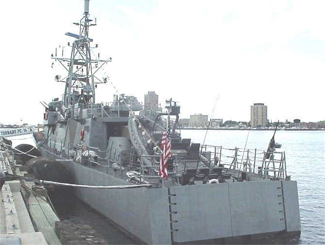

This is a standard USN 7m RHIB most US ships use:
After the PCs received their stern ramps, this is what they received:
They are the 30'/9meter RHIBs.
here is a picture of the sterns of the PCs

This explains my confusion. When I was aboard Sirocco, their RHIB was configured just like an 11m SWCC RHIB, but it wasn't as big as a SWCC boat. It turns out that the Cyclone PCs are fitted for the 30' (9m) RHIBs. Standard, when SOF embark, they have to use what the ship has: 9m RHIBs instead of 11m. No big deal. These RHIBs are very useful. VBSS Teams and SEALs use these RHIBs all the time. Eleven meter RHIBs are 6+ feet longer and about 3'+ wider. A ship as small as the PC replacement probably could not accommodate 2 of those. Even having two 7m or 9m RHIBs will take the aft super structure to be shifted to one side so there is enough room. The 9m RHIBs will work beautifully while allowing good margins aboard the ship.
Here is the stern open while performing operations:
Since the 9m RHIB works so well for SOF and other small boat operations, I really don't see the need to try to expand the ship's capacity to accommodate an 11m RHIB. I will try to accommodate a second 9m RHIB on the starboard side of the aft super structure. This will require the aft super structure to be staggered to port.

when we modified the PCs to have the stern ramp, we were limited by existing internal structure moving forward (specifically, the aft engine room bulkhead) as to what angle the ramp would have.
New construction should be able to avoid this, and I don't think adding a few very light feet (roller path) to the length of the vessel aft would change the engineering of the design much. Width is probably the biggest challenge to fitting two 9m RHIBs. You may end up with a 'beaver tail' to fit both.

Fascinating! I meant to emply in my last post that the stern ramp would still accommodate one boat, and if I decide it is necessary to have a second boat on board, the aft super structure would need to be shifted to the left to make room for the boat to be stored level on the deck. If there is a second boat, it might just be the much smaller 7m RHIB if the 9m is too big. When up on deck, the boat would have to be craned into the water...a challenging accommodation for a ship this size.
