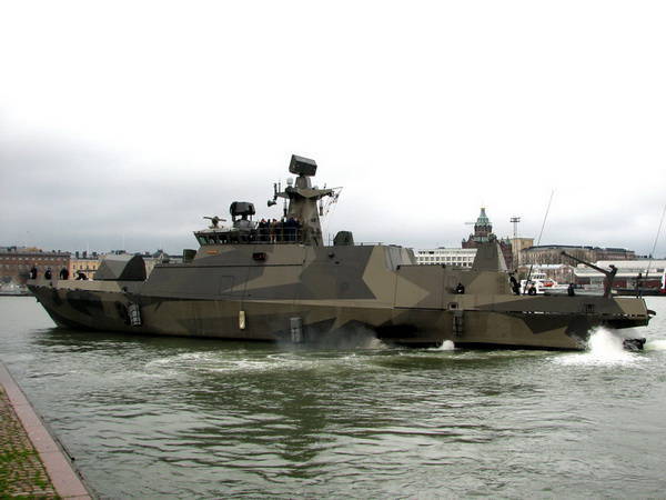

The Finnish have the Hamina-class, and they are sweet.
To me a Next Generation PC/corvette could and should replace the current PCs. It would be an easy, low-cost, low-end solution to a very high-risk threat (small boat swarm attack) that too much of the time is accomplished by high-cost, high end ships. Even the Navy’s new “low-end” ship (LCS) is costing $500-$700million per ship. Current Corvettes similar to the one I have described are on the order of $100 million.

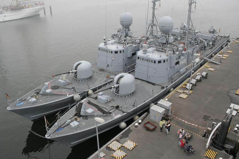

The Gepard-klasse missile craft:
Ultimately, the mesh may appear to be an uparmed version of the Hamina-class Finnish corvettes:

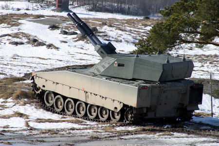

    2. Weapons: I would add an AMOS 120mm automatic gun-mortar turret (it has been tested on the CB90/RHBS).
      - Fires all NATO 120mm mortar rounds including PGM; a M933 HE Round: ~31 lbs; (roughly comprable to a 155mm howitzer round)
      - 10 km range (farther than the MK 110)
      - ROF: 16/12 (Max/sustained), but it can shoot 4-rounds in < 8-seconds, and has an MRSI of up to 8-rounds simulteous impact (!)
      :woo_hoo:
      - 48 round magazine
      - Fully automatic
    - Pricey, but what else are you going to spend that MFP 11 money on? :heh:
    :woo_hoo:
    - 48 round magazine
    - Fully automatic
[/list]
I was not a fan of the AMOS for the larger platform due to lack of range, but using the Mk VI as a platform to get AMOS in close and up waterways would be a great fit.
AMOS was found to be too large for the CB90 (52'x12'6"), so the Sweeds are developing a larger vessel to carry it, measuring 79'1"x17'2" - slightly smaller than the Mk VI platform.
The other option is the Patria NEMO - a lighter single barrel version of AMOS. That might allow the Mk VI to pack a Mk 38 and a NEMO without losing too much space. Nice for close in work
