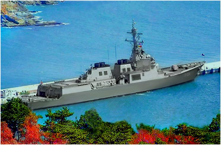

The South Koreans have already made their version of the DDG-51 Flight III. Here is there version:
I do not advocate this as a cruiser. A cruiser needs to have radar separation, more missile tubes to address more threats, have better survivability, etc, but I look forward to what people have to say about a DDG-51 Flight III. :thumbs_up_1:

The KDX-III gives a glimpse of what the modified Burke should be. I think the basis for the flight III mods should be a lengthened hull. That hull should ship at least 128 cells (64 fwd, 64 aft) and two primary guns.
1 - Radar: SPY-1 does the job and is developed, I'd stick with that for now. I'd back it up with SPQ-9 and SPS-49 and/or TRS-3D.
2 - Missiles: 128 cells are a minimum needed, keep in mind some of those 128 will be quadpacked ESSM.
3 - Guns: Today, I'm still on the Oto Melara 127mm/64 kick (I love the ability to select between ready mags, and the rate of fire), so I'd like to see two of them. In the case of the KDX III, I'd put in a second mount even if it cost the additional VLS aft. Guns have been used repeatedly across especially the last few years of naval engagement, and our reduction of their numbers in the fleet is inexcusable. In my opinion, AGS-L has too few rounds to be significant at this point - 180 does not cut it (this is a volume limited magazine, not a weight limited magazine). If the capacity can be increased, as well as the rate of fire, etc...etc... 203mm/60 based on the Mk71 would be much better (higher capacity magazine, higher rate of fire), but the weight and space needed for the mount are a concern for an aft mounting. Vulcano ammunition in 8"; hmm....
As a task force escort, the 127mm may be all that is needed - you would expect a different vessel to take the gunline if this ships primary is task force AAW. That may allow for additional cells.
4 - CIWS: I love the independence of Phalanx as a stand-alone system, but it does not prevent fragmentation damage from its victims. My first thought is RAM in the current CIWS positions and four Millennium guns (F/P/S/A) so that three will fire on most bearings - for anti-missile and swarm defense.
5 - Internal Torpedo Tubes
