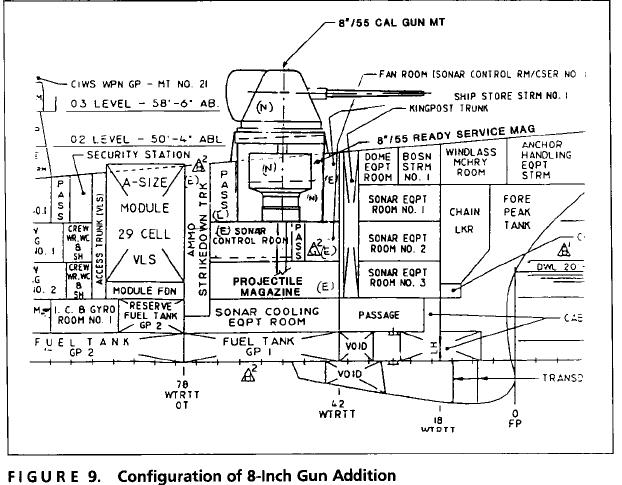

I think one thing that is essential is that the gun be upgraded to a gun that is actually effective in the NSFS and ASuW role. That means the AGS(L) modified to fire existing USMC and US Army 155mm rounds (if that cannot be done), building the 155mm Mk71 Mod X gun, or going to the existing 8"/60caliber gun Mk71 ModX (Mod2) naval gun. Anyway we go about it, the hull would have to be lengthened to accommodate a full 3-deck gun magazine.
While it seems intuitive that we should not send a super sophisticated ship into a NGFS role, it will wind up happening. The Flight IIIs will indeed be involved in NGFS. If they're within 100nm of an enemy force, they will be able to engage targets with the 8" gun 100nm range.
For 21 years the Navy has neglected to put a deck gun aboatd our new-build combatants that can effectively perform the NSFS/ASuW missions. The most important thing is to correct that error with this new class of ship. This means to utilize the AGS(L), the Mk71 155mm/60caliber, or Mk71 8"/60caliber naval guns. In order for this to occur, a foot print inside the hull must be large enough to accommodate an adequately sized magazine. I equate this to be the 500 rounds accommodated aboard the Spruance-class DDs.
As we see here, when the Mk71 was engineered into the DDG-51 design, it was restricted to 1 deck of magazine.
The sonar control room can be consolodated into a smaller space, and the sonar cooling equipment room can move down into the bilge where the fuel tank currently is.
Some may ask: "What about the fuel? Wouldn't we lose range because the sonar cooling room is now displacing fuel?"
The answer is that since 1. the ship will be lengthened slightly, the void in the bottom o fthe ship will be lengthened by 16' would accommodate most of the displaced fuel.
2. The USN will actually be able to be some sort of effective NGFS.
Here the displacement of the fuel and sonar room will accommodate a 500 round 8" magazine or a 600 round 155mm magazine in proportion to that of the Spruance-class. That means that as the Spruance-class was laid out, this magazine would accommodate at least 80 LRLAP rounds and 520 155mm rounds. With the smaller diameter of the 155m vs the 8-inch we could accommodate an even 100 LRPAP 155mm rounds and 500 155mm rounds.
To be honest, 100 LRPAP rounds would be alright in an operational capacity. Most NSFS missions will be within the 155mm RAPed Excalibur rounds, and they would accomplish most missions.
In order to make this work, the hull would have to be lengthened as if the ship were built to have 64-cell VLS tubes forward and a standard 5"/62caliber gun forward. To fit a 500 round 8"/60 caliber gun and magazine or a 600 round 155mm/60caliber gun and magazine forward, the ship should only be able to accommodate 48 VLS tubes forward and the rest of the 80 missiles aft, similar to the South Korean KDHIIIs.
When constructed with belts of HSLA-100 this would be a far superior DDG than any we have produced.
