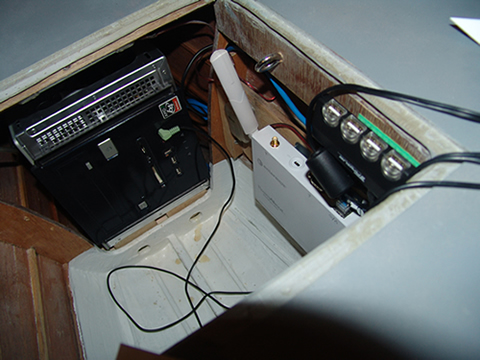

OK so the model Enterprise has been in refit for about 2 years now, Cracks were appearing all over the flight deck due to expansion in the heat. I used a light fibreglass coating and this wasn't strong enough.
The sponsons were made of thin plastic sheet and these were breaking up with use. So there were a few things starting to show that needed fixing. I decided to pull the plug and put the ship back into the shed for some major work.
So what follows are some photos of that exercise. This weekend coming will be the TF72 regatta in Wagga NSW, this will really be the first time Enterprise has been in the water for over 2 years.
Sorry for all the pics, but any questions please let me know

The intention is to put an air group on board and even underneath I have fitted rails inside the boat that you can see in some shots to drop hangar sections in through the battery compartment and slide into position.
The hangar doors were originally fitted closed, but I am now re fitting them to open electrically
