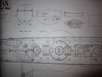

Then I struck lucky and found a small set of finely drawn and well reproduced plans in a German book. These matched very closely with the photos of the actual vessels so now I had a good starting point.
I scanned them in on hi resolution and took the file off to a trained computer "geek" I know. He scaled and vectored
them, and printed them out on A3 sheets with location marks. After pasting them onto a board, out came the tracing paper and I traced off the lines the old fashioned way, removing internal detail (boilers, turbines etc) and adding additional external detail gleaned from the growing collection of pictures I had gathered. I now had a good set of model makers plans to work from.

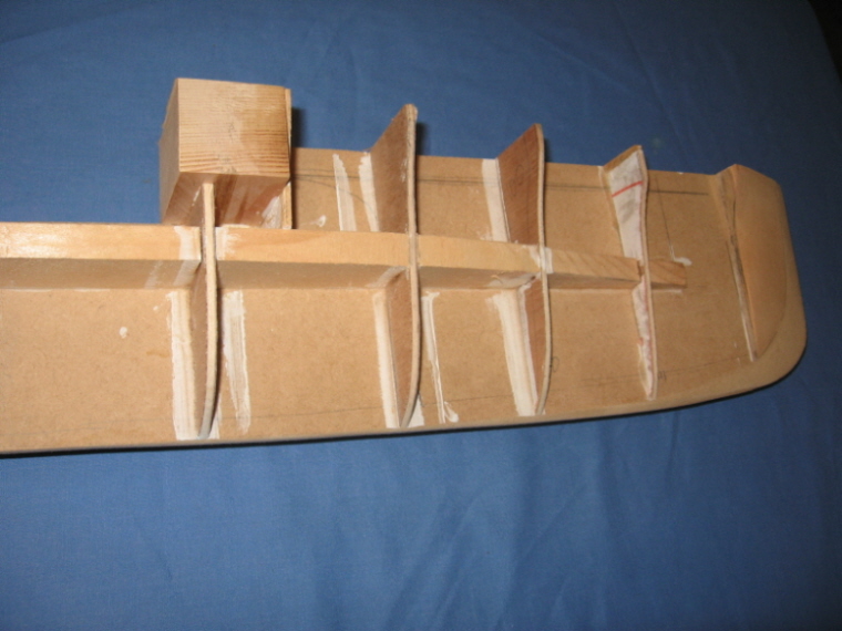

The backing board is 4mm MDF (medium density fibre board). Wear a mask when cutting and sanding the stuff!
Two pieces were lightly pinned together then they were cut out on the band saw. When separated they give identical port and starboard profiles. This material has little or no longitudinal strength (it's bendy) so the shaped softwood (internal) spine was glued and screwed (from the back) in place. Another slightly deeper spine is temporarily screwed onto the rear of the back board. You will see this in the next post. This makes it super rigid and gives you something to clamp into the work bench while you work on each plug half. The material is easy to shape along it's edge using a small "spoke shave". All will become apparent.

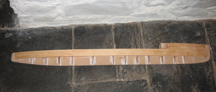

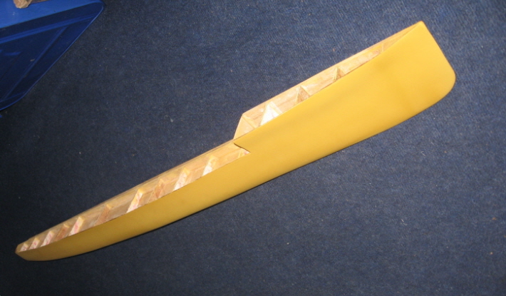

I forgot to mention in the previous post, but I suppose its pretty obvious, that the individual hull profiles (bulkhead shapes) need to have their outer edges reduced by the same thickness as the hull planking one intends using.
For the planking, whether its for a plank on frame hull, or for a plug construction, as in this case, don't skimp by using poor quality timber. Avoid timber that is hard, wavy grained, resinous, oily, damp or full of knots. I use either Canary Poplar (tulip wood) or choose some from my supply of 150 year old yellow pine!
Having run a load of strip timber off in the workshop (4mm by 1.5mm) I started glueing the planks in place having first added a roughly shaped block at the bow and stern of each plug half. I use aliphatic resin glue and hold the planks in place with dress makers pins inserted with pliers, and removed when the glue dries. I worked from the keel and the deck edge at the same time. It's at this point you realise why the outer spine was screwed in place as you can clamp each hull half solid while you work on it.
While the glue was drying I kept the research up and discovered a load of interesting info at viewtopic.php?f=13&t=55067 where Yevgeniy was building the same vessel at a much smaller scale. The contributors were a great help.

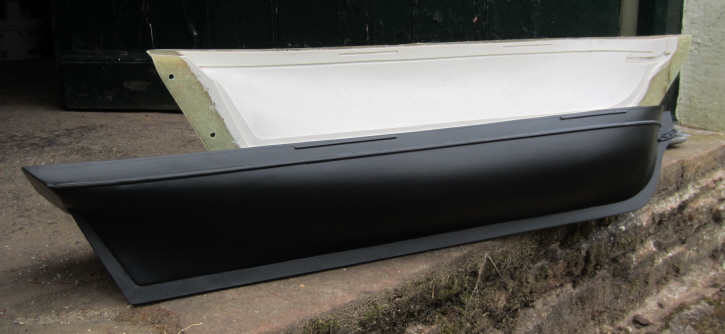

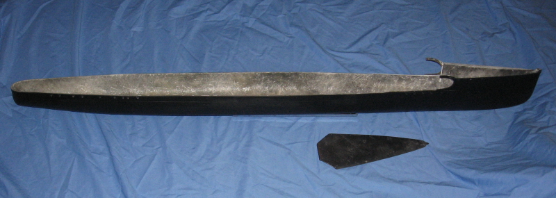

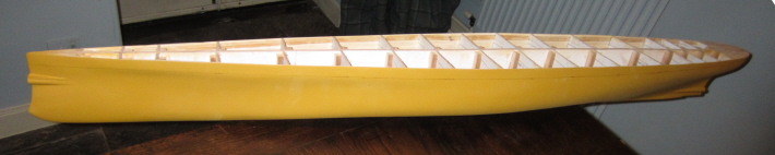

After completing the planking process the plugs was sanded down with quite course sand paper to remove blobs of hard glue and other raised areas.
The external spines on the backing boards were temporarily removed and the two plug halves were offered up to each other. Four holes were drilled so they could be bolted together and they were sanded so that they matched together well. They were taken apart again and the wooden spines re-fitted.
One coat of cellulose varnish was applied to seal the surface.
At this point the plugs still looks pretty rough. Next a thin layer of car body filler was spread over each half of the plug. I used a flexible metal spreader for this to keep the layer thin and consistent. When set, this was sanded smooth before the first coat of (yellow)filler primer was sprayed on (from a spray can). At this point you start to see the real shape of the hull and you realise the hull lines in the plan must be accurate as they show up all sorts of interesting detail, for example the bulge in the hull to accommodate the turbine room, the upward curve of the keel (forward of amidships) and the cut outs for the forward torpedo tubes. About four coats of the filler primer were used, sanding down and filling between each to work up a smooth surface.

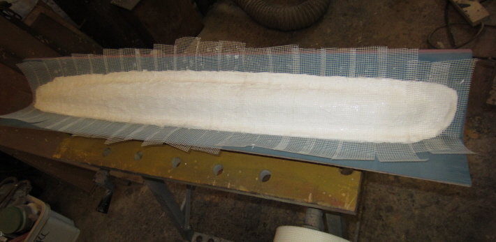

Yes that's pretty much correct although I would also suggest applying some glass fibre tissue in panels between the frames/bulkheads.
The resin is waterproof and hard on its own, but has a low tensile strength. The timber planking can expand and contract (very slightly) with changing temperature and humidity, and result in a seam opening up. This minute movement will still crack the layer of resin if it is not reinforced. A lot of modellers apply a layer of tissue on the outside of the hull too, usually before skimming it with filler. I would normally do that too as I question how water resistant a layer of filler applied straight to the wooden planking actually is! If the outer hull paint gets chipped, water soaks unseen into the planking and it expands, pushing off more filler, DISASTER.
This and some of my other models are long, slim and shallow so I knew I needed to keep weight down and do away with hull frames (to gain internal space) hence the plug/glass fibre method. The hidden advantage is 100% hull water tight integrity. The disadvantage, a lot more work and expense!
For those modellers who asked about reference books, I should add that I discovered a little book which helped a lot with deck detail a little later on. This was "Warship Profile number 27, SM Torpedo Boat B110". ISBN 0 85064 103 9 . It was printed around 1973, but I picked up a good copy on Abe books. The B110 vessel was a lot bigger, but about the same date, so assuming a lot of deck detail was standardised on these vessels the book contained a lot of good reference photos. Good reading too.

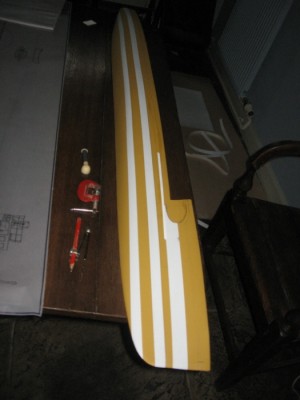

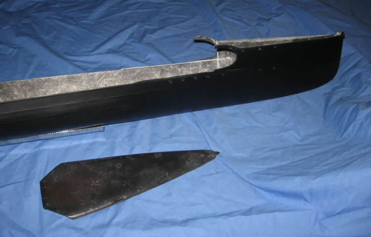

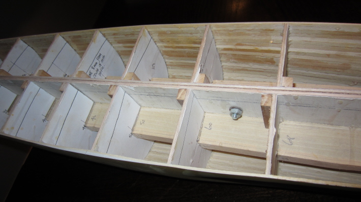

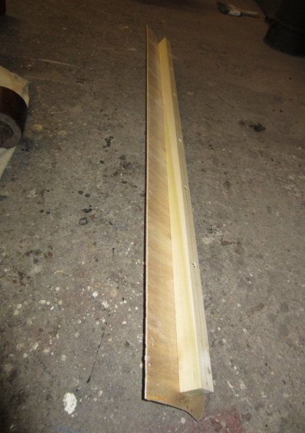

As I said it's handy to be able to put the two plug halves together now and then, to make sure they are (and stay) an accurate match. The other alternative to building a plug in two halves is to build it complete, but with an additional 3mm in the centre. When complete you can cut it half lengthways with the band saw. The extra 3mm allows for the blade kerf. A bit nerve racking! I have done it this way but the end result was not as accurate.
I have added a photo of the internal bolts. There are four in total.

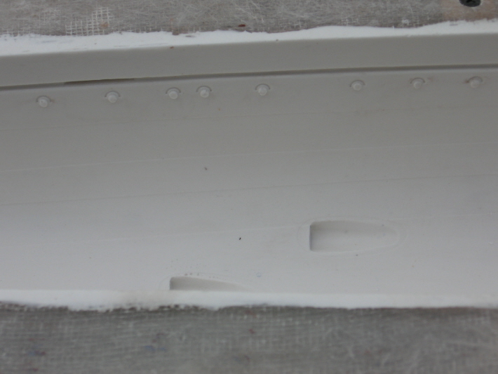

Now the less dusty, more interesting work starts. I marked onto the hull where the plate lines were. I did not have a plate expansion plan for V105, but the photos showed the lines above water and I used a plate expansion for a contemporary British destroyer below waterline. The plates are joggled in and out and would have been flush riveted so no rivets to mark. I used self adhesive aluminium foil cut to shape/width for the raised plates and simply stuck it on. With care you can work it round curves and only one or two relieving cuts where required near the stern. The foil tape should be rubbed down hard. Don't trap any air bubbles.
Fine wooden strips were used for the deck edge and other rubbing strakes. For any tight curves (eg the torpedo tube cut outs) I used lead wire. All these were stuck in place with CA (super-glue). I discovered that it melts into the primer and holds very solid, although the drying time slows somewhat.
I also added other hull detail but better pictures of this next post.

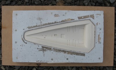

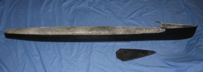

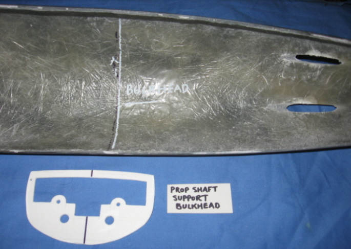

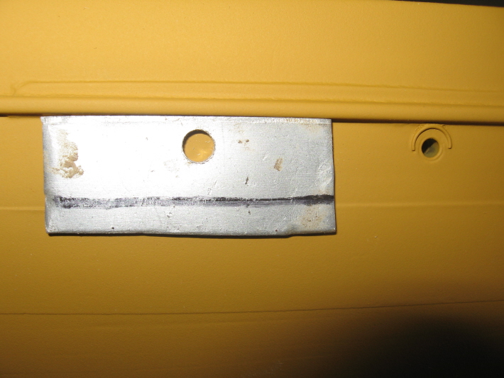

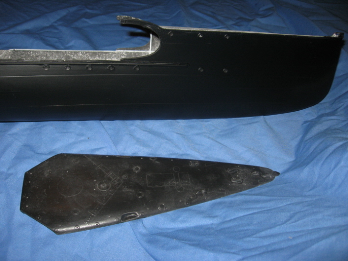

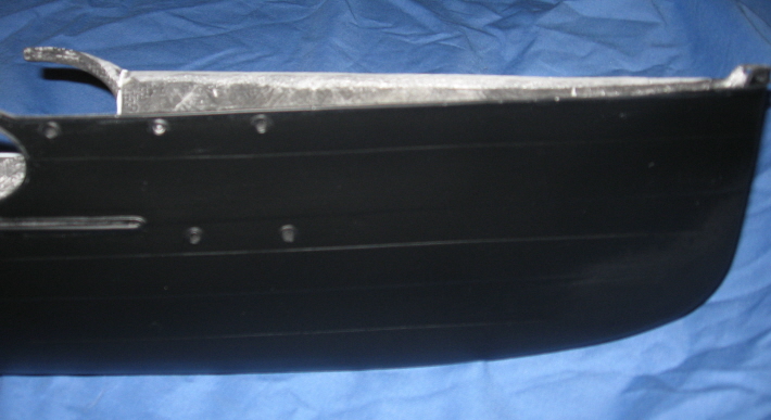

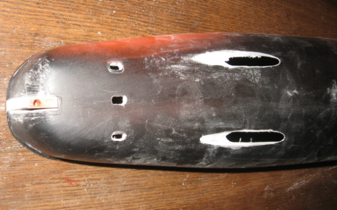

I wanted to get as much detail as possible moulded into the hull. As V105 was designed as a "wet" model from the outset, I did not want bits "dropping off" after prolonged sailings, when adhesive started to fail! It also seemed sensible to add the detail at this stage (the plug). Handling, measuring and locating the detail into the plug was so much easier than working on a full hull, as I could handle one plug half at a time and clamp it down to the work bench. It was also possible to lay the plug halves along side each other and mark across locating positions for detail like the port holes.
When the port hole positions were marked, a metal template was used to control the drill bit when each hole was carefully drilled, with a newly sharpened bit. Short sections of brass tube were then inserted into each hole. It's not shown in the picture but short lengths of plastic rod were then inserted to the correct depth to block the tube. The rigoles (eye brows) were formed from soft brass wire wrapped around the correct size of drill bit shank, and snipped off with side cutters. CA glue holds them in position.
The same self adhesive aluminium foil was used to mark location positions for the prop shaft "A" frames. This will be seen in subsequent pictures.

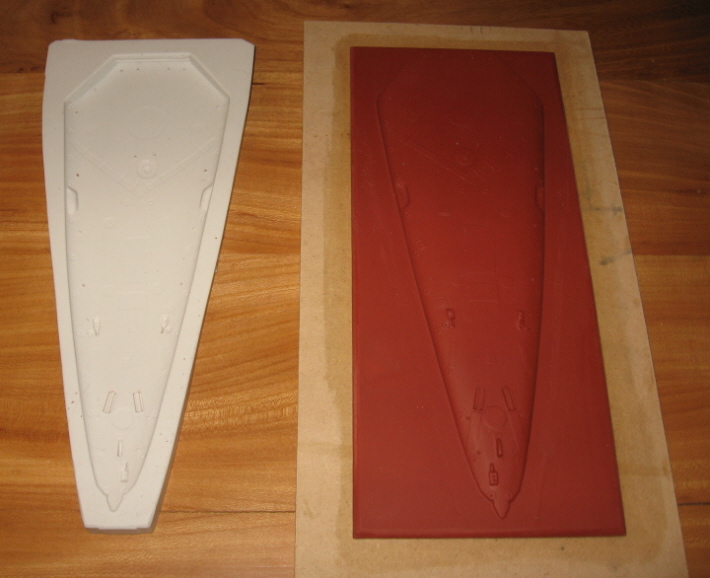

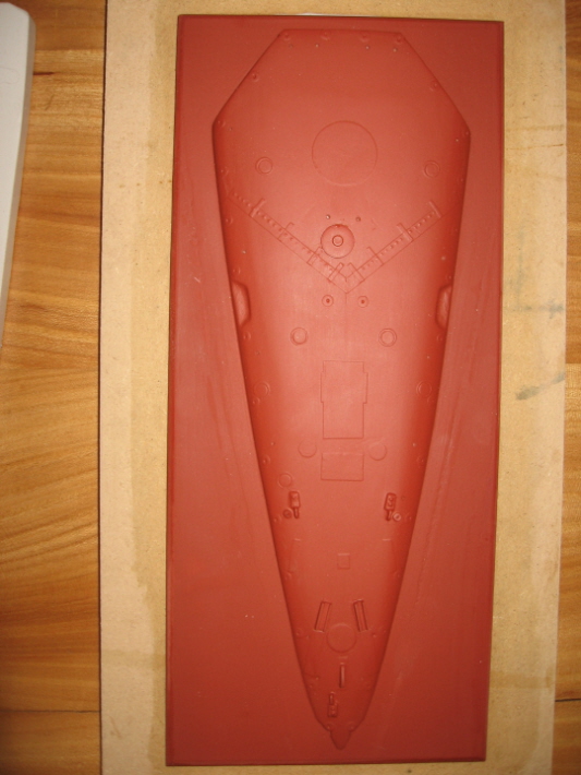

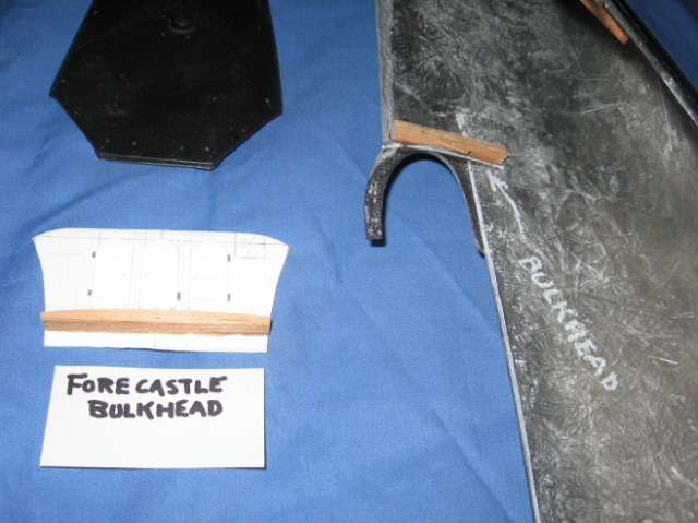

At this time I also turned my attention to the fore deck. A template was taken from the plans and the basic shape for this was cut and carved (initially with the trusty spoke shave) from a piece of lime (bass wood). Having smoothed and prepared the surface of this, I again added as much detail as possible, deck lights, plating, chain runs, location positions for the gun, breakwater etc. The chain stoppers were moulded in completely too. This fore deck plug was used to manufacture a silicon mould, which will be supported in a glass fibre cradle (not shown here) when in use.
Thanks for the encouragement from Edinburgh.

Having finished the plug preparation each half is attached to a two part wooden fence. It's important that any small gaps between the plug and the fence are filled (I used Milliput). The surfaces of the wooden fence are prepared and made smooth, the same as the surface of the plug. Release agent is applied to the plug and fence and allowed to dry before applying 4 coats of RTV silicon rubber (6 hours drying between each coat). Finally two layers of GRP constructional mat are applied on the outside. When set this forms the support "jacket" for the silicon mould.
With a fine steel spatula and some small wooden wedges it is now possible to ease the mould off the plug.
The two mould halves are carefully matched together and temporarily clamped before drilling through the edge flange at about 60 mm spacing and fitting bolts with wing nuts and washers. Your mould is now complete. I usually add a wooden cradle to stop it moving around while you are using it.
Again I apologise that the pictures of the finished mould are of another vessel not V105 (camera malfunction), but the techniques are all the same, only the shape is different.
NEXT POST, THE FIRST V105 HULL OUT OF THE MOULD!
I guess some of you out there are thinking "this seems like a heck of a lot of boring preparatory work, and old PICKETBOAT hasn't even started building the model yet! For heavens sake hurry up"
Well you are right. This first bit is a slog, and I wouldn't blame any of you who have glazed over or gone off to look at something a bit more interesting in the model making line. But bear with me as we are getting to the more interesting bits now. I did however think I should include this beginning section, so that anyone new to the hobby could get their head round different hull/plug construction techniques.

Just before I talk about the first hull out of the mould, and start to describe the first stages of the (actual) V105 build, I thought you might like to see some pictures of a mould with it's support cradle. The fore deck silicon mould is held in a GRP jacket, which is just fastened down to a square wooden panel. This can be clamped to a work bench while applying the Gelcoat and "laying up" the GRP.
The split hull mould has a wooden frame type cradle. The whole cradle is in two halves as well, so that when the mould is split the cradle splits too, each half being permanently fixed to the mould. The open framework means you can get easily to the wing nuts to split the mould. Again it's good to be able to clamp it all to the bench so that when laying up the GRP, the whole thing is not wobbling about.
The close up of the interior of the mould shows the port holes and eyebrows in reverse.
I DID NOT TAKE PICTURES OF THE ACTUAL LAYING UP OF THE MOULD AS IT'S AN UNBELIEVABLY MESSY BUSINESS, AND I WOULD HAVE CERTAINLY GOT RESIN ALL OVER THE NEW CAMERA! I THINK THAT'S WHAT LEAD TO THE LAST CAMERA MALFUNCTION!
The laying up was straight forward, (black) Gelcoat followed by two layers of CSM (chopped strand mat). The hull came out of the mould very easily, no release agent being required for silicon moulds.
The end result a very nice and accurate 1/48th scale V105 hull and fore deck, ready to start building. The pictures show the hull and fore deck after the 20mm of waste have been carefully trimmed from the edges.
Next post "Fitting the fore deck and bulkhead".

Fitting the fore deck involved making the fore castle bulkhead first. This was marked out on plastic card. There would appear to have been three doors into the fore castle, the centre one also being used to winch in and out reserve torpedo re-loads. The timber (cambered) deck support shelf was also fixed to the bulkhead at this time.
The edge of the fore deck and hull were filed to a 45 degree mitre fit and then held in place with masking tape. I found CA glue sticks the raw edge of GRP very well, so I simply inverted the hull and ran the glue down the joint from the inside.
Some of the more observant of you will have noticed that the curved cut-outs for the torpedo tubes (formed as part of the hull) are at the wrong angle to meet up with the underside of the fore deck. I had to do this to make it easier to mould the hull. These curved pieces were easily cut off and glued back in place at the correct angle under the fore deck.
The hull was also pierced for the A frames and the stern tubes, and the positions marked internally for the stern tube support bulkhead and engine mounting bulkhead.
More of these fittings in the next post.
