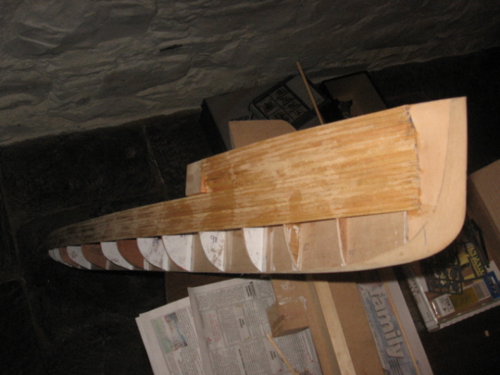

I forgot to mention in the previous post, but I suppose its pretty obvious, that the individual hull profiles (bulkhead shapes) need to have their outer edges reduced by the same thickness as the hull planking one intends using.
For the planking, whether its for a plank on frame hull, or for a plug construction, as in this case, don't skimp by using poor quality timber. Avoid timber that is hard, wavy grained, resinous, oily, damp or full of knots. I use either Canary Poplar (tulip wood) or choose some from my supply of 150 year old yellow pine!
Having run a load of strip timber off in the workshop (4mm by 1.5mm) I started glueing the planks in place having first added a roughly shaped block at the bow and stern of each plug half. I use aliphatic resin glue and hold the planks in place with dress makers pins inserted with pliers, and removed when the glue dries. I worked from the keel and the deck edge at the same time. It's at this point you realise why the outer spine was screwed in place as you can clamp each hull half solid while you work on it.
While the glue was drying I kept the research up and discovered a load of interesting info at viewtopic.php?f=13&t=55067 where Yevgeniy was building the same vessel at a much smaller scale. The contributors were a great help.
Don't forget to reduce the bulkhead profiles by your hull plank thickness.
On another plug you can see the outer spine screwed temporarily to the rear of the back board.
The planking stops at the bow and stern block.
The planking might look a little rough but this is only a plug I am building. The inside looks EVEN worse.

Just before I talk about the first hull out of the mould, and start to describe the first stages of the (actual) V105 build, I thought you might like to see some pictures of a mould with it's support cradle. The fore deck silicon mould is held in a GRP jacket, which is just fastened down to a square wooden panel. This can be clamped to a work bench while applying the Gelcoat and "laying up" the GRP.
The split hull mould has a wooden frame type cradle. The whole cradle is in two halves as well, so that when the mould is split the cradle splits too, each half being permanently fixed to the mould. The open framework means you can get easily to the wing nuts to split the mould. Again it's good to be able to clamp it all to the bench so that when laying up the GRP, the whole thing is not wobbling about.
The close up of the interior of the mould shows the port holes and eyebrows in reverse.
I DID NOT TAKE PICTURES OF THE ACTUAL LAYING UP OF THE MOULD AS IT'S AN UNBELIEVABLY MESSY BUSINESS, AND I WOULD HAVE CERTAINLY GOT RESIN ALL OVER THE NEW CAMERA! I THINK THAT'S WHAT LEAD TO THE LAST CAMERA MALFUNCTION!
The laying up was straight forward, (black) Gelcoat followed by two layers of CSM (chopped strand mat). The hull came out of the mould very easily, no release agent being required for silicon moulds.
The end result a very nice and accurate 1/48th scale V105 hull and fore deck, ready to start building. The pictures show the hull and fore deck after the 20mm of waste have been carefully trimmed from the edges.

The fore deck mould in it's GRP support jacket.
The hull mould in it's support cradle.
A close up of the mould interior showing the port hole and plating detail in reverse
The first 1/48th scale V105 hull and fore deck out of the mould. All the effort pays off.
The first V105 hull is trimmed down to the deck edge ready to start building.
The detail on the hull exterior has transferred  nicely from the mould. Sorry about the dusty finger prints!
