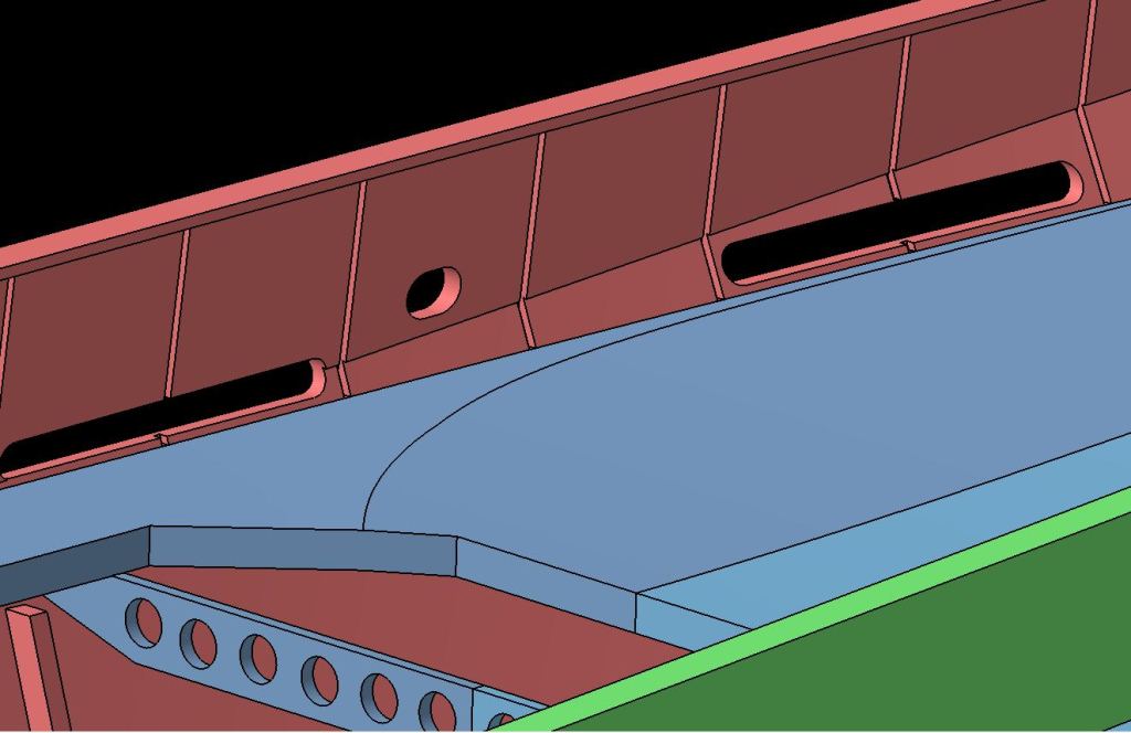

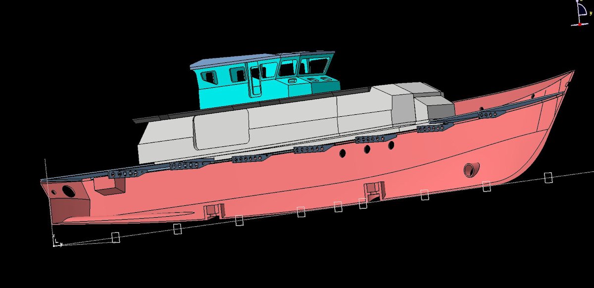

How's the CAD coming along? Pretty well! I'm nearly done with the major structures, and am adding all the little stuff... like hanging ornaments on a Christmas tree. But even that needs to be done, as the design work on some detail often points to the need for mounting features on the main structure.
Note that I have no intention of creating a photo-realistic rendering... that's a job in itself. So my images here will be pretty basic, just showing those components that I plan to print (or will investigate for printing). But all items visible here are designed with feasible geometries for printing, finishing, and assembly.
File comment: Half-hull image showing interior details for the pedestal mounts.
File comment: Detail work to-date.

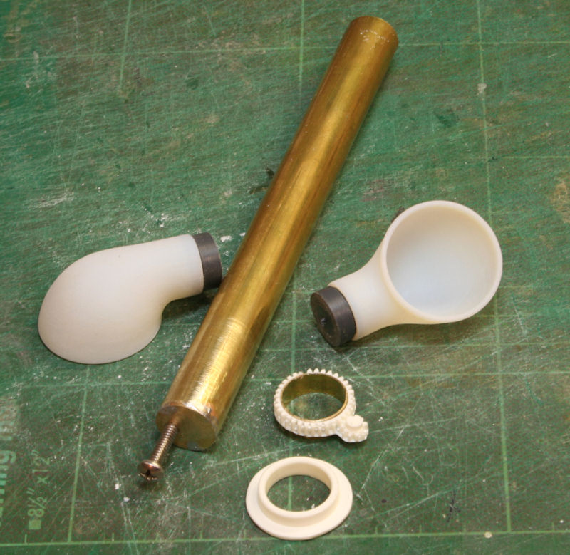

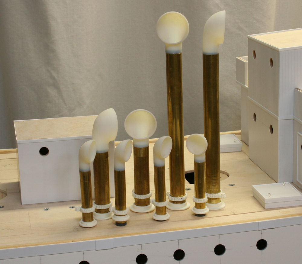

If you haven't seen them before, here are the 3D-printed cowl ventilators I did for a 1:32 Foundation Franklin:
http://www.rcgroups.com/forums/showthre ... st15413788
I also make them available through Shapeways... linked from:
http://matthewsmodelmarine.wordpress.co ... del-ships/
File comment: 3D printed cowl vents
File comment: Hybrid construction

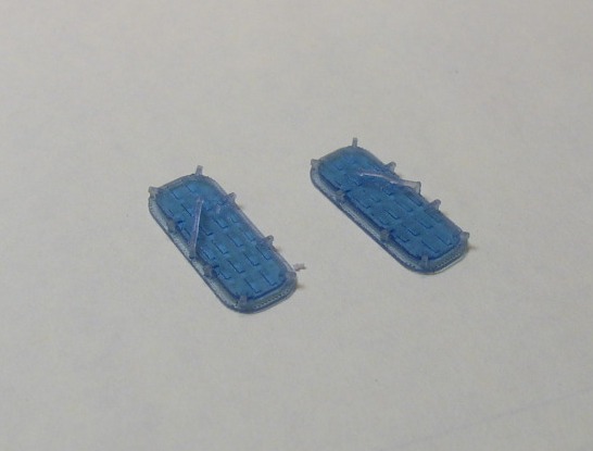

Yes, another thread where actual 3D printing experiences can be documented would be great. But until then, see my post on printing window glazing, where you can see what typical surface finishes look like for a 1:72 scale part:
http://www.rcgroups.com/forums/showthre ... st23504201
Now, this particular material is not the finest for detail, but was the only clear stuff available at Shapeways. Their "frosted ultra detail" does better for detail, but still requires cleaning (it's covered in a waxy/greasy slime), and still some more sanding.
In this case, the very rough clear blanks were sanded and polished to near optical quality... but again, if you can't sand the surface for the included details, than all hope is lost.
