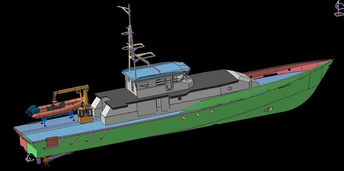

So my new subject? Canada's new "Hero class" patrol boats:
http://en.wikipedia.org/wiki/Hero-class_patrol_vessels
This is the Daman 4207 design, with modifications for the CCG. The Canadian boats have a number of visible differences from 4207's used in other services... there's a bustle on the transom with rear-exiting exhausts, longer forward bulwarks, and a number of other unique details scattered about the boats.
Plans are not available (we've tried!)... but with a lot of web-sleuthing (thank you, Google Translate, for help with the Czech and Dutch sources...), I've been able to develop reasonable lines. And with a number of fairly high-res images from various sources (like Mac Mackay's Shipfax), I've been able to work out a lot of the details in CAD.
If there's one thing I've learned from my day job (automotive engineer), it's that you don't start a big project until you know you can finish it. Believe me, we design complete new cars all the way through details of the assembly process before we get authorization to spend billions on tooling. It's not so critical with a model boat... but I'll still do all my CAD work before ordering the first printed part.

How's the CAD coming along? Pretty well! I'm nearly done with the major structures, and am adding all the little stuff... like hanging ornaments on a Christmas tree. But even that needs to be done, as the design work on some detail often points to the need for mounting features on the main structure.
Note that I have no intention of creating a photo-realistic rendering... that's a job in itself. So my images here will be pretty basic, just showing those components that I plan to print (or will investigate for printing). But all items visible here are designed with feasible geometries for printing, finishing, and assembly.

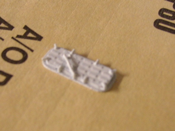

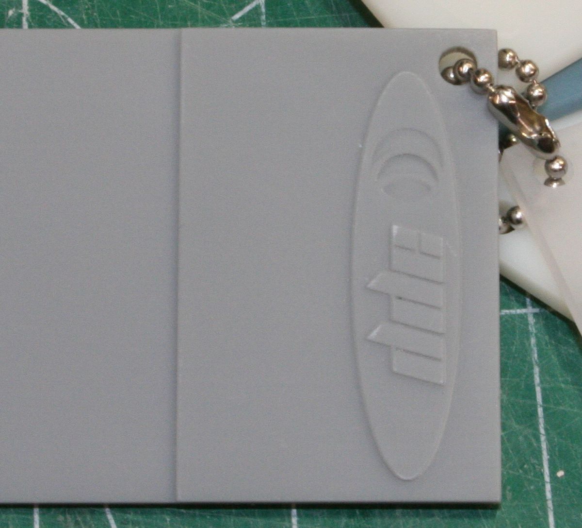

OK, I'm getting ever more hopeful about fine detail parts. I haven't heard back from Nelson, maybe his source isn't publicly available. But I did contact another modeler, TBowman at RC Groups, who has been getting some incredible parts for his large RC scale-sail HMS Scorpion:
http://www.rcgroups.com/forums/showpost ... tcount=128
Those parts come from APP (American Precision Prototypes), and are off of a true SLA machine. Quick reminder, there are several types of 3D Printing commonly available (and others, not so common):
SLA: Stereolithography... a laser is steered around on the surface of a pool of liquid polymer, curing the stuff as it goes. Provides the finest parts.
Inkjet/Polyjet: Just like an inkjet head, but either a photopolymer or a support wax are applied in layers by a printhead. Each completed layer is hardened by exposure to UV light. My experience- depending on the machine and material, can be as bad as FDM (below), or pretty fine (Shapeway's "Frosted Ultra Detail").
SLS: Selective Laser Sintering: A laser is steered around on a box of fine plastic powder (often nylon). Reasonable resolution, gritty porous surface. Often the lowest cost for big parts, needs sanding and filling.
FDM: Fused Deposition Modeling. Squirts out strips of molten plastic, like building parts with a hot glue gun. The worst for resolution, might be ok for 1:6 scale wicker chairs.
So I got a sample set from APP of a bunch of their materials, some photos below. I wish they had printed round or angled parts... surfaces square to the machine tend to come out the best, but the real test for the "jaggies" is a rounded surface.
Nevertheless, the Acurra Xtreme SLA material that TBowman used looks fantastic... really, no visible strata, virtually like an injection molded part. This has promise.
APP does have a $300 minimum... reasonable for a big ship model, but a pain if you're ordering small lots here and there.
File comment: Acurra Xtreme SLA sample... very nice!

File comment: SLS nylon powder... you can see the grit in the foreground.
