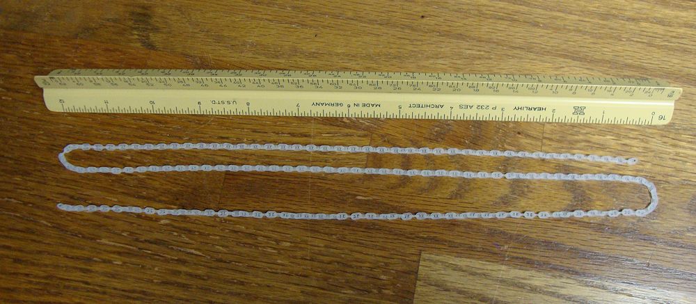

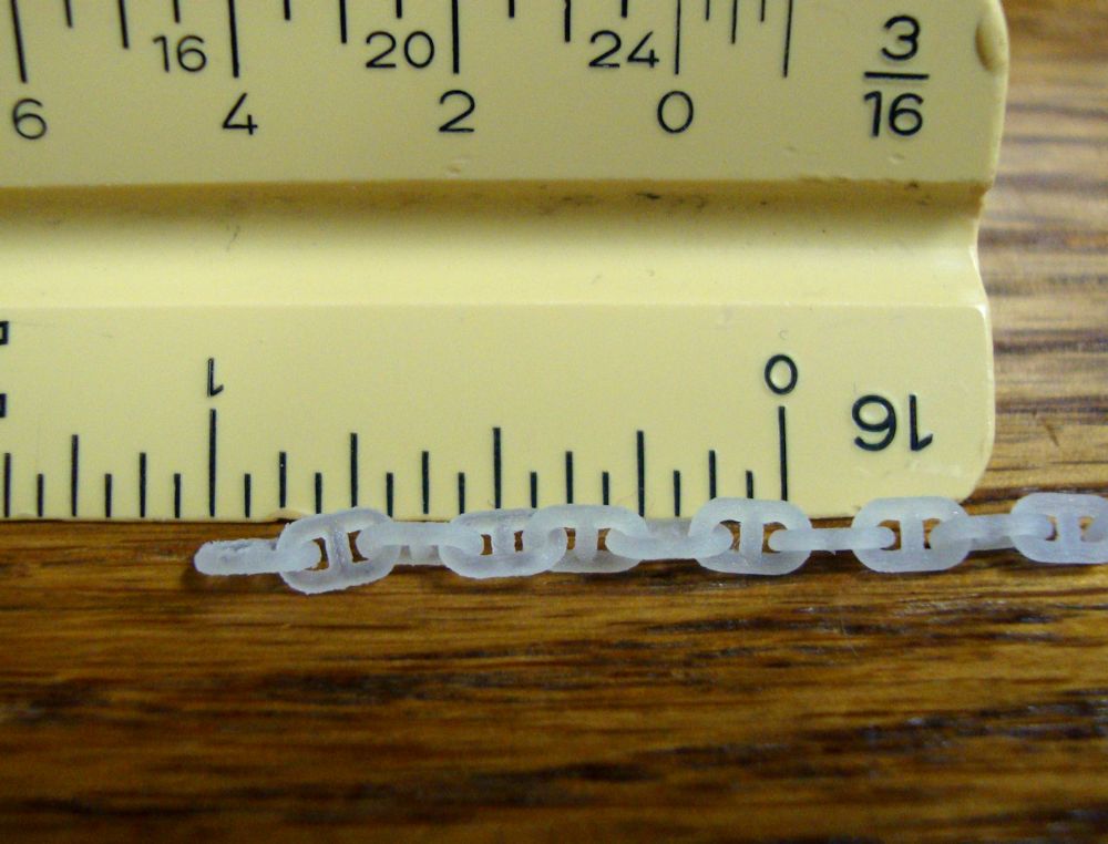

OK, here's something you might appreciate... 3DP stud link chain!
This is 36" of 0.9mm "wire" links (5.4mm overall length for each link). This about the right size for 1:96 battleships. This is a true 7 links per inch. The smallest metal stud link chain I'm aware of, from Cornwall, is 5.5 links/inch:
http://www.cornwallmodelboats.co.uk/aca ... hains.html
Tomorrow, I'm getting some at 0.6mm wire, 3.6mm link length... which is the smallest Shapeways will agree to print for me. Can't wait to see THAT!
Now, maybe you'd like to cut little pieces of wire to solder inside your open link chain, instead? :thumbs_up_1:
File comment: 3 feet of 0.9mm wire, 5.4mm long links
File comment: Close up of the 0.9mm links
File comment: 7 links/inch

PostPosted: Tue Apr 23, 2013 8:07 pm
Site Admin
Site Admin
Posts: 3415
that gives new meaning to the phrase Real Chain! Nice work.
