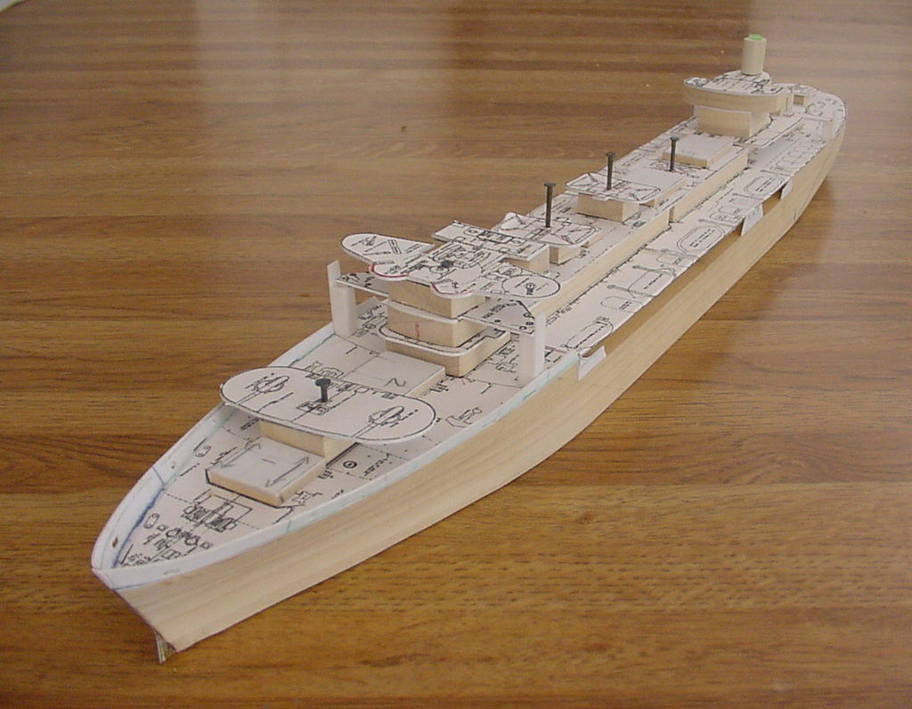

Pic 1 is the ship in 5N meas 21 (which is the scheme I will use).
Pic 2,3&4 are the hull to date.
Pic 5 is a close-up of the prow which changes from a rather steep angle to vertical. This caused me to make the centerline insert in 2 pieces, the upper 2/3 .020" styrene as usual and the lower 1/3 .020" brass to survive the aggressive sanding that had to occur in this area.

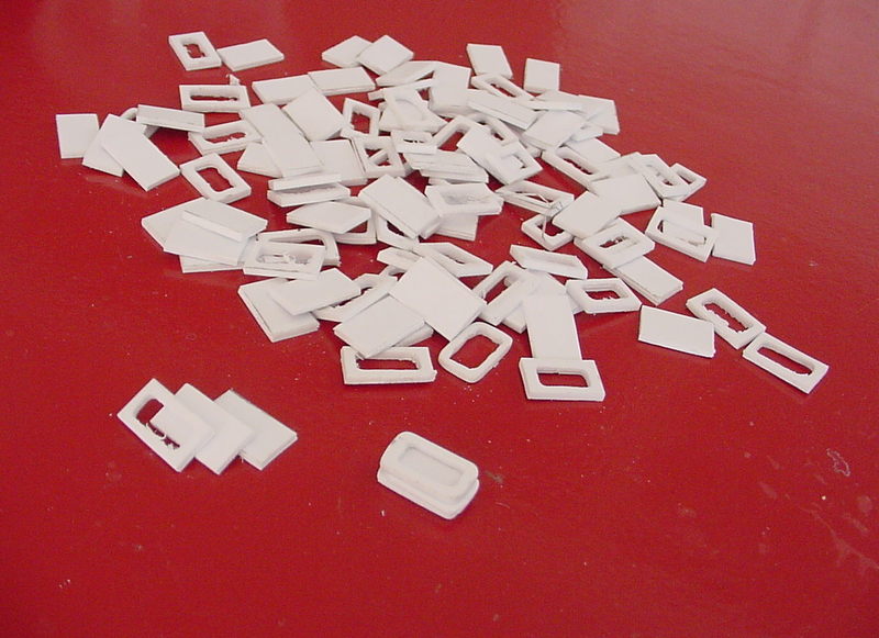

This build posed some challenges, the rafts and the lifeboats. The rafts are LARGE (.30" x .50" in 1/350) and the lifeboats are also larger than I could find commercially.
Pic 1,2&3 show how a homemade vertical mill made the blanks, only the top of 3 pieces needs the center milled out.

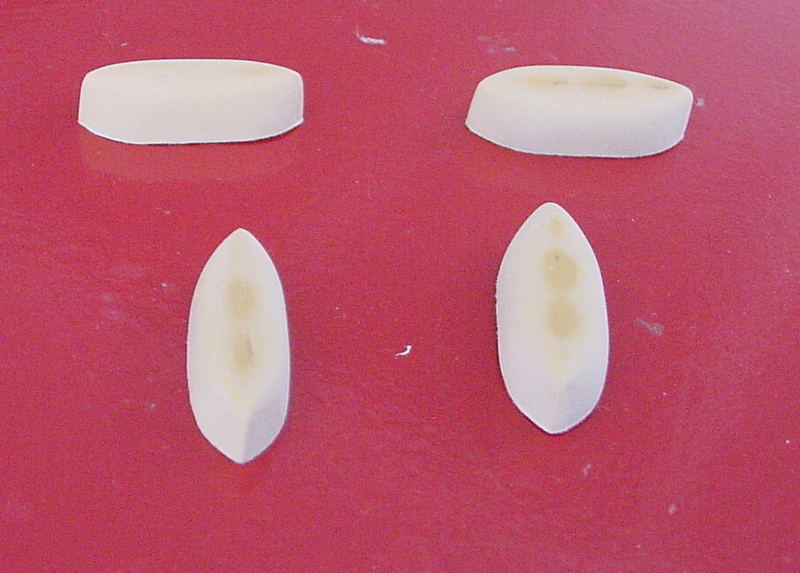

Pic 4 shows the patterns made for the nesting lifeboats, I hope to get a result from vacuum forming, if not then try to lay up a hull with paper and glue.

Pic 1 Surprise...Surprise...my first try at vacuum forming ended up with a usable part. Still cannot believe it, I really was expecting a grinding learning curve.
Pic 2 Modifications to an ordinary vacuum nozzle. The black brush was popped out, the new plate is .080" thick and the wood block is 2.5" x 1.5" x 1" with 45 .120" holes.
Pic 3 The production line from right to left, 400F toaster oven (.010" styrene 35 seconds - .015" styrene 50 seconds), finger protectors, clock, damp paper towels, vacuum set up in vise.
Pic 4 3" x 4" styrene blank, blank holder and clamps, the finished product.

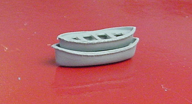

The lifeboats are roughed out and primed. They show my usual lack of perfection but hopefully will be OK from one foot. Made a few extras and left some notes, the idea to do a AP-110 class (10 pairs total) is gestating and at least I will NOT encounter the "how did I do that ??" problem.
Pic 1 Hull sheer sanding guide, "thwart deck" blanks (cheated ion the large boat - all is hidden by the small one), mounting spacers for both sizes.
Pic 2 Gunwale production.
Pic 3 Lifeboats as modeled.
Pic 4 Lifeboats as they were.
