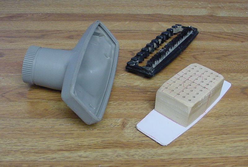

Pic 1 Surprise...Surprise...my first try at vacuum forming ended up with a usable part. Still cannot believe it, I really was expecting a grinding learning curve.
Pic 2 Modifications to an ordinary vacuum nozzle. The black brush was popped out, the new plate is .080" thick and the wood block is 2.5" x 1.5" x 1" with 45 .120" holes.
Pic 3 The production line from right to left, 400F toaster oven (.010" styrene 35 seconds - .015" styrene 50 seconds), finger protectors, clock, damp paper towels, vacuum set up in vise.
Pic 4 3" x 4" styrene blank, blank holder and clamps, the finished product.
I am fairly confident that I can make a finished lifeboat from this point.

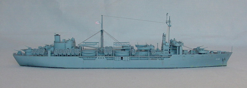

The General G. O. Squier is done.
Enjoyed the build although it took longer than normal, a combination of lazy and lots of parts. My impressions are, love the hull - best of the merchant hulls, hate the forward superstructure - off balance and added on. The aft superstructure seems to be an art deco sculpture. Cannot understand why the USN wanted four 5"-38 for this class but did not provide adequate fire control, a mark 37 director. Five shrouds per side on the mainmast seemed to be a reversion to the age of sail, I checked the photos closely for ratlines.
Pic 1 The goal.
Pic 2,3&4 The model. I know it is missing all the little people, but what is left of my sanity is still intact.
Pic 5 Always looking for comparisons, but this was my first transport. Then I remembered that the Leonard Wood was built to be a transport. A DE and a Gato added for size.
The next project will be the last APA and AKA in this "campaign". They were in my opinion the worst auxiliary ship designs made by the USN in WWII, therefore I have to build them.
Anyone interested in puzzles is free to guess their identity, the clue is that initial work will be done on both hulls at the same time.
