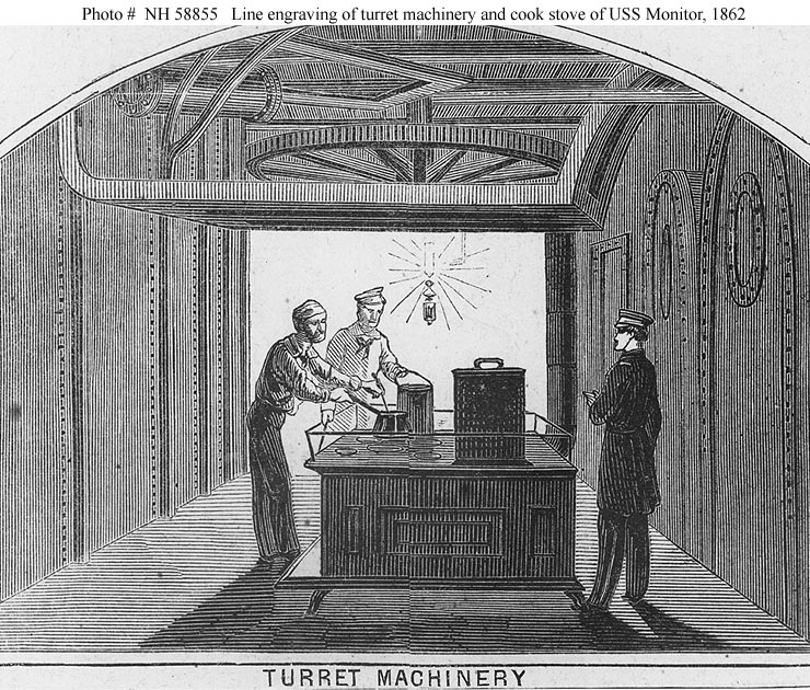

One is the fanciful Harpers cartoon:
This shows what might be an intake conduit running outside the gearbox, high on the port side, and a couple of goofy, swoopy pipes running down to and converging at the level of the steam chest of the port side engine cylinder. This cartoon is very little help except that it gives us a real world artist's subjective impression -- he was in the galley, and he actually saw the thing.

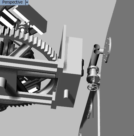

This is a mock up of the turret engine inlet valve. It shows where I think Ericsson probably put it, in an out of the way niche behind the gearbox (and stove), between the boilers. The position is defined by that of the incoming high pressure steam line; and by the limits put on the available space by, for example, the swing of the crankshaft. I have rotated the crank in this test model to check for interference.
It is probably no accident that the valve is tucked out of the way, up high and in behind the cook's stove.
The turret was retracted to the deck and stowed most of the time, and it would have caused real problems if someone naievely walked up and turned the valve wheel and thus started the turret engines when the ship was underway and the turret was stowed.
High pressure steam passes up through the valve to a T-splitter. Exhaust steam converges to another T-nexus immediately above it. This is just a mock up and will change as the piping proceeds, but I think the position and size of the turret engine steam valve are about right. It is a scaled down replica of the main valve.

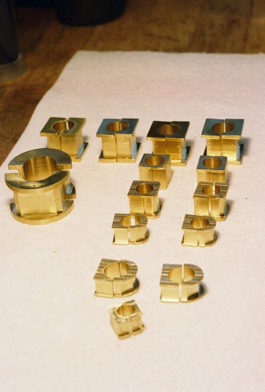

For the turret engine project a major problem has been bearings -- specifically the crankcase and gearbox bearings. In an email Rich summarized the bearing types Ericsson used on the main engine. This summary has been very helpful to me and may also be helpful to other modelers, so with Rich's kind permission I am reproducing his emailed summary here:
"Ericsson used 3 metals and 6 different bearing applications on the main engine.
The bearing materials are:
Cast Iron- A great bearing material, but brittle
Bronze- which is nick named �brasses� ( erroneously )
Anti-attrition Metal � which is Babbitt metal
The application methods are :
Strap ends � AKA called Gib and Cotter -used on con rods/piston rods- Bronze
Pillow Blocks � Radial support for shafts-Bronze
Thrust Plates � used on Forward and Reverse engine direction -Cast Iron. Babbitt, and Bronze
Inserts- like an auto rod bearing- Bronze
Flanged Blocks �Enhanced pillow blocks to also take thrust loads-Bronze
Poured Bearings/Inserts � Babbitt castings
Also, every bearing is split into two pieces!"
The bearing type that seems most pertinent to the turret mechanism is a split flanged bearing. In the case of the turret engine crankcase this is a conjecture -- we have no very informative drawings. In the case of the gearbox it is pretty definite, since a split flanged bearing was clearly identified by Rich in a Stevens collection drawing.

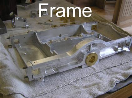

Rich created a number of split flanged bearings for the main engine, as shown in this photo:
This photo of the engine frame, with two bearings installed, suggests how the bearings were secured.

Note that although bearings of this type were called "brasses," they were actually bronze, something to bear in mind if you are doing a render.

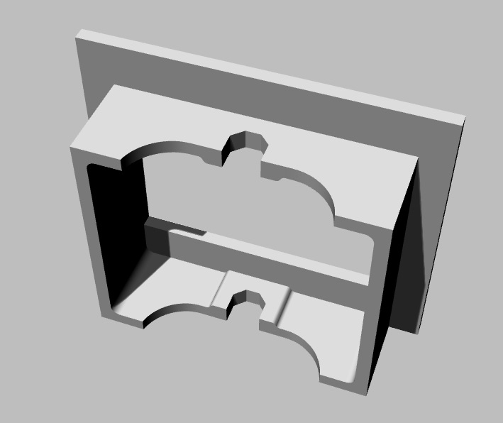

With the bearing type understood, it was possible to model a more realistic crankcase. Here is the casting.

Some bearings of this type used caps secured by studs, with the studs immobilized by wedges. Rich suggested that these caps should be secured using though bolts, which had greater strength than studs in that era. These bearing caps take significant loads from the engines. Here is the finished crankcase:
The deck beam from which the crankcase is suspended has been milled to make room for the flanged bearing. Still to be added are four lock washers of an unusual type. Here is the unit shown in the context of the gearbox frame.
Many thanks to Rich for his time and patient help in solving this. Michael

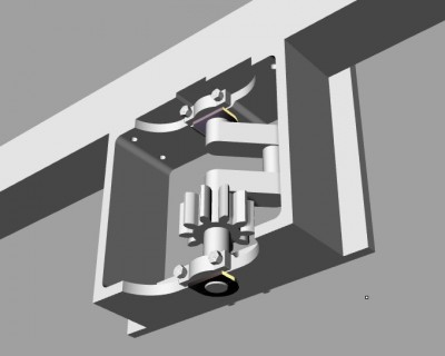

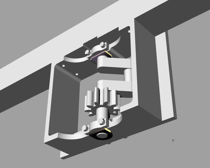

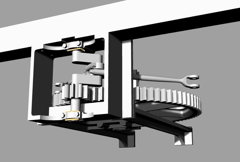

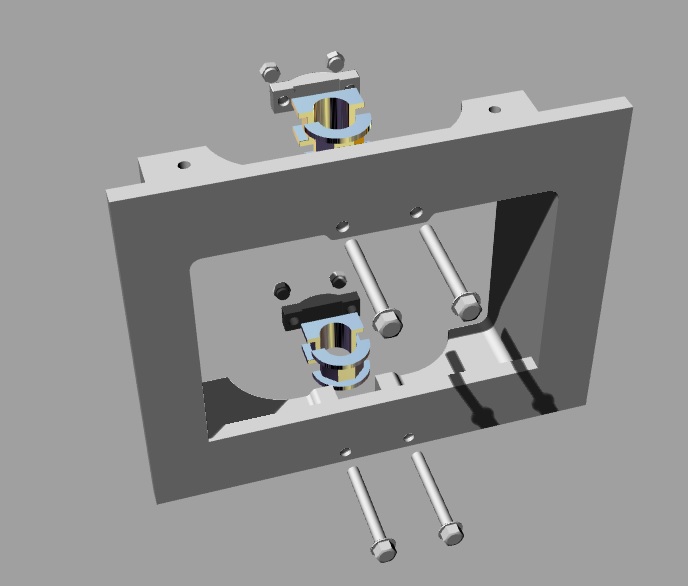

The next bearing problem is the gearbox. The crankcase and gearbox were suspended from 10" x 10" overhead deck beams. Here is a view of the gearbox from below.
The lower bearing takes the weight of the shaft, spur gear, and a large pinion. The mounting for this bearing is straightforward. I put crossmember under the bar of the "H". I am not finding it in drawings but I think it needs to be there. Conjecture.
The upper bearing takes no weight, but it does take loads from the accelerations and decelerations of the gear train. It is assumed that the upper and lower bearings were identical split flanged bearings. The drawing for these is from the Stevens collection.

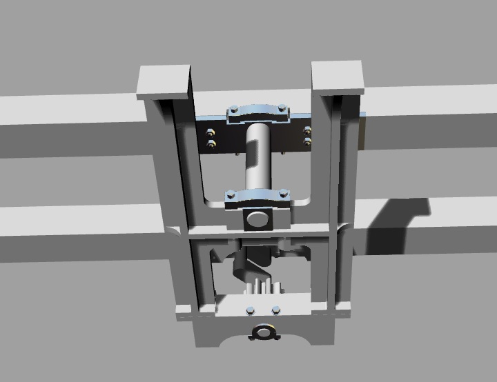

The upper bearing was mounted into the 10" square deck beam. Here is my guess at how it was done.

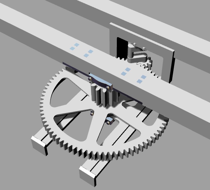

The split flanged bearing was mounted in this casting. The casting was mortised into the oak deck beam and bolted through it. The casting is 1.5 inches thick in the wings, and twice that deep in the middle where it supports the bearing. This technique of mortising and bolting castings and oak is consistent with several other structures, most notably the through-deck casting for the turret shaft.
This image shows the gears mounted on the shaft. It occurred to me to use an "L" for the casting, to provide greater strength to the beam, but since I am guessing I am inclined to keep the structure as simple as possible.

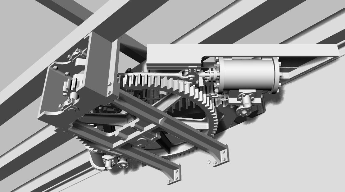

Detailing, adding in nuts and bolts. Admiral Porter, when he inspected the Monitor under construction, called this machinery "the coffee grinder."

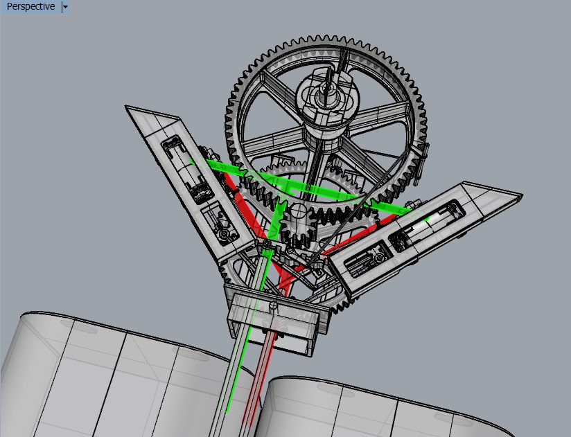

Here it is with the engine restored. Changes to the crankcase and gearbox are complete. It should now be possible to get back to the problem of running the steam lines. Michael

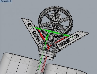

This is one of the early experiments in animating the gearing. This is the final stage of the turret drive. The basic problems I am working on are meshing and synchronization. The spurious "hitch" occurs when the gif video loops. Michael
