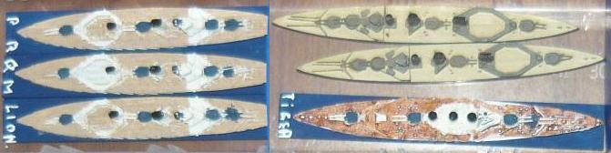

Post by GMG4RWF »
I don't know of larger models but I brought picks of my 2400 scale - Lions & Tiger (the tan & brown I traded for) - sorry, the glare from the White makes the detail hard to see.
HMS Tiger Deck.JPG (22.91 KiB) Viewed 7258 times
