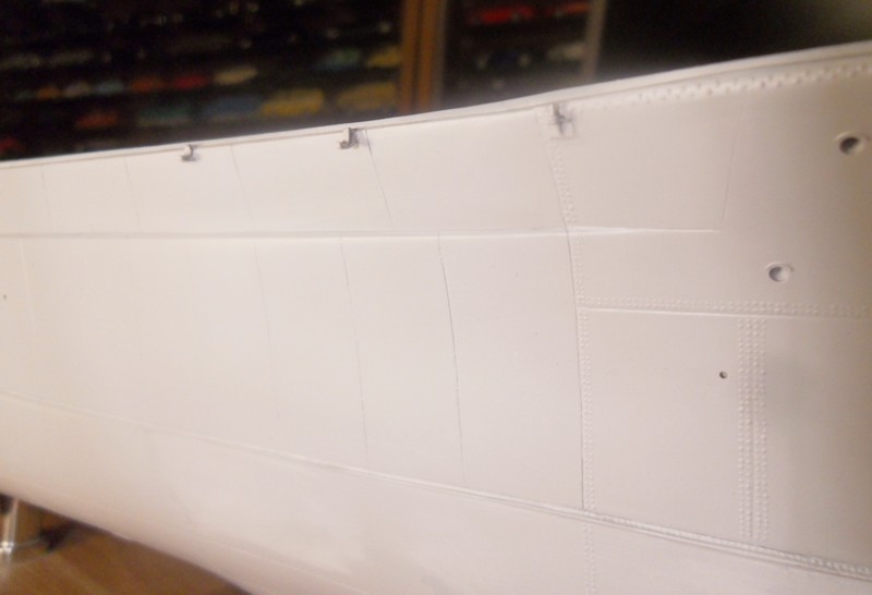

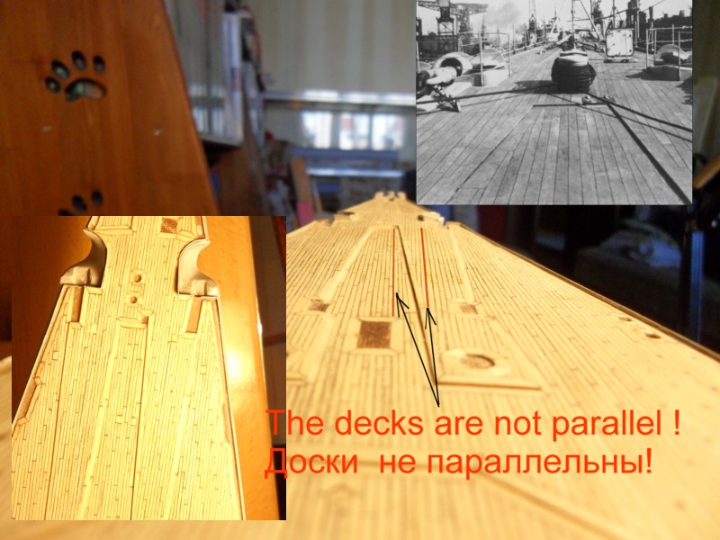

109 wrote:Some of the rivet detail is "wrong" if you allow some constructive comments. Don�t know if you can change things at this stage?
:wave_1:
Hi, Bernd!
Some constructive comments are not allowed but strongly recommended!! :smallsmile:
Of course, I have no detailed drawings about the hull's paneling. My riveting is just my investigation (see also my post from 22.01.2012 in your topic). But if you show me the mistakes, I will try to fix them!
With best regards -
Anatoly.

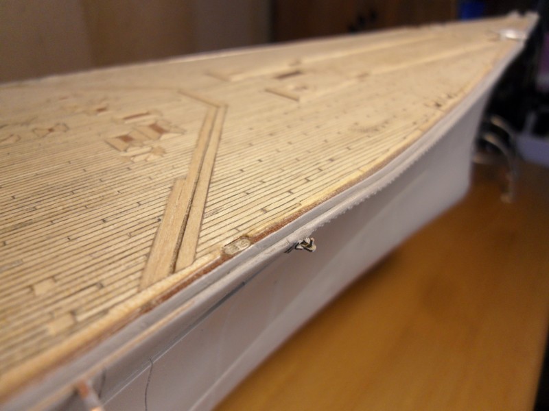

Quite nice! Save enough energy for the myriad of small detail topside. One can take an entire afternoon for a few fire hoses and mount brackets!

You are right, Fliger, it was a helljob with the upperdeck. I think, nobody in the world has the upperdeck of the kind (in scale 1/200). And when I look at the result, I feel good. A proudly good.
It is a bettest reward for the spended time. I wish all shipmodellers to feel so looking at their models-

Bernd, could you, please, draw the correct rewets lines on my pictures above? I am ready for correction of my hull -at last, it was the main aim of my topic here!
With best regards-
Anatoly

I planked the weather decks on my 1:200 Missouri, but not as detailed with the planking borders as you did. As that ship has had a very long life and underwent extreme modification, walking about the decks today there are all sorts of strange areas of planking. The one area that is not is the decking around the aft main turret which has been redone since she went out of commission. My model currently has this area in steel, correct for certain times in her life. I may get ambitious and plank this as I like the look of the individual planking. Yes you should be very proud. And pleasd with this.

Hi, I will post some infos soon :-)

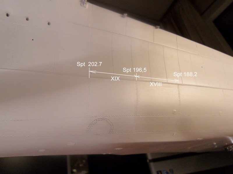

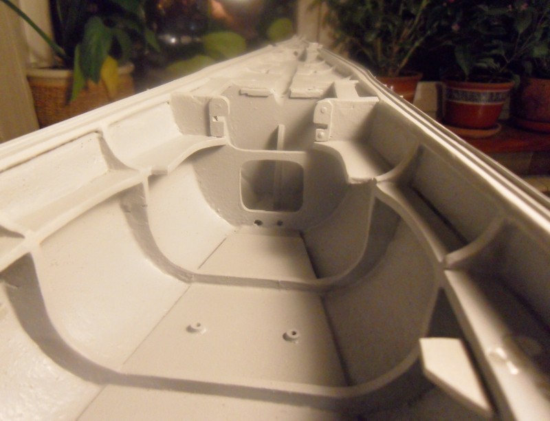

There are sections XVII and XIX for your attention.
With best regards
Anatoly

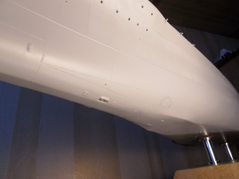

Let me offer for you sections XX and XXI.
With best wishes-
Anatoly

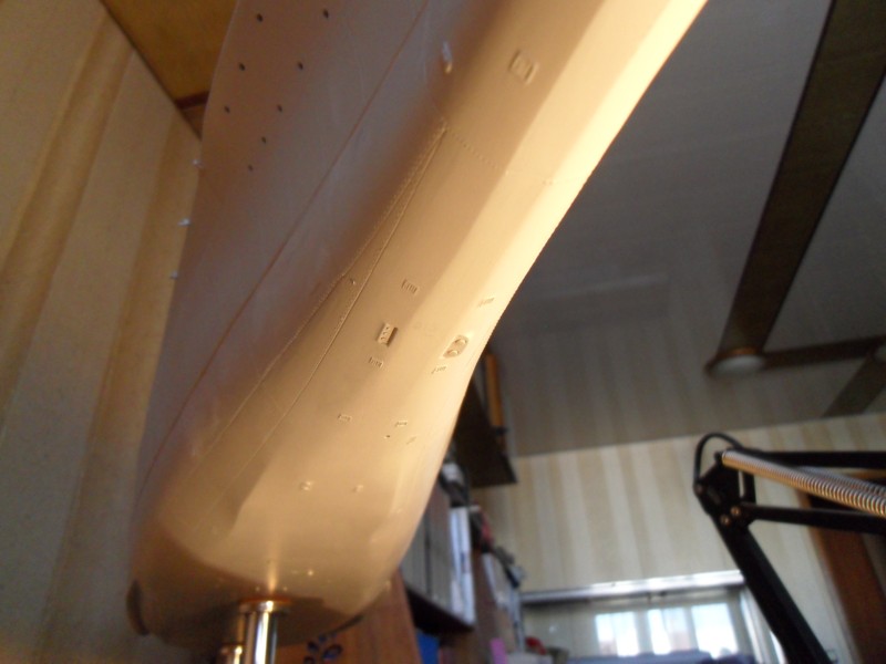

Section XXII - is next and last.
So, friends, it is time to say "good-bye!" for the topic. My thanks -for all who interested and supported me.
The hull will stay in its box and will be waiting the other parts and painting. Rest works with the hull you can find as additional info in... In my next topic, of course!

Hi anatoly,
I posted the Schallanlage in my Bismarck build. Your version is incorrect. Bs and Tp had an other arrangement of the plates. Do you need any measurements?
